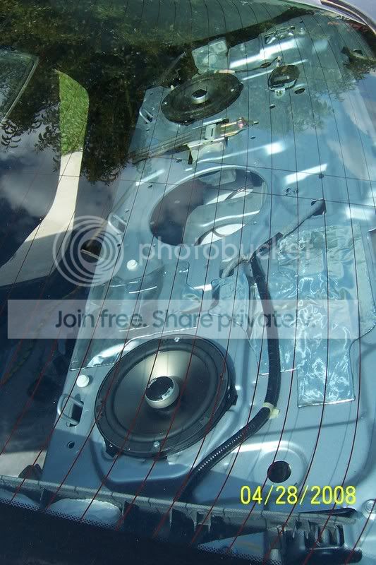

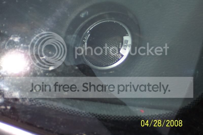

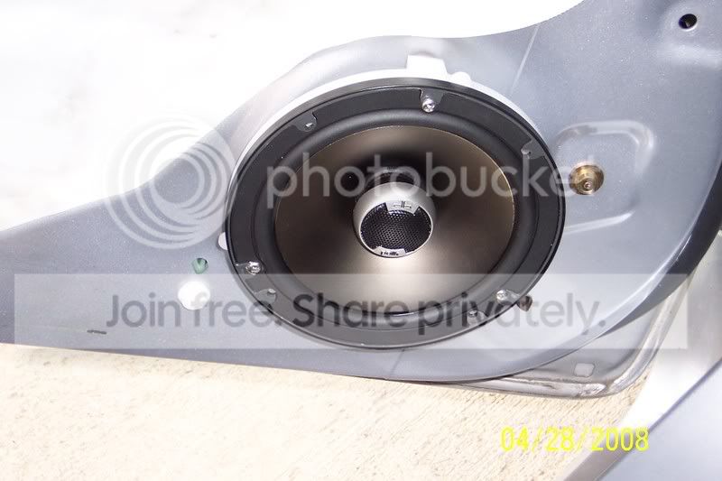

So I decided to go ahead and do my component upgrade and after researching on AZ of course, some spec comparrioson, and recomendations I went with Polks. I replaced all my speakers and removed my dead stock sub to get more sound from my Rockford Fosgate stage 2 12 in the trunk.
To compare to stock I would say The volume is NOT noticably louder but the CLEARITY makes the stock sound like hot garbage. I am running them off the factory amp so I can keep my HFL and whatnot. Now the Polks are 4 ohm as opposed to the stock 2 but the sensitivity is in the high 90s so what they make MUCH better use of the power given plus they can take a beating so they should not blow like factory. now the TWEETERS I had to add a circuit (noise cancelling I ASSUME) to take away a popping noise I had at high voulumes. Which was a little hard to install. (circut was included)
I only had to cut the stock tweeter wires all the others I used a harness adapter that crutchfield threw in. The rear deck I had to use adapter bracets that where included from CF. And the Door speakers I slightly modified the stock speaker "cup" center speaker was straight and easiest. here are some pics.

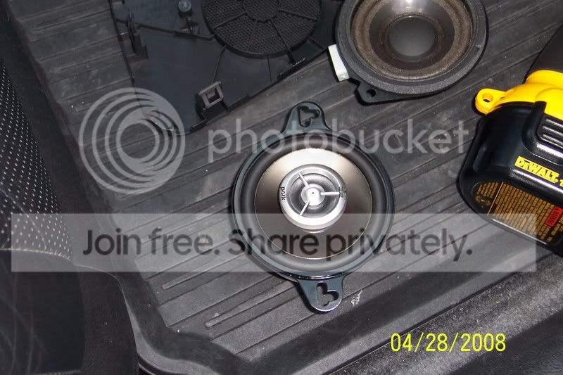

I took the center speaker pic like this since you mount it to the grill
If any one is interested in doing this then I would be willing to sell the extra center speaker
