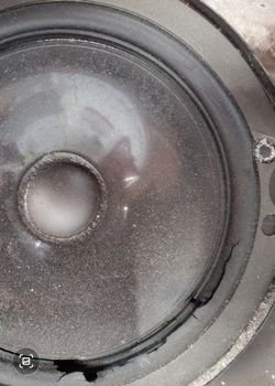

When I hit the SOUND button on the audio screen and change the balance all the way to the left, the only speaker that still works is the front left. Would that be the speaker, the wiring, or my radio? Anyone else ever have this problem?

more than likely the old OEM amp. investigate signal at passenger side footwell

Solved!! It was the original speaker. I guess after 17 years and 342K miles, it had to be dried out. Now I'm wondering about the rear deck speakers, especially with the labor to get to them that's involved.
