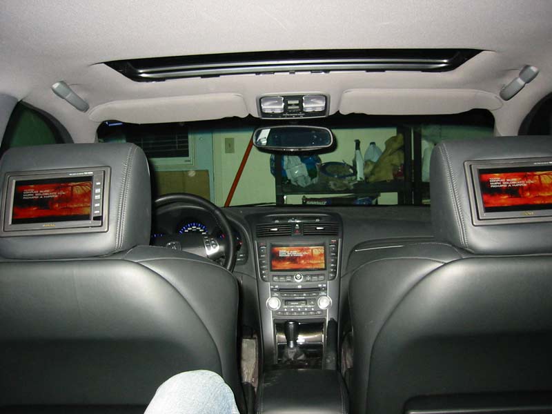

Hey guys,
So, it's taken me a LONG LONG time to do this (being my first time and all), but my project is finally done.
I'm not going to go into details now since my homepage is going to have all the fun details when I'm done. But I will include one pic just to prove to y'all that I'm done.
There it is.
Each screen is independent thanks to a 4-input/4-output AV switcher/multiplexer. The sound is great. Everything comes from a PS2 in the glove compartment.
I've even got pics of cutting open my headrests and fitting in the screens. I did ALL the work myself, so I've gotten quite a bit of experience, I welcome your questions.
Check my webpage for updates. I will try to get on it this week.

Each of the monitors in the car can have an independent feed. Right now I only have two feeds. One from the PS2 and another from an AV AUX port I built into the center armrest. I was thinking of maybe eventually putting a DVD player in the rear armrest to give yet another source or maybe a TV tuner. It would also be neat to somehow convert the Navi to composite video and make that a source too. I don't know if it can be done though.
