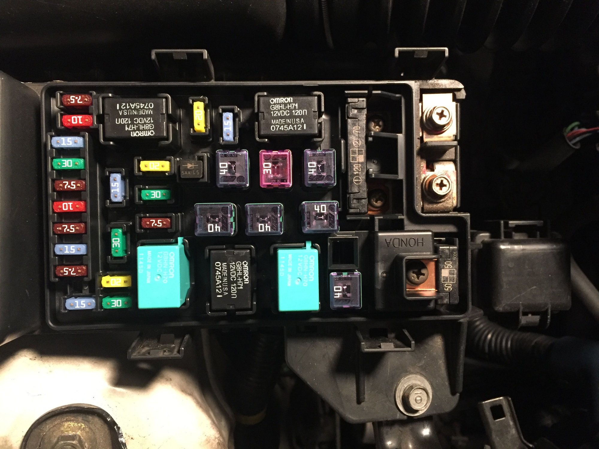

Where exactly on the under hood fuse box. I don't see it.

I have 2005 TL

Another Forum Stated:
There is no interchangeable relays, they are built into fuse box under hood and fuse box needs to be replaced if they fail. What is problem you are having?
