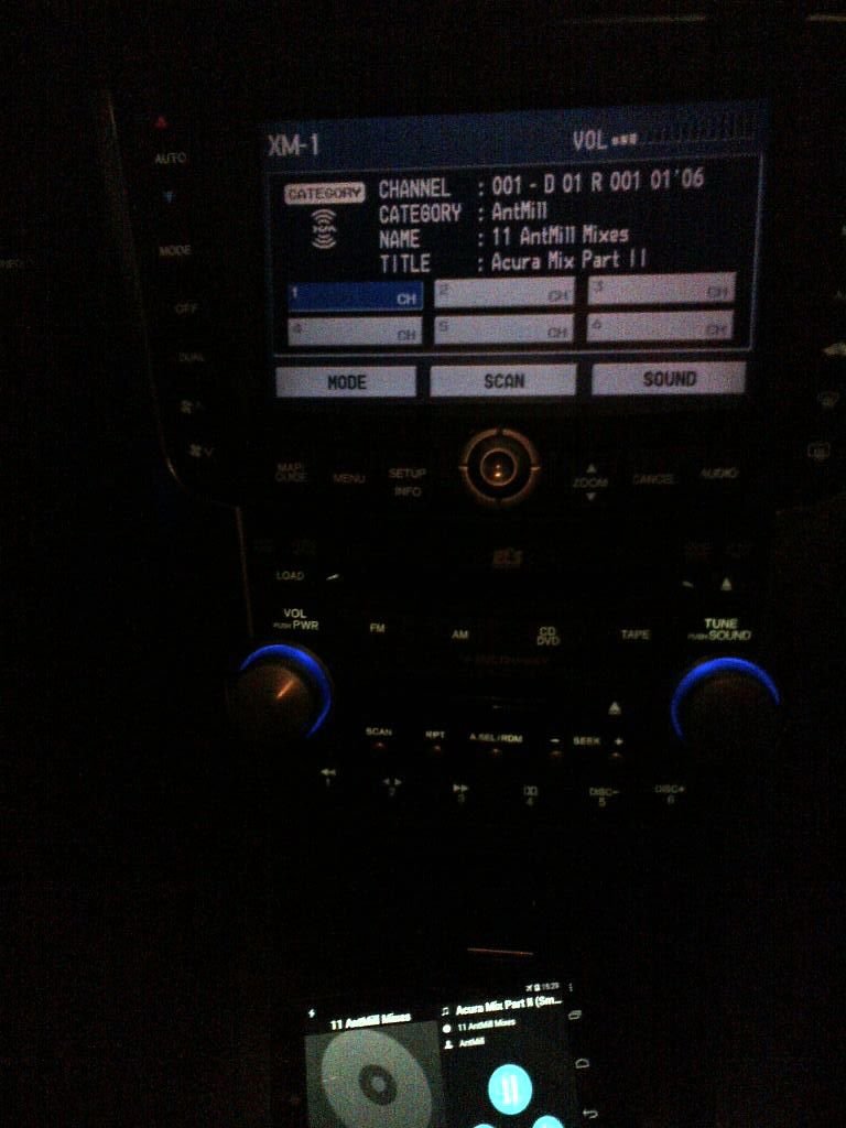

The GROM wire harness plugs into the XM interface on the back of your stereo. The XM cable plugs into the GROM harness. Using firmware 29 for 3g tl you should be able to play whatever Android or USB you have attached to the USB GROM port and have the tracks displayed on the stereo and temp display.
