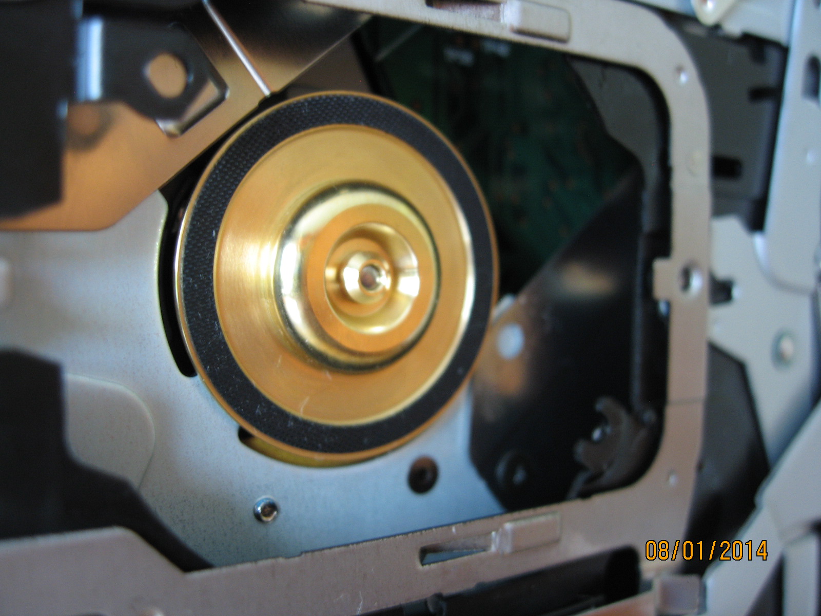

Can't find the laser!
Tried cleaning again, but no go.
So, I decided to remove the small screw on top of the spring loaded mechanism.
I removed the mechanism.....and I cannot even find the laser to clean it!
I have attached pictures.
Can anyone help?
Attached Thumbnails DIY: How to fix Navi disk read errors-img_2798.jpg   DIY: How to fix Navi disk read errors-img_2799.jpg   DIY: How to fix Navi disk read errors-img_2800.jpg   DIY: How to fix Navi disk read errors-img_2801.jpg   DIY: How to fix Navi disk read errors-img_2802.jpg

I found the laser....
And it was not where the OP said his was. It was about another inch or two north-east of where the OP's was.
I took a picture and pointed with my screwdriver. My laser lens was right under my screwdriver and fairly easy to get to to clean. In the 2nd picture, just to the left of the philips head screw underneath.
I wish I would have caught that earlier before I took that screw out and that spring assembly out.....it was a PAIN to get it back into place!
Good news is that I found the laser.
Bad news is that after finally cleaning it, my NAV still does not work.
I guess I am going to give up and just bite the bullet and get a new drive such as the one listed here:
http://opuradio.com/products-detail.php?ProId=335
Attached Thumbnails DIY: How to fix Navi disk read errors-img_2804.jpg   DIY: How to fix Navi disk read errors-img_2807.jpg

I followed the directions to clean the DVD optical lens, except that I didn't bother to disconnect the battery. There was no evidence of any scratching on the disc whatsoever.
I found the lens with some difficulty (it was located in the far right corner like a few posters mentioned, instead of near the center of the unit) and cleaned it, but it looked clean from the beginning and no residue appeared on the q-tip (using 70% isopropyl only).
when I tried to reconnect the back plugs to give it a test (but not reassembling the entire thing to the bracket, etc.), the console now has a new error message. instead of the previous one in which it said "disc reading error, contact dealer) with the other features (e.g. audio) functional, not there is a kind of green screen error that simply says, "check your disc."
I tried to disconnect the reconnect the battery as a reset, but no such luck.
I suspect I'll need the new drive:
http://www.jupoco.com/dv36t02cdv36t0...340-p-147.html
http://www.aliexpress.com/item/DV36T...522433701.html
But is there something I'm missing before I go that route? I don't understand why there's a new error message.
