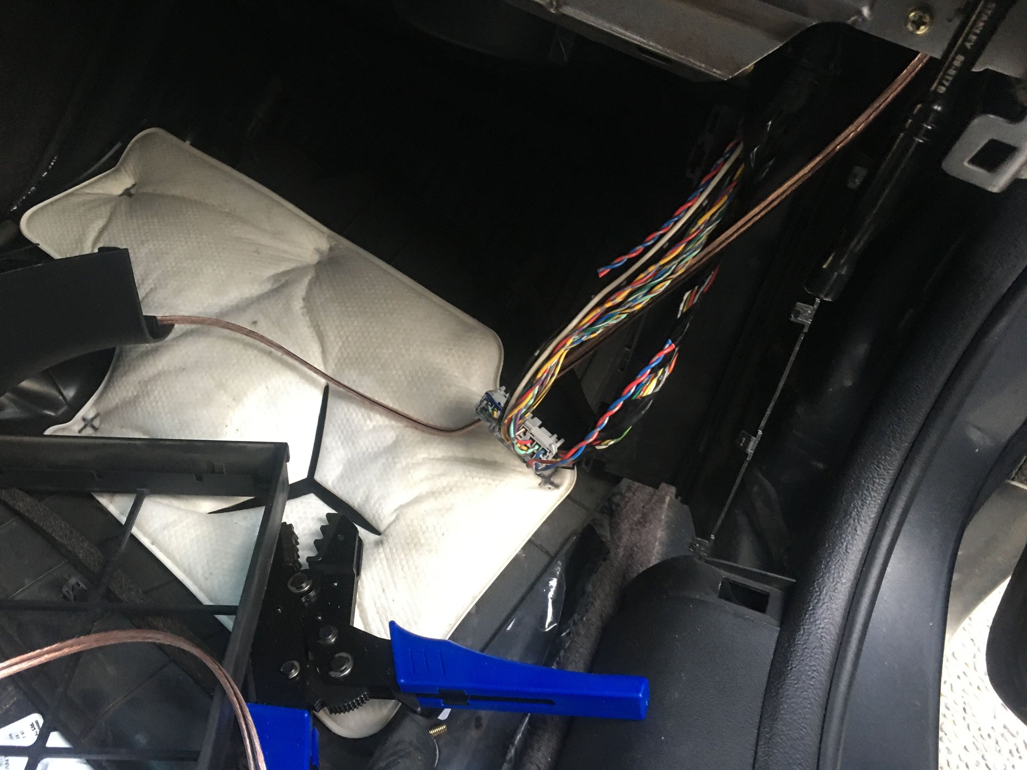

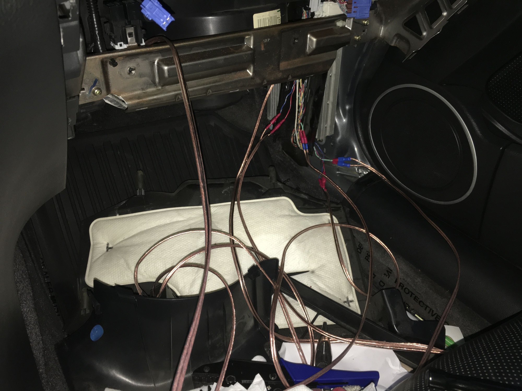

9. Connect the tweeters with aftermarket wires that are long enough to reach from driver's side tweeter location to passenger kick panel.
10. To make things easy, use a straightened metal coat hanger, tape the wire end with the hanger end. For passenger side, it's okay wherever you tape it but for driver's tweeter, I recommend you to tape the wires to the end of the coat hanger rather than front.
11. Push the tweeter wires down with the hanger. You will be able to see the hanger reaching the floor easily
12. For driver's side tweeter, after the wire came down to the floor, don't stop there, find the empty hole space behind the climate and audio headunit. You will find it eventually. Here is a pic. I don't exactly remember which hole was it but you will find one.
Something Like this. The red wire is the tweeter wire going through behind the Audio HU and climate device. The blue wire is passenger side tweeter wire.

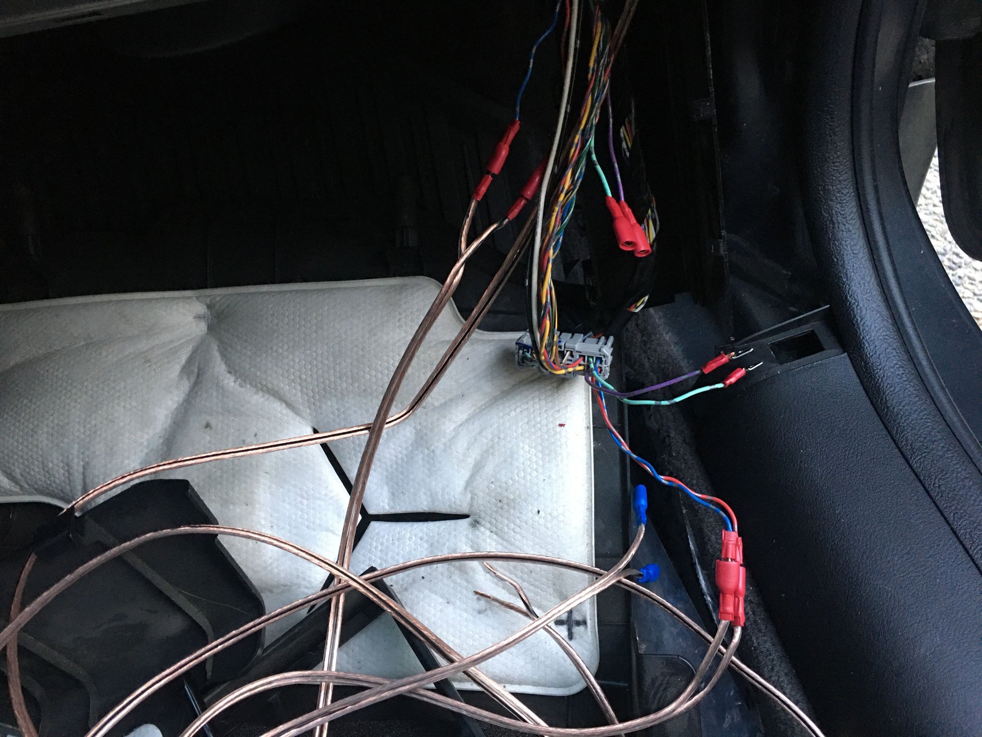

13. Once all the wires are gathered at the kick panel side, unplug your amp(just need to unplug the 14 pin (grey wire-harness) one.
14. From a diagram, #7, #14 are front passenger door speaker and tweeter wires. Red is - and blue is +.
15. #6 and #13 are front driver door speaker and tweeter wires.
16. I cut #7, #14, and #6 and #13. It seems like the audio wires of USA TLs are taped in pairs unlike Canadian version which the wires are just twisted only without tape. (2005 model)

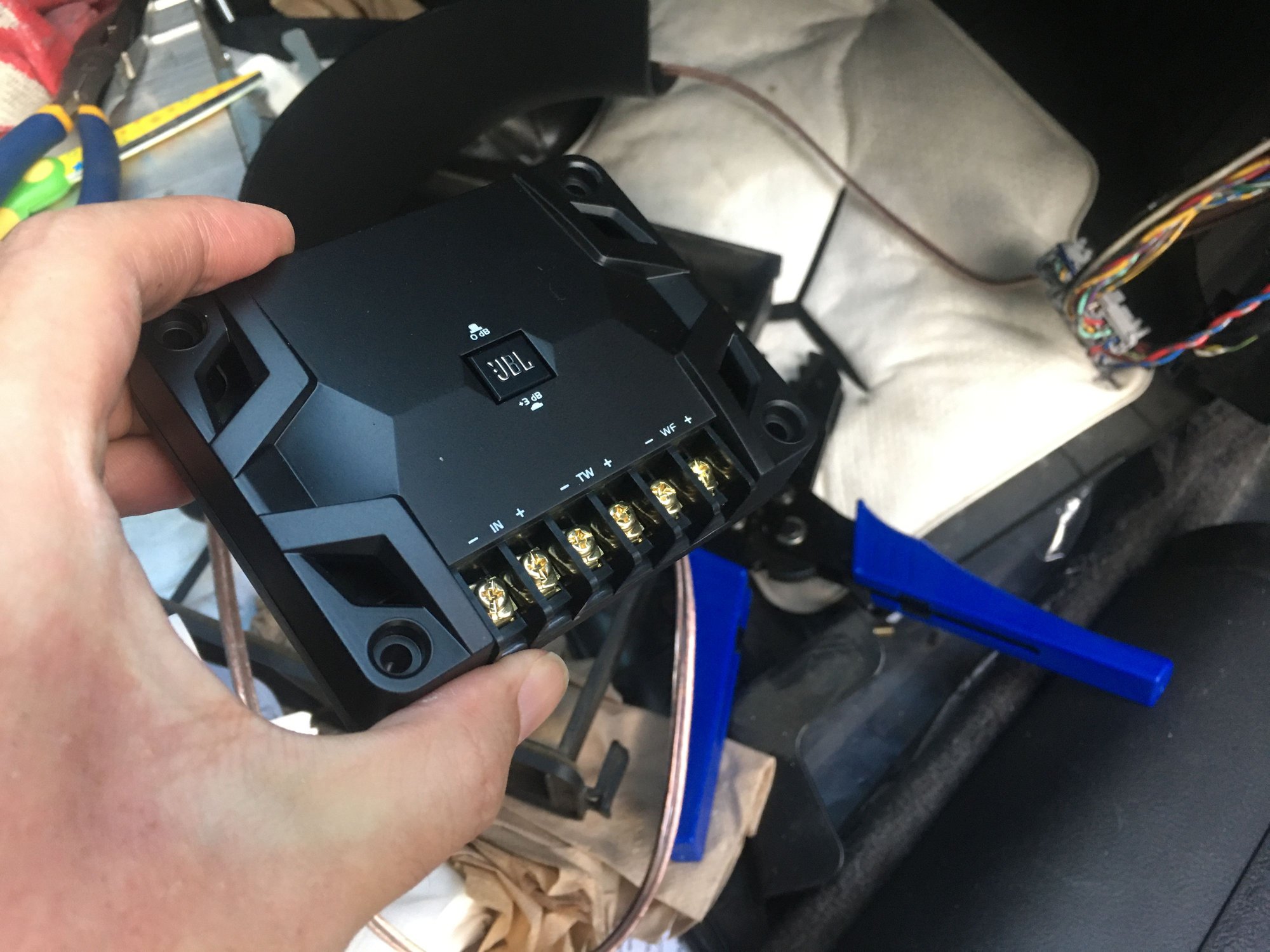

17. After I cut the wires, I connected it with aftermarket wires using wire crimping tools to send power to crossovers, and to send signals to the woofer.
18. Lastly, I connected the tweeter wires to the crossover.

#6, #13, #7, & #14 are cut and modified.

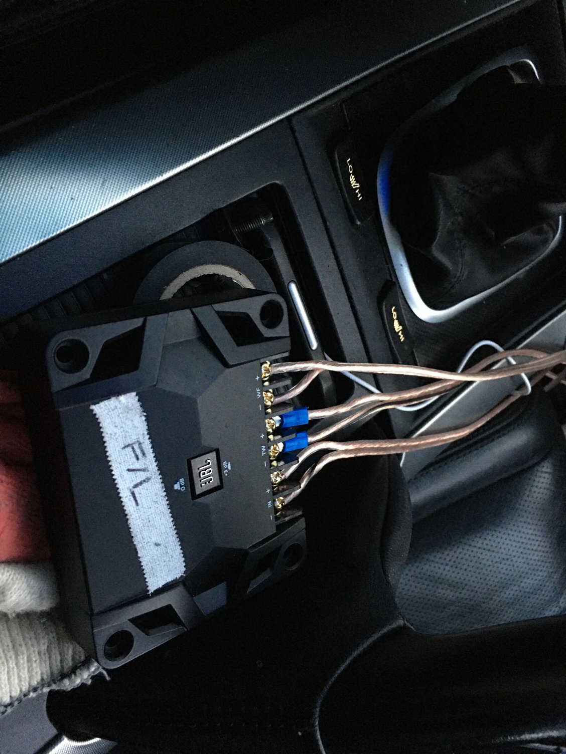

Crossover. Since I'm putting the crossovers together on the same side, to make sure I won't get confused which side is which, I put a name tag on it.
A pic of all the wires connected. The sound is significantly better.
