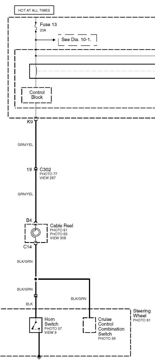

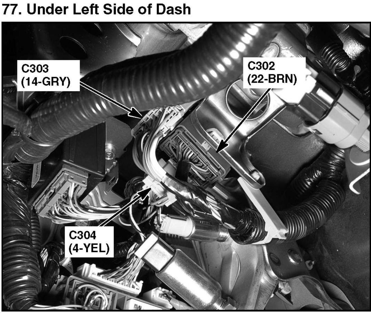

After some testing it seems like factory alarm is completely disabled. When "armed" red door security light will blink normally, but if I pull lock knob on the door and open them, car will just unlock as using remote.
To solve that, connection to the horn wire will need to be made (or you will need to install separate siren). You can get to that wire right behind the steering wheel, but since I put everything back together I used other spot.

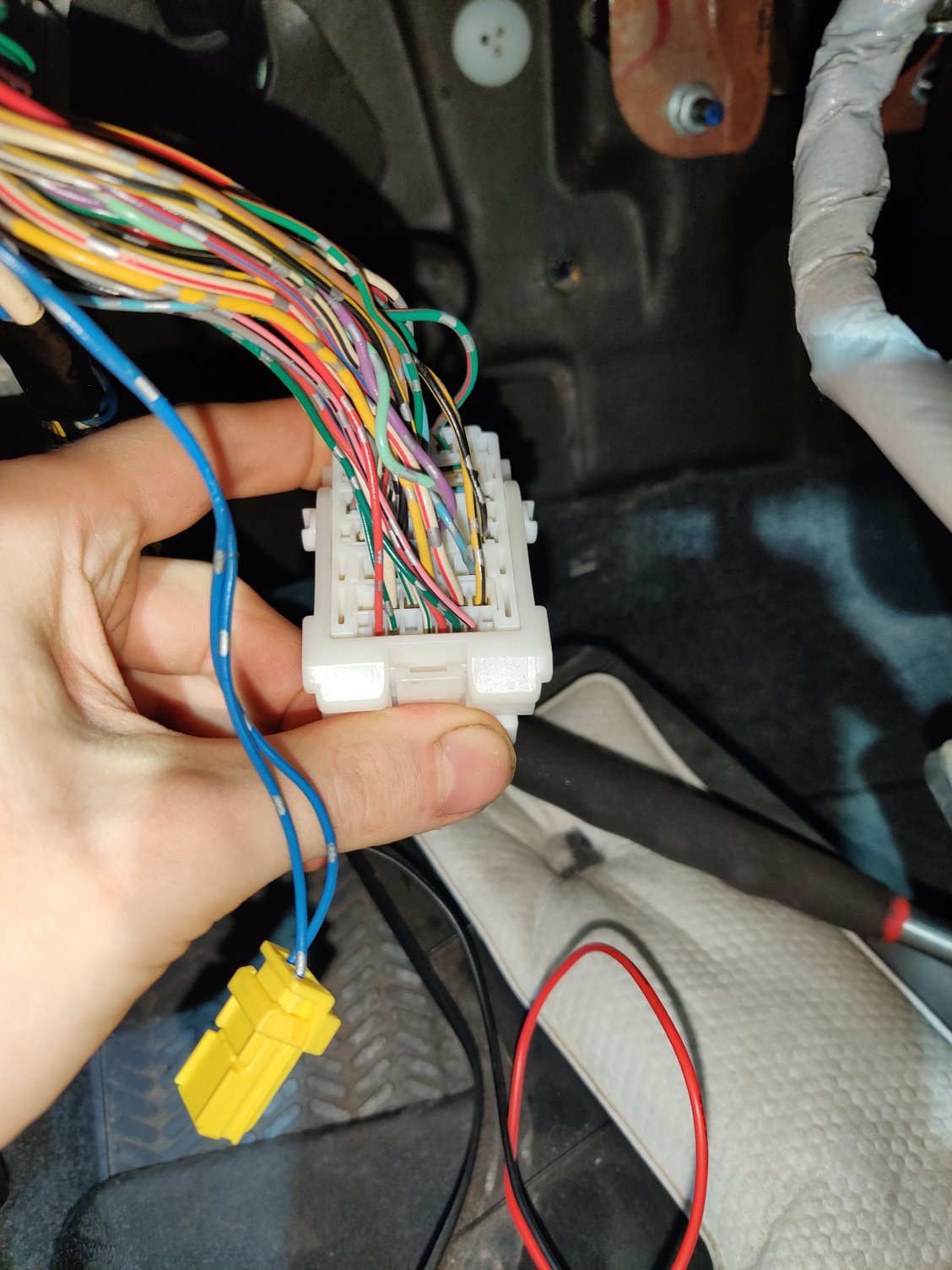

Installed mine sucesfully. Hardest and most time consuming part was wrapping up the cables and grabbing the yellow cable from the OEM keyless module.
You will need the two wires from the M5 connector for OEM remote operation after its remote started as the install manual notes. After you takeover the remote start it does disable the keyless module just like oem so an accidental press doesn't open your trunk while going 75 mph down the highway.
Important note on M5 Connector: When you cut the yellow wire make sure the Grey/Red wire goes on the vehicle/harness side and the Grey/Black wire goes to the keyless module connector side. Other wise it won't ever disable the module even after takeover.
Also kept the alarm option on the DC3 disabled since in primarily using the OEM remote and tested it and the car alarm still functions/honks when triggered.
