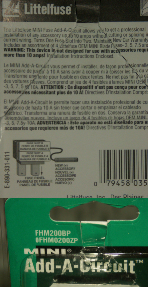

The link Canadian Mike posted shows the unit in action, and here's what the instructions and (opened) box look like:
Cost is about 10 bucks
