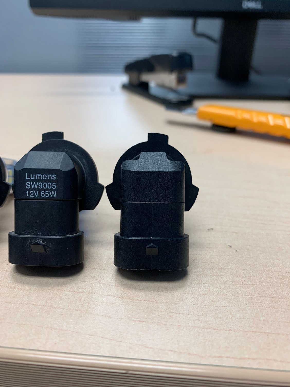

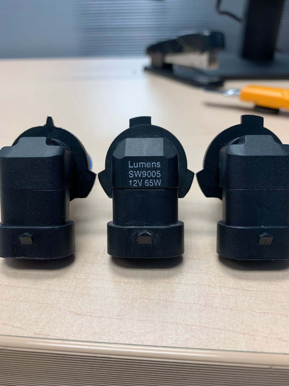

9006 bulb my dad put in, it fits nicely and easily. This one has more material to the left of the centre for the top tab.
1/2 of the ones from Amazon. Notice the top part is sort of inverted. This one has more material on the right of centre.
I sanded the extra material on the right of the other Amazon one. Tried to fit but still same issue and no luck.
Any idea why it’s not fitting? Got another pair from Amazon, same fitment issue from different seller.

Looks like you are buying the wrong size bulbs...

first I’ve seen this conversion thing. All the sources I’ve used for sizing point me toward the 9006, not 9005. But I noticed today the bulb that fits wel is…9005. Is this perhaps a US/Canada difference since the 9006s usually have less output than the 9005 (used for high beams)?
I’ll file down the top piece and see if it fits better

The 9005 bulbs do fit into the housing properly, unlike the 9006. I couldnt get the 9006s to fit even with the top tab fully taken out.
