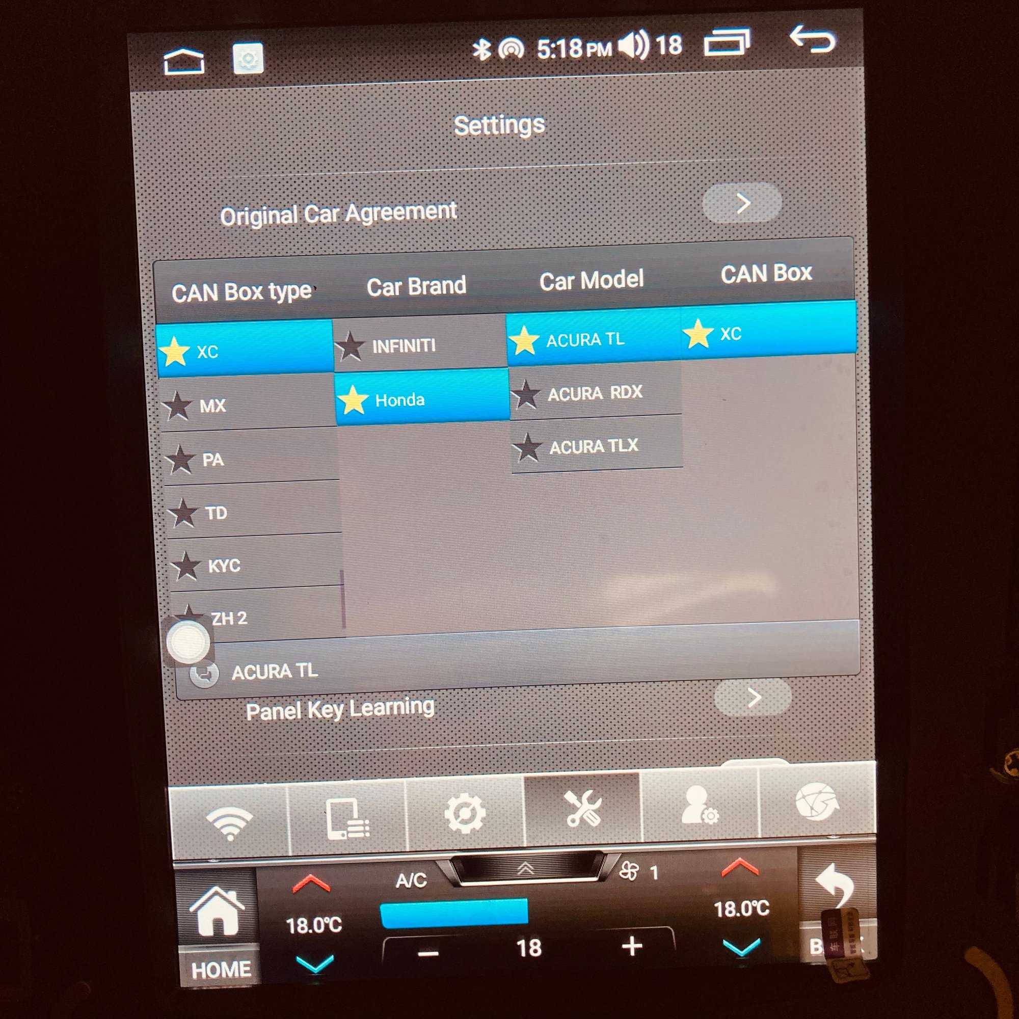

Tesla Radio Climate Control only displays Degrees Centigrade
Has anyone attempted to load firmware update to allow temperature units to display in Degree F rather than Degree C?
Change C to F APK File: https://www.mediafire.com/file/rcd0d...u.air.apk/file
i attempted the file update with no success. I have the latest radio & motherboard. Just bought a 6 G Ram head unit from NaviTech. I’ve reached out to them with no response yet.

Temperature APK Question
Hi OnlyDaanish,
Can you provide steps required to upload the Temperature option for Degrees F display for Tesla style radio. I attempted to upload APK but it wasn’t successful in providing Deg F display change. I put the APK file that you provided on a USB stick and inserted into Tesla radio usb adapter/cable attached to radio. I received a message indicating APK uploaded; however, when I checked radio display it showed Deg C?? I did toggle from Deg C to Deg F after APK upload but didn’t work.

Follup to my question about Tesla Radio APK Update file for Temp Deg F
I paid more attention to radio head unit message after attempting to load Deg C to Deg F - APK file. Message indicated file was not successfully loaded!? I checked my settings that allow 3rd party updates and it was selected. So not sure why APK file didn’t load. Is this the latest APK file to make switch to Deg F display for AC controls?
Still no word from NaviTech. I’m considering returning the head unit. After sales support is not helping me with this problem and steering wheel control buttons not working.

Temperature change setting work?
Originally Posted by mariusz439
Doesn't the setting in the last line work?
No. It does not work. When you change setting from Deg C to Deg F in settings and then perform a reset as requested by NaviTech, the display continues to show Deg C. In the picture that you provided, it seems your setting is on Deg F yet display is not Deg F?

Forgot to restart Just restarted and it works

CAN bus type
I have been trying to set up the steering wheel buttons but no luck, I noticed that there are many CAN bus type on the list for Hondas. Does any one know which one works with 04 to 06 TL.
Thanks
Old 03-23-2023, 11:27 PM
  #159
BryanC's Avatar
Join Date: Feb 2023
Age: 64
Posts: 17
Received 2 Likes on 2 Posts
Correct car model selection for CANBUS
Thanks
NaviTech confirmed that this car model should be used for CANBUS. After you select this car model, go to the “Control” app in the radio to make SWC button assignments to the radio.
