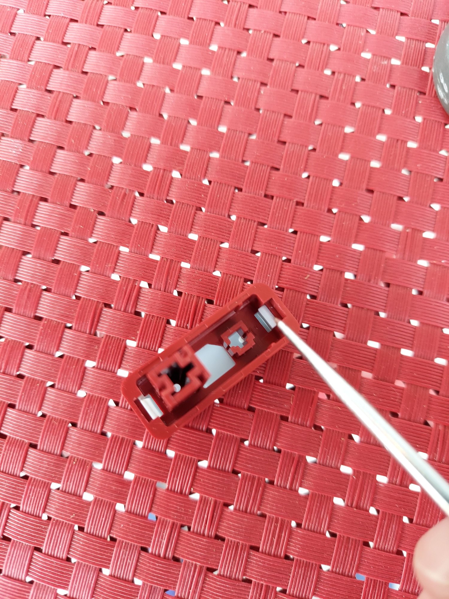

Old Aug 20, 2021 | 09:02 PM
Frivolous's Avatar
Joined: Jan 2019
Originally Posted by Kelly Martis
Anyone have steps on how to replace ?! Just happened to my 04' tl.
Get one of these tools from Harbor Freight
Separate the new button from the new button cover
Place new cover on Old button
Done
