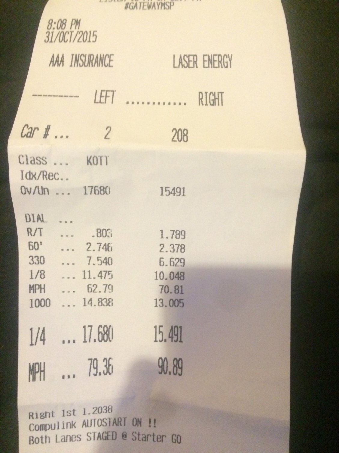

Originally Posted by Jackass
1.) Drop weight
2.) Better tires
3.) Post actual time slips so we can see how your launch is
This was on Yokohama avid envigor tires with a 1/4 tank of gas, manual mode with no traction control

You lost over a second on the R/T. Consistent R/T is key to good times. You leave a second earlier, you arrive a second earlier.
Nah. R/T is never calculated into the final 1/4mi time. You can sit there for 15seconds. R/T only comes in when he does competitive amatuer drag races.
You are 101% right. The compulink calculated after he crossed the line obviously.
yeah I used to think that too long time ago and then I was watching youtube vids and you see guys, either heavily modded cars or lightly modded ones...just sitting at a green light and getting their RPMs/etc. just right and then launching like 2-3 seconds at the green light...then I figure it must be a diff time than the final 1/4 mile which makes more sense.

The OPs car is WAY down on power. What was the temp and elevation? If this is in Colorado at 4000 ft, then its understandable, but around sea level, its terrible.

VSA was enabled or he spun the tires? That's also possible.
If VSA was enabled, it should still recover once traction is gained. If it was disabled and he spun, it would still trap higher once it gained traction.
Based on 1/8 trap and 1/4 trap, the car is down on power by at least 30 - 40 hp, or carrying 3 extra people.
No. Trust me on that one. I've tried running with VSA on. It cuts power heavily in first and second, killing forward momentum. It'll knock off a couple mph every time.
