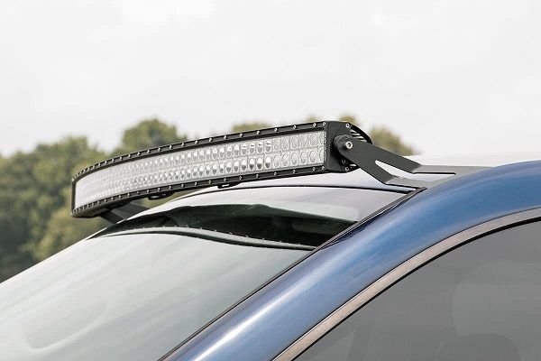

I may be new to this forum, but I've been messing with/building Honda's for over 15 years now. I have a serious question, I am wondering if anyone here has, or has seen anyone put an LED light bar either in the grille or roof of a TL? My wife drives an '07 Type S, and she has issues seeing at night. We live about 10 miles out of town, so at night there are a lot of dark country roads to get to our house, and with it getting darker earlier, it's getting harder for her to see. With all these LED light bars coming out and getting cheaper, was debating on seeing about adding some more light to the car. It's the Type S, so it already has the HID's, but wanted more light. They make a lot of kits for pickups to roof mount these light bars, and I've even seen them on VWs, Subaru's, and other cars. Was wanting to see if anyone has done this to a TL? If not roof mount (which would probably give the most light), I could probably fit one behind the grille, that way it's a little more inconspicuous. I would throw a relay in and wiring it to come on with the high beams, that way I'm not blinding oncoming cars and adding in extra switches. I tried Googling it, but couldn't find much for our cars. I'm not looking for one of these to look "cool" or "redneck", it's for actual functionality. I realize they don't make a "kit" for our cars, but before I started getting too deep into it, wanted to see if anyone has done something similar? Below is an idea of something similar I was looking for...

I don't think I've seen a forward facing one.
I have seen someone on the FB group put it on the rear deck to blind tail gators, though
I'm sure you can find one like the picture you posted and wire it up easy no problem.

my buddies car. he took a universal light bar (measured and bought one that fit width of roof) and wired it up

Mounting it to a $300+ roof rack is too ez
I'm actually hoping to see one mounted like the pic OP posted
Old Dec 5, 2017 | 12:31 PM
I like the mount in the OP's picture.

Mounting one to a roof rack is a good idea, but I don't think I want to add a rack to the car.
I may start looking into this a little more and get more info on how the different roof mounts actually mount to the vehicle and see if I can find something that would work with the TL roof gutters. Then take some measurements and see if I can't piece something together...?

pretty cool on roof rack, how do you run wiring though

A good many of the truck brackets that mount the light at roof level, ahead of the windshield, are installed by drilling and add rivnuts to the A-Pillar area, right at the top of the door opening. The bracket then comes out and sort of wraps around to the front of the window.
There's nothing radical about how it's done. You should be able to do something similar with your car. Find a LED bar that is smaller than the car is wide and then have some brackets made up. You can find the rivnuts on Amazon. Run wiring from the light bar down through the weather strip inside the door A-Pillar, or down underneath the rubber seal next to the windshield, and into the engine bay. Install your relay box there. And complete your wiring.
You can find some decent weatherproof relay holders on Amazon. Expect about $75-100 for all the relay, fuse, holders, etc if you want to do it thoroughly. Less if you cut corners.
OPT7 makes a decent, affordable, LED bar that's throws as much light as the big names but for a fraction of the price.
