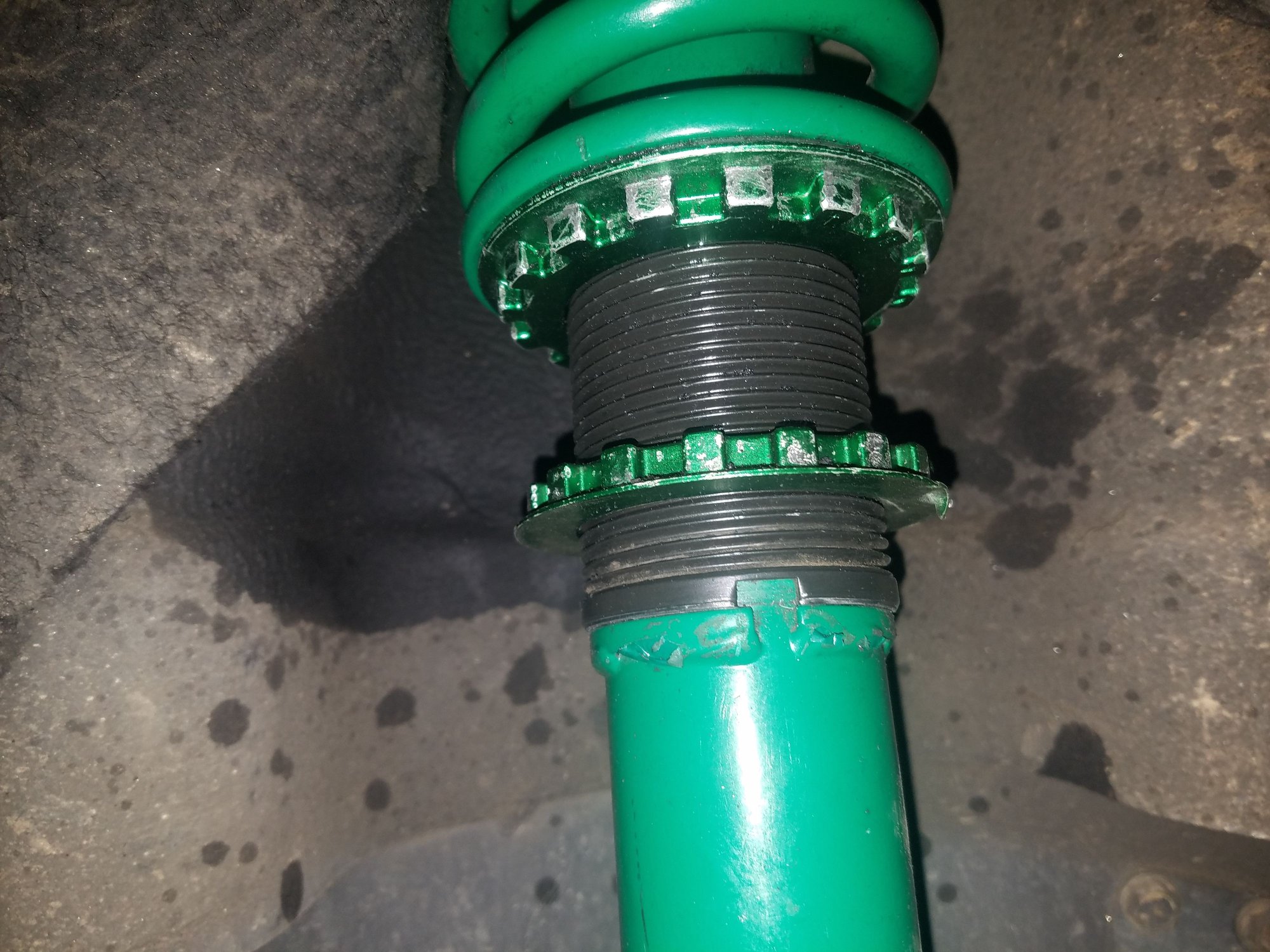

I am an extreme beginner when it comes to cars but decided to give it a shot to adjust my coilovers and they seem pretty straight forward.
I was successful in lowering my rear left ride height but when I got to my rear right I had an issue. I was able to lower the bottom collar but when I tried to lower the upper collar by spinning it left, the black thread piece moves with it and spent a good hour of turning it hoping it would break free but no success. I've used some spray to help it but no. Could it be I just have a bad set of coilovers or do I just suck at working on cars? I understand the black notch and green notch should align but when I adjust the upper collar the black notch moves with my collar. Is it a MUST these must align? Again I am like ditsy blonde girl dumb when it comes to working on cars.

Its not possible that the black collar is turning. Its physically locked in the correct spot here.
Is that whole thing damaged? or?
In the photo yes it is in the correct spot but when turning the top collar, the black part would move with it causing "misalignment." The front coilovers has interlocking pieces from green to black parts but the rears did not. Still not sure if they need to stay aligned or the danger it would bring if they were not aligned.

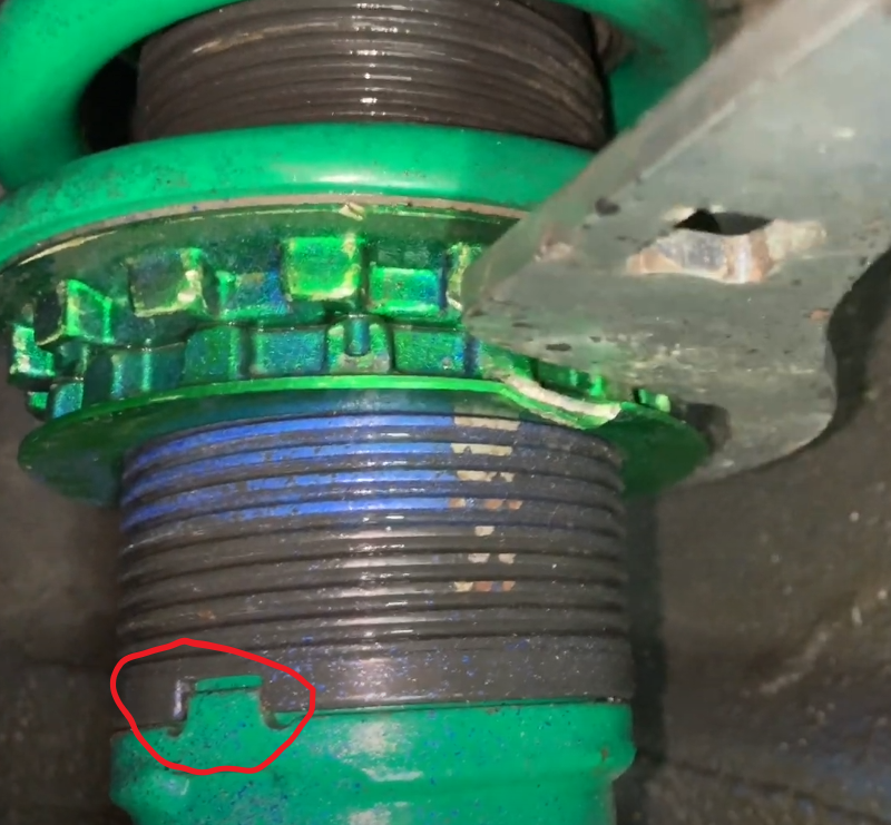

Old Mar 24, 2021 | 07:46 PM
guitarplayer16's Avatar
Joined: Mar 2010
Posts: 10,766
Likes: 2,317
From: ON, Canada
This is what it should look like.
You can see the threaded sleeve falls in place with the green protrusion to stop it from spinning. Maybe the notch is missing or it's on the other side.
Since you took a picture straight on with "notch", it's hard to tell but to me it looks like it's not there.

Old Mar 24, 2021 | 07:51 PM
BROlando's Avatar
Joined: Feb 2015
Posts: 3,871
Likes: 1,215
Its there. If it was opposite, it wouldn't sit all the way down.
Her collar looks flared out.
Like someone installed it without lining it up. Car's weight pushed it down and spread it out
Old Mar 24, 2021 | 08:08 PM
Apples's Avatar
Joined: Oct 2016
Posts: 11
The picture you posted is exactly how both my front coilovers look however both rears don't have the interlocking piece. Makes me believe that's how they were manufactured but I have no idea.
I looked at google pictures of my model number and found no rear coilovers that had the missing "interlocking notch" on the rears.
