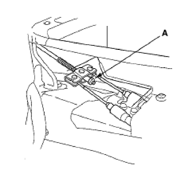

I just adjusted mine recently... definitely no need to disassemble the console. Just remove the rubber mat and then pop out the plastic cover in the bottom of the center console. You'll need a ratchet and socket to tighten the nut. IIRC, the service manual says to pull the lever up one click, which I think helps give you a better angle for adjusting it. And I think someone mentioned that it should be adjusted so it keeps the car from moving somewhere around 10 clicks.
In my case, I was able to adjust it to barely hold when all the way up, so I ended up needing to adjust the parking brake drums. That's not hard either... just requires lifting the back of the car, removing the wheels, popping the rubber window cover off the rotor, turning the rotor to find the star screw through the tiny window (it's at the bottom), then using a flat head screwdriver to turn it. That's similar to the parking brake adjustment that I've done on most cars.
Here's an image from the service manual showing the x-ray view of the adjustment in the console (you can't actually see the nut through the bottom of the console).

OP, what is the issue? Per the service manual, the PB should hold when you raise the lever 6-10 clicks. If it takes 1-2 extra clicks for it to hold, them the SM says to use the minor adjustment procedure. If it takes more than 1-2 clicks, then the SM says to use the major adjustment procedure instead.
