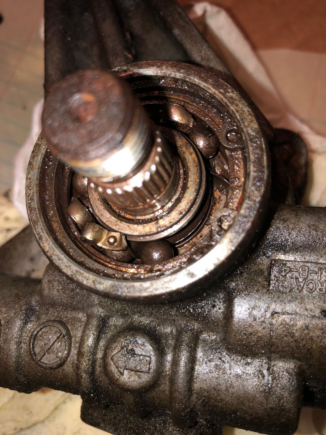

Old Feb 26, 2023 | 09:37 PM
WSH's Avatar
WSH
Joined: Apr 2018
Posts: 22
Likes: 6
From: Chicago
Thank You!
BTW: this is steering pump after replacing.
Old Feb 27, 2023 | 12:52 PM
twokexlv6coupe's Avatar
Joined: Jul 2017
Posts: 523
Likes: 158
Yip. Safe to say, that PS pump (bearing) is fukkkkkedddddd
