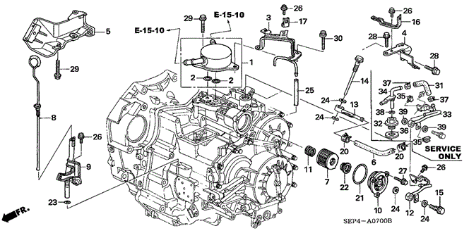

Forgot I had this picture. See below!
I have the filter and hardware to do the change. I bought it for mine but never got to it before my trans detonated. Let me know if you would like to pick it off me. I can ship it out tomorrow.
(Below are the parts I will sell for $20 + Shipping)
Nice man! Let me get back to you in a pm soon!
