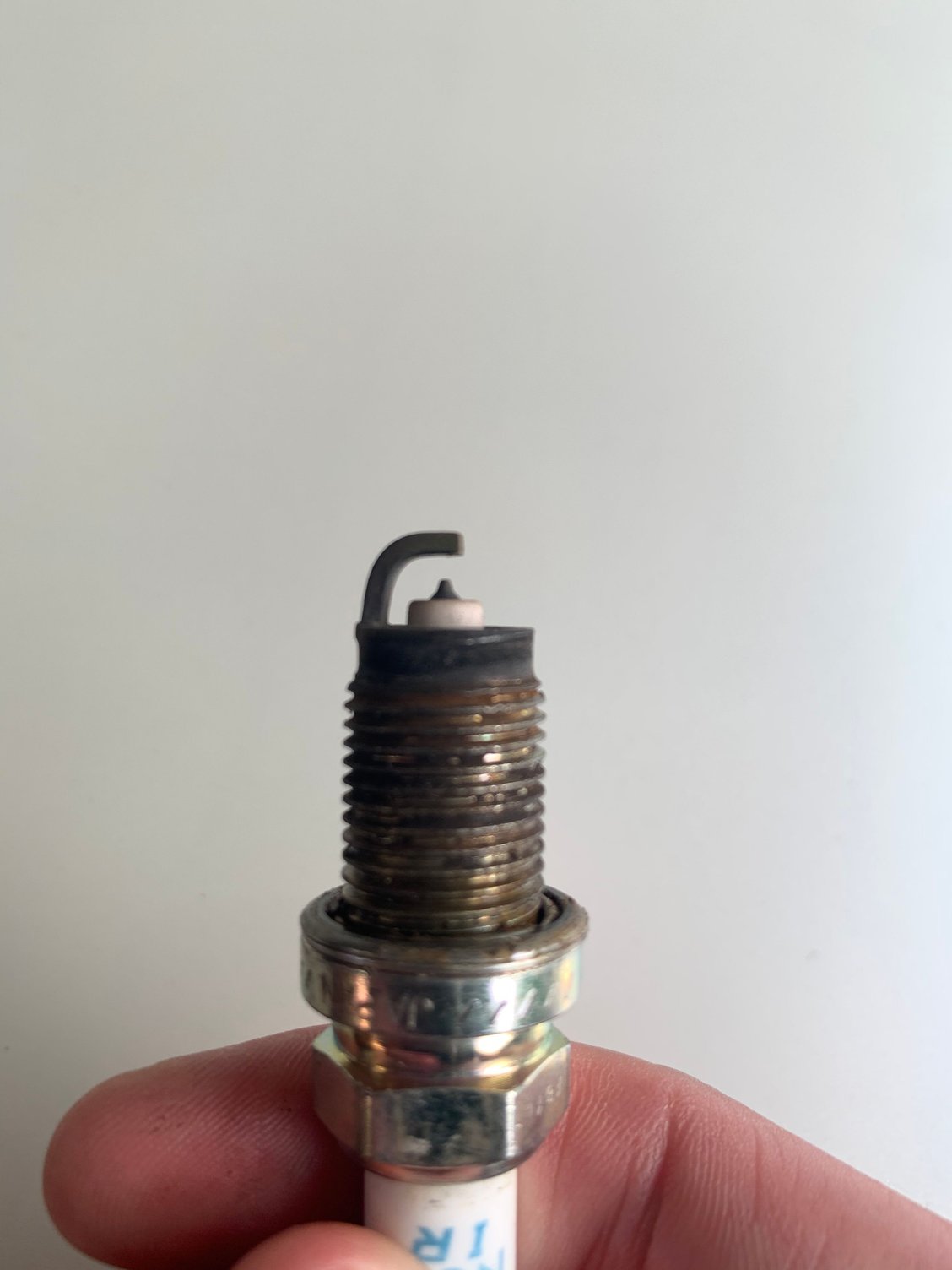

Didn't get to change them yet cause store closed but just checked gap on one and it's set to 63 so that's way too big. I had them installed by a mechanic with my timing belt and water pump 20m miles ago so didn't check the gap before.

Is the plug supposed to be pointy like that? All Theo there I've seen have been flat. I'm picking u ones plugs tomorow so no use in regapping those for now

yeah, i googled ngk iridium's and they are pointy.
Just learned something new...the pointy part is the iridium center.

Yeah, they're supposed to be like that.
