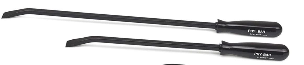

When I replaced the rear mount on my CL-S6, many moons ago, I had the same problem.
Short answer is, I tamed the situation with a large pry bar by experimenting with various 'leverage points' on the chassis / engine to muscle that PIA into compliance. Just be careful not to damage something else near the leverage point, in the process, if you possibly slip.
Once you get one of the mount to subframe bolts in place and threaded properly, you may have to 'reposition' said pry bar to get a second bolt threaded / started. After that the other two should be in alignment, though with aftermarket mounts (mine was OEM because no one makes a rear mount for the CL-S6 ), you may still have a struggle?
Good Luck!
