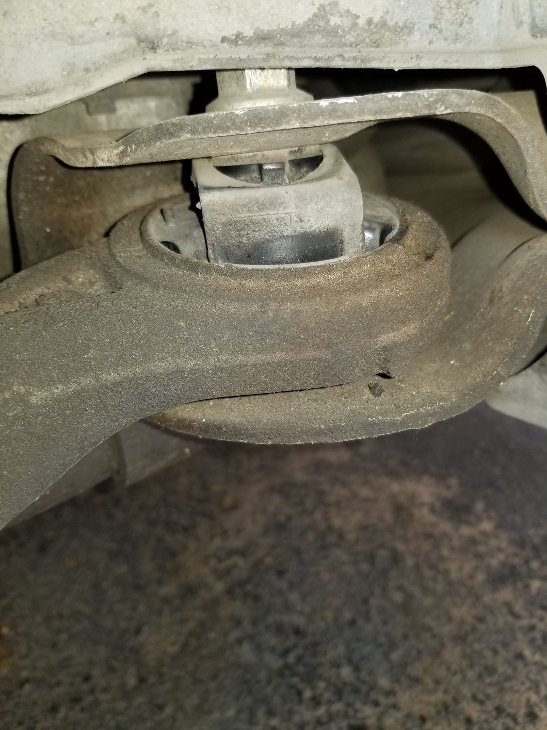

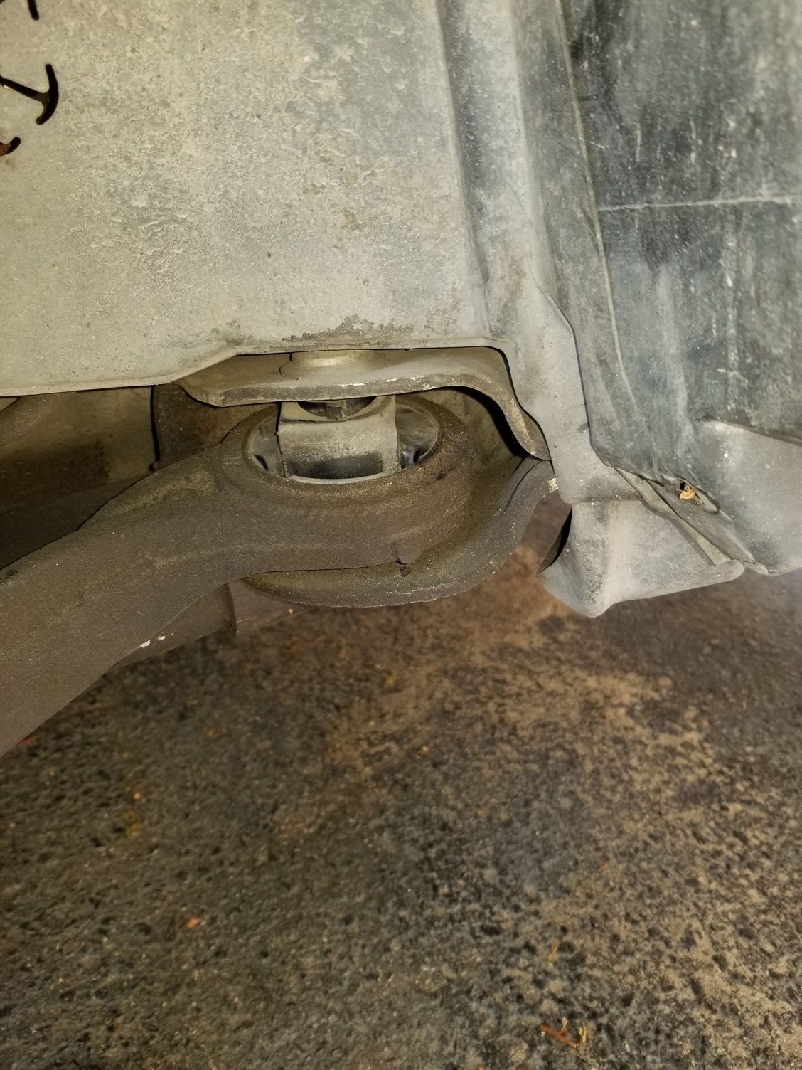

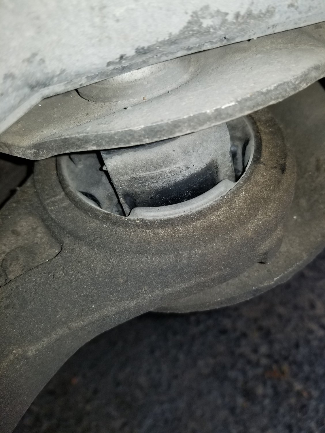

Hi all ,
Was inspecting my front suspension and found my lca bushing looking like this.
Can anyone familiar with those help me figure out if this bushing's totally gone or just starting to go?
Feels like the lca is still sitting where it belongs and the bushing doesn't look separated. Any input?

its cracked and ready for replacement.

I would agree that these are in need of replacement.

Thanks guys, appreciate the input.
Just to be clear, I should be good driving like this for a couple days right? The bushings not separated and the arm isnt hitting the subframe like I've seen in extreme cases. Just wanna make sure since I'll probably have to order the parts.
Thanks again
Old May 27, 2020 | 06:22 PM
BROlando's Avatar
Joined: Feb 2015
Posts: 3,871
Likes: 1,215
Yeah, you'll be fine until its replaced. You've been driving on it this whole time, after all.

yeah it will be fine, I seen worst than that.

Unless y'all are determining that it's cracked from the angle of the arm, I don't see anything to indicate that here. The part that is extended out of the LCA bushing is a tongue put between a gap on the bushing to prevent it from overstretching and cracking. If you wiggle it you'll notice its not actually attached to anything, just a 90* bend of rubber with a circle cut out of the top to secure it around the metal center bore of the LCA bushing.
You'll need to take a look from the top down/bottom up to determine if it's cracked. Coming from Accords I saw the same on my TL and replaced them. Upon removal I noticed there's zero cracking on the bushing itself and the tongue is what I diagnosed as the center bore lifting out as the accord does not have this attachment.
Upon closer inspection of your pictures I actually see signs that the bushing is fine and intact. The bushing itself within the diameter is not bent even with the arm at full torsion lifted off the ground. If it were torn the sides of the disc would be angled toward the outside of the car while the arm is depressed, not flat across the top. I'd take a better look from the sides of that insert tongue (front and back of the car) to see if there's any cracking around the center metal bore. There's no tears at the outside diameter to be seen which is where these usually tear.

These are not the worst cracks posters have reported, but there are small cracks in the bushings (see cracks between red lines in picture attached).
My bushings have similar cracks and I'm planning on replacing them before the summer ends. Last time, I waited too long and ruined two newish front tires when the alignment got bad.
The thread below has many more pictures (most worse).

You don't need to replace those, unless you are anal and think those tiny edge cracks are causing problems. Mine look just like that.
That bushing determines the caster. Alignments should be done every year anyway to compensate for gradual suspension wears, or tires will wear out.

Thanks for all the good info guys.
The tears identified in red above are indeed what I thought was sign of failure.
OEM parts are stupid expensive here in Canada sometimes, bushings alone were 93$ per side just for that single one. Complete arms are even worse.
I went ahead and ordered new Mevotech arms. I know aftermarket arms aren't everyone's preferred option on here but at 100$ per side (Moog was 185$). I'll be keeping my original arms in case I'm tempted to replace the bushings and reuse those if the aftermarket arms end up being bad. The Mevotechs have a lifetime warranty and the company is somewhat local to me so I figured I'll give them a shot, reviews online were good for the most part.
Thanks again for your input, much appreciated.

Mevotech makes good parts, the tiny rips you circled are early signs of failure however there's so little material gone the difference will likely be from the rubber being fresher/stiffer than not having tears. It's an early replace for sure, but if you're in the better safe than sorry mentality it is still a proactive replacement after early failure signs. You could get some 80A urethane off McMaster-Carr and add it to those old bushings to make a backup set that should be a bit stiffer than the new Mevotech ones.

It is indeed somewhat of an early replacement but at 14 years old I'm guessing most rubber parts on the car could be refreshed. I'll keep my old arms as back ups if the mevotech ones end up being bad. Might get them powdercoated and new bushings pressed in if it comes to that.
