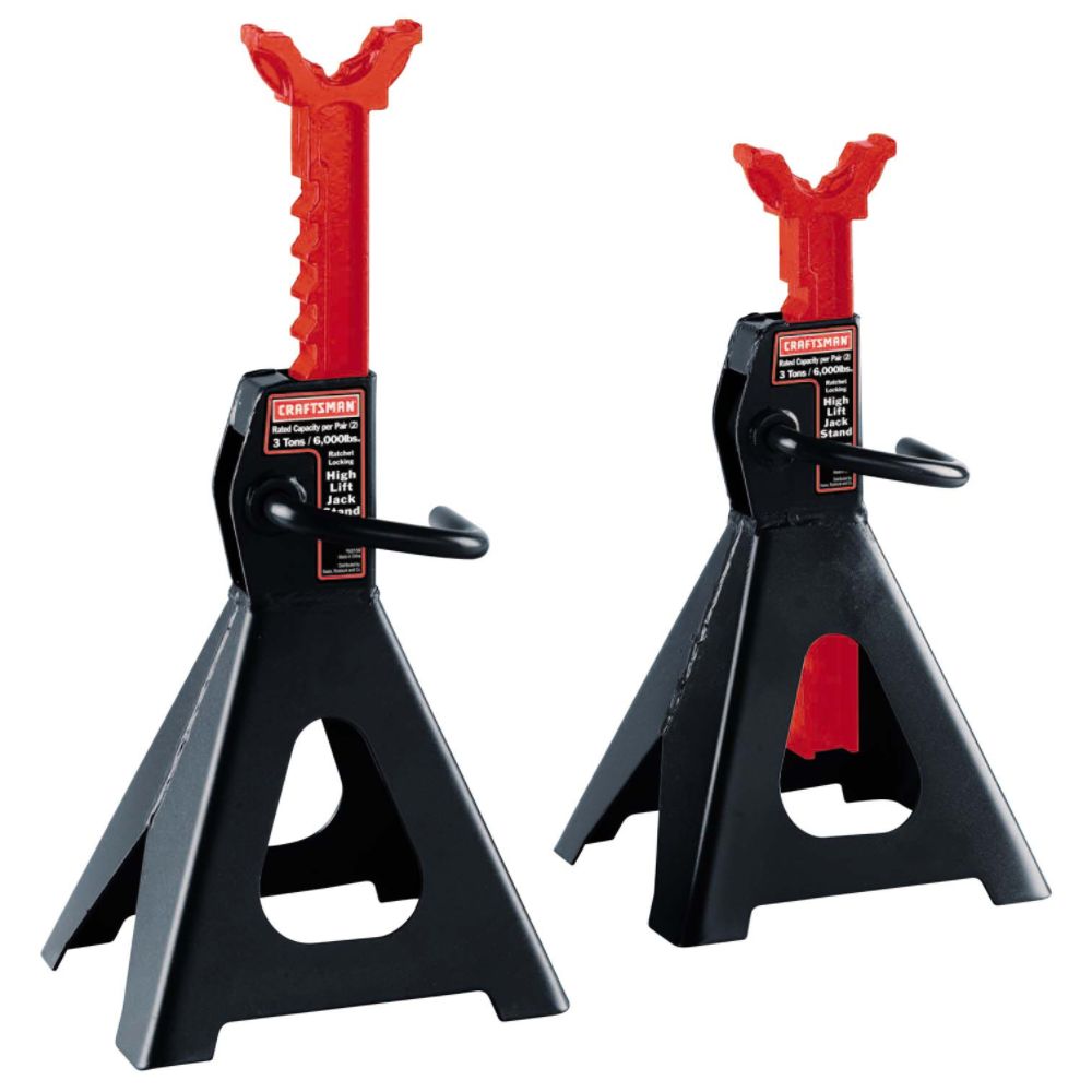

I have this one, and HIGHLY recommend it.
Craftsman 4000 lb. Capacity Aluminum Jack
Sears item #00950239000 Mfr. model #G620S
And YOU MUST HAVE STANDS (or a good death insurance)
Craftsman 3 ton High Lift Jack Stands
Sears item #00950159000 Mfr. model #50159

My Craftsman jack (model #G620S) will raise the front end where the tires are hanging approx 6 inch from the floor. It will raise the rear where the rear tires are hanging approx four inches from the floor. This means to imply that the suspension is relaxed to full suspension travel.
I need to double check my stands to make sure that I am telling you the right size for these stands. But, yes, my stands lower enough to fit under the car.
<<I'm not sure I really care about the quick-lift... it just takes a couple minutes longer, right?>>
"Quick lift" is misleading. This feature just means that the jack raises quickly with NO load on it. This makes it quicker to get the jack up to reach the car. After the jack makes contact with the car, the lifting rate is just like any other jack.

I have tall jackstands - lowest setting is like 15". My jack goes up to 21" and that still was not high enough to get my 15" jack stands in place on the rear. I used two blocks of wood that I cut from a 2x4. This worked great, and I was able to easily clear the stands with these wood blocks. One of the times when I was lowering the car, I got lazy and didn't make sure the wood blocks were exactly centered on the jack pad. As I lowered the car, the top block kind of snapped out. It scared me, but fortunately, it didn't hurt me or the car. So, go ahead and use the wood block method, as it works great. Just don't be lazy like I was (one time) and make sure the blocks are centered. Every other time, when I made sure they were centered, it was just fine.
The reason I say get the taller one though is you never know when you might want the car a little higher. Even an inch of more room can really make your work a lot easier. (Sometimes it can be hard to get enough height under the car to use the torque wrench, since it's so long). Plus, I would not be comfortable using more than two wood blocks to gain that additional height.
