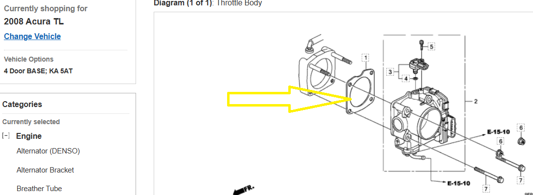

What is that website where you got that diagram?!
Save it to favorites & do all preliminary part # research there, then shop the web for best price.
Intake Manifold - 2008 Acura TL 4 Door BASE KA 5AT
