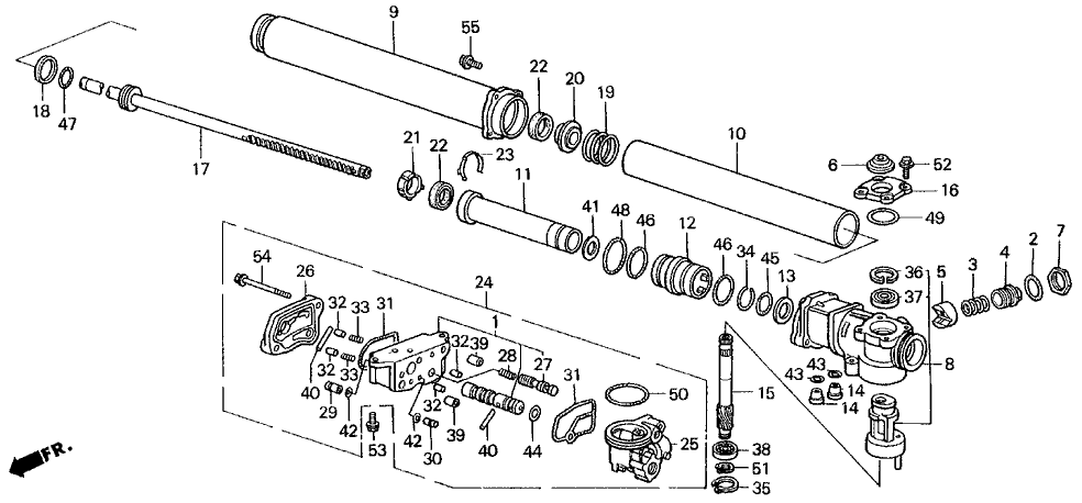

Anyway, from the parts diagram it looks like the trunk lid bolts to the hinge arms so it seems like you should be able to remove the inner liner of the lid and pop open the hinge arm trim pieces to just take the lid off at hinge end to make for a lot less work. Any owners or autobody techs try it this way instead?
https://www.acurapartswarehouse.com/...4C3A547F0310AF
