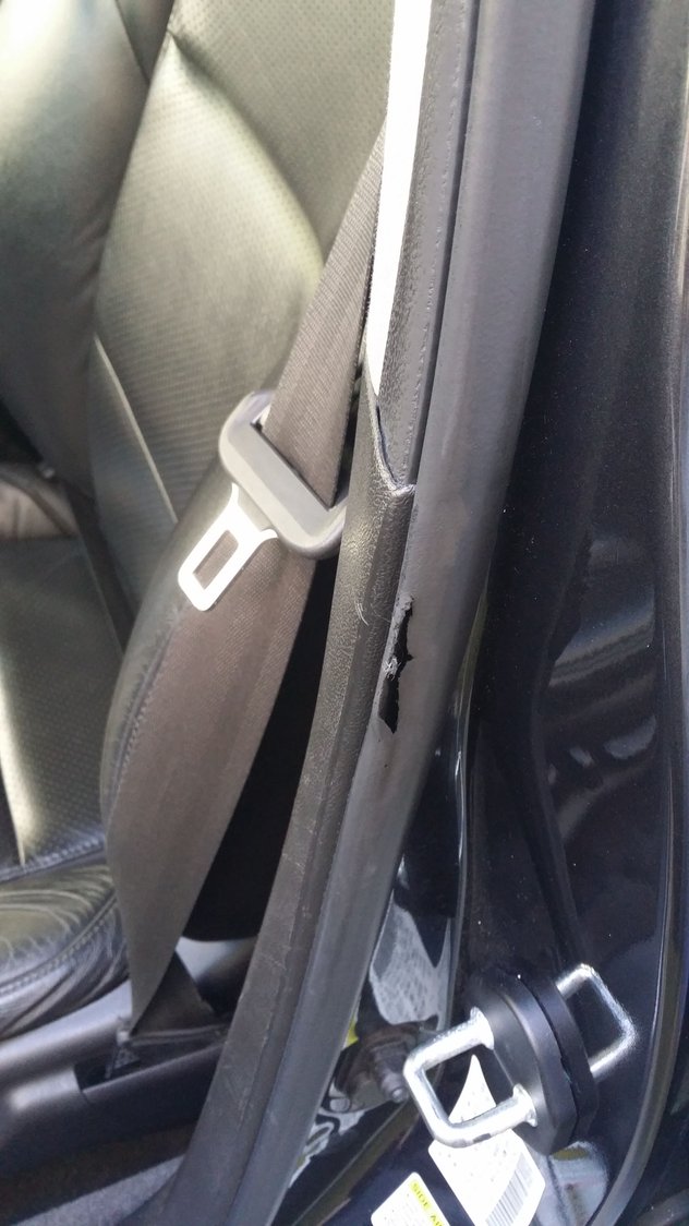

Old Oct 6, 2015 | 07:17 PM
hashbrown's Avatar
Joined: Sep 2015
Posts: 36
Originally Posted by robocam
because it is damaged
Happened today, looking to order a new gasket/weatherstripping.
The weatherstripping is very soft and easily damaged. I rubbed against it with body weight. Guess I'm getting to fat!

Sucks bro, but the weatherstripping the thread seems to be refering to is the one attached to the doors, and the one that is ripped on your car is the one attached to the car.
Those pics above won't help you, but all you do is peel off the old strip with your fingers, there are no clips.

Mine is torn in that same area, I bought a new one & need to install. No clips to remove, the stripping just simply pulls out & put in the new one.

Is it adhesive or do you need to add anything to make it stick?

no its not adhesive, it s held in by friction of the weatherstrip over the channel.

Yup, just take your time, but you may need a spackle tool to get it in the crevice next to the side of the dash. Be sure to cover the spackle tool with a cloth so you don't scratch anything.

I just installed mine, took just a few minutes, but around the side of the dash was the tight spot. I had to use the putty/spackle knife wrapped in a microfiber towel so not to scratch anything, then sprayed a little silicone & used the tip of a flat head screw driver to wedge to the lip of it into position. Just go slowly with it & try it from different angles, but not all dash boards are installed the same & you may have enough clearance to get it in. Tight spot for me was the upper corner of the dash near side section.
