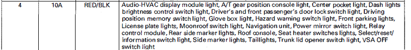

There is fundamentally a short in the electrical system somewhere. I'm assuming you're referring to #4 in the engine bay? It's alot more than just the 3 you've mentioned. I've attached all the items that are linked to that fuse. Start by checking the wires that are closest to whatever was being worked on.
