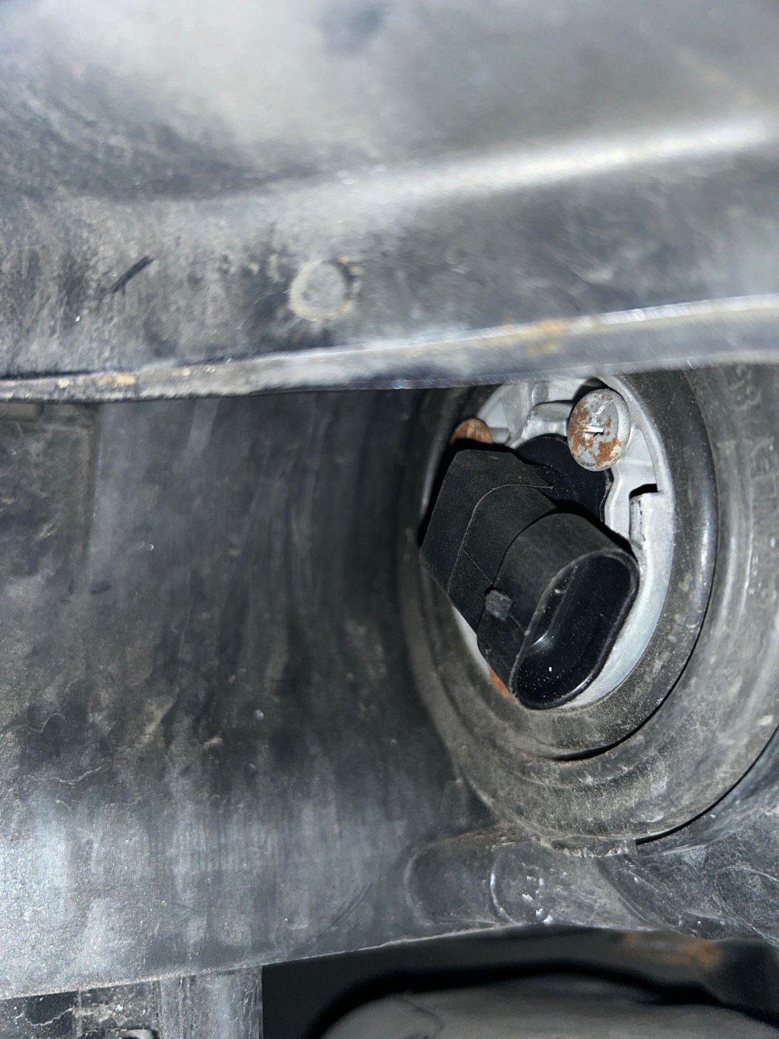

Picture of my fog bulb installed
I did make another thread about this but I can't figure out why it's not a tight install. It doesn't pull out when it's fully turned to the right but it's loose. What am I missing?

Did you try an extra gasket or an o-ring?

I haven't as it looks just like the OEM bulb which was tight when I first removed it but even that bulb I can't back in tight so this is an issue with me it seems. It's just really weird

Have the Philips screws that retain the bulb bayonet backed themselves off? Check them but don't force them.

It doesn't feel like it but I will check. I kinda hope they are lol

But both bulbs were tight when I first unplugged them. That's what's throwing me off

Exactly what replacement bulbs did you buy?

Unfortunately, some cheap aftermarket white LED bulbs from Amazon Never was a fan of halogens

I would go pick up a standard 9006 bulb from your local auto parts store to confirm if it fits/sits correctly. I didn't realize you were using some odd el'cheapo LED glare generator bulbs. My guess is either screws backed out a bit, or the socket got damaged during the LED install, or you are missing or damaged the o-rings on the bulbs.

I mentioned in an earlier post that the OEM bulbs I removed also don't go back in tight. Nothing's missing or damaged. It does seem like the screws are loose, just haven't confirmed yet

I'll bet if you check the bayonet with a set of calipers, it's not thick enough. This is why you don't buy any parts on Amazon.
As for the socket on the headlight and the old bulb: Either the screws backed off, and/or the original bulb o-ring is shot.
