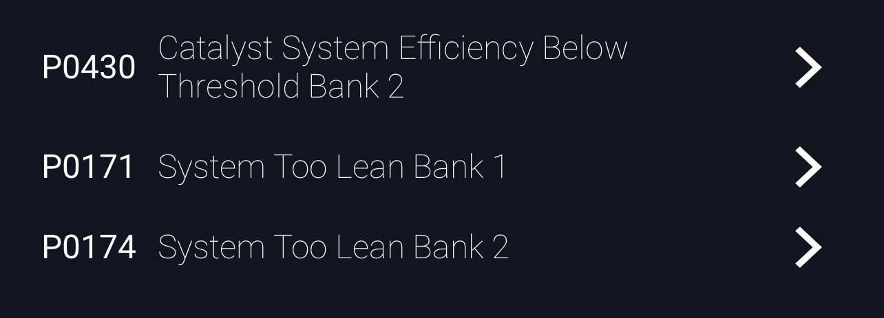

Here is a picture of the live data as well.

Hi Chad thank you so much for responding. The car did have a CEL light but I had to disconnect the battery to work on it and the light cleared. It was throwing P0171 and P0174 but ever since the reset it has not thrown them.

the 430 may be a result of the lean condition. Have you ever been inside the motor? Have you ever cleaned the fuel injectors?

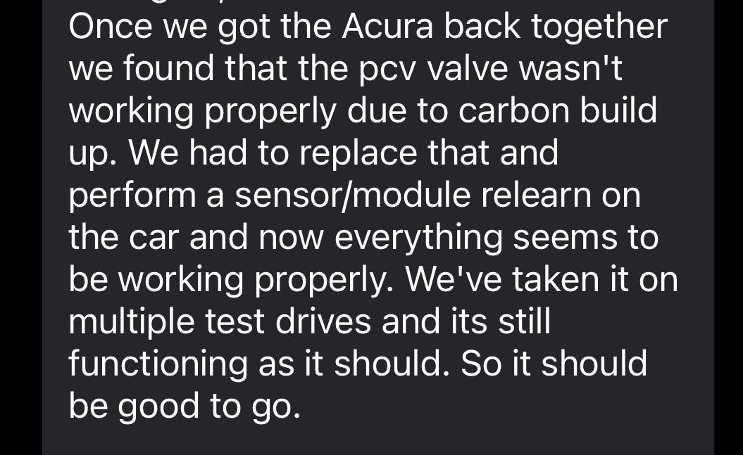

Hi Chad, I ended up taking it to the mechanic. They did a valve adjustment and reprogramed the ecu. They put new gaskets on everything and car is running normal now!

I wouldn’t be surprised if they lied about mileage, but this engine works a lot better than a hydro locked one . I correct myself it was a sensor/module relearn. They also replaced pcv valve
