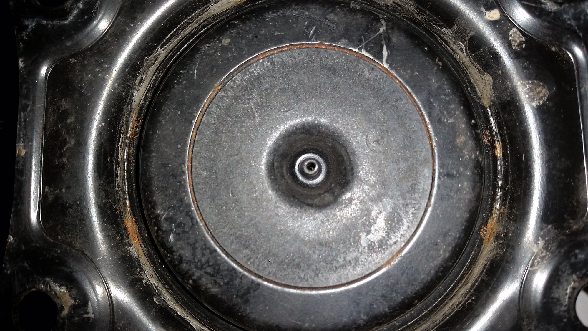

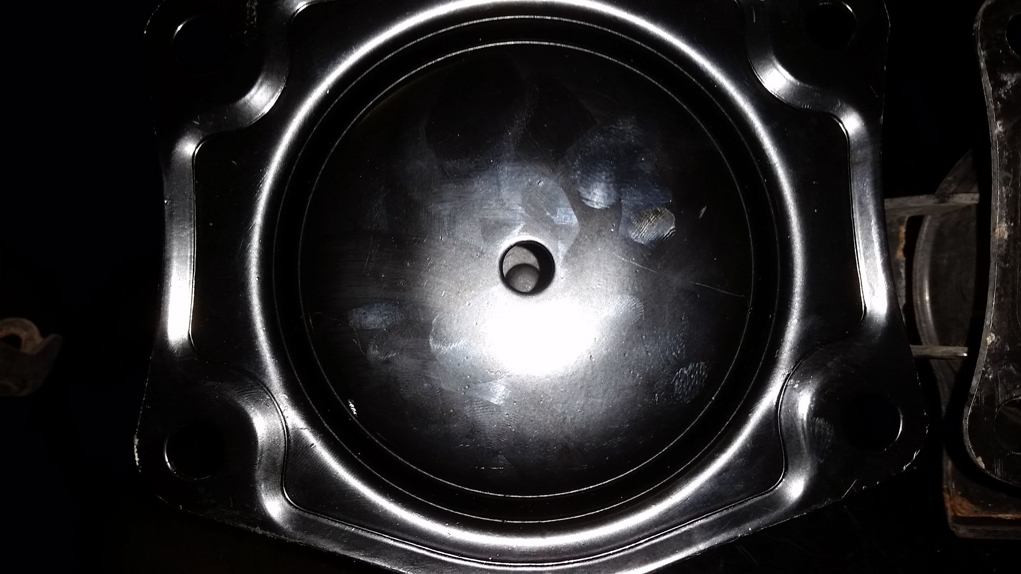

Don't Buy Engine Mounts From This Seller!
http://www.ebay.com/itm/221903229492?_trksid=p2057872.m2749.l2649&ssPageName=STRK%3AMEBIDX%3AIT
No Vacuum hose nozzle on the bottom like the original, and what's really worse, Paul had to drill out all 5 mounting holes to make them bigger so they'd all fit into place! Vibrations were smoother after he got it in, but still ........
I called the number on the invoice, got a woman that could barely speak English who told me to only contact them through ebaY. Wish I bought from the same seller in the OP's post above, the seller I got the front mount from.

Originally Posted by DMZ
For 04 08 Acura TL 3 2L 3 5L Standard 4599 Rear Engine Motor Mount w Hydraulic | eBay
The original:
The Original Mount
Their Mount
