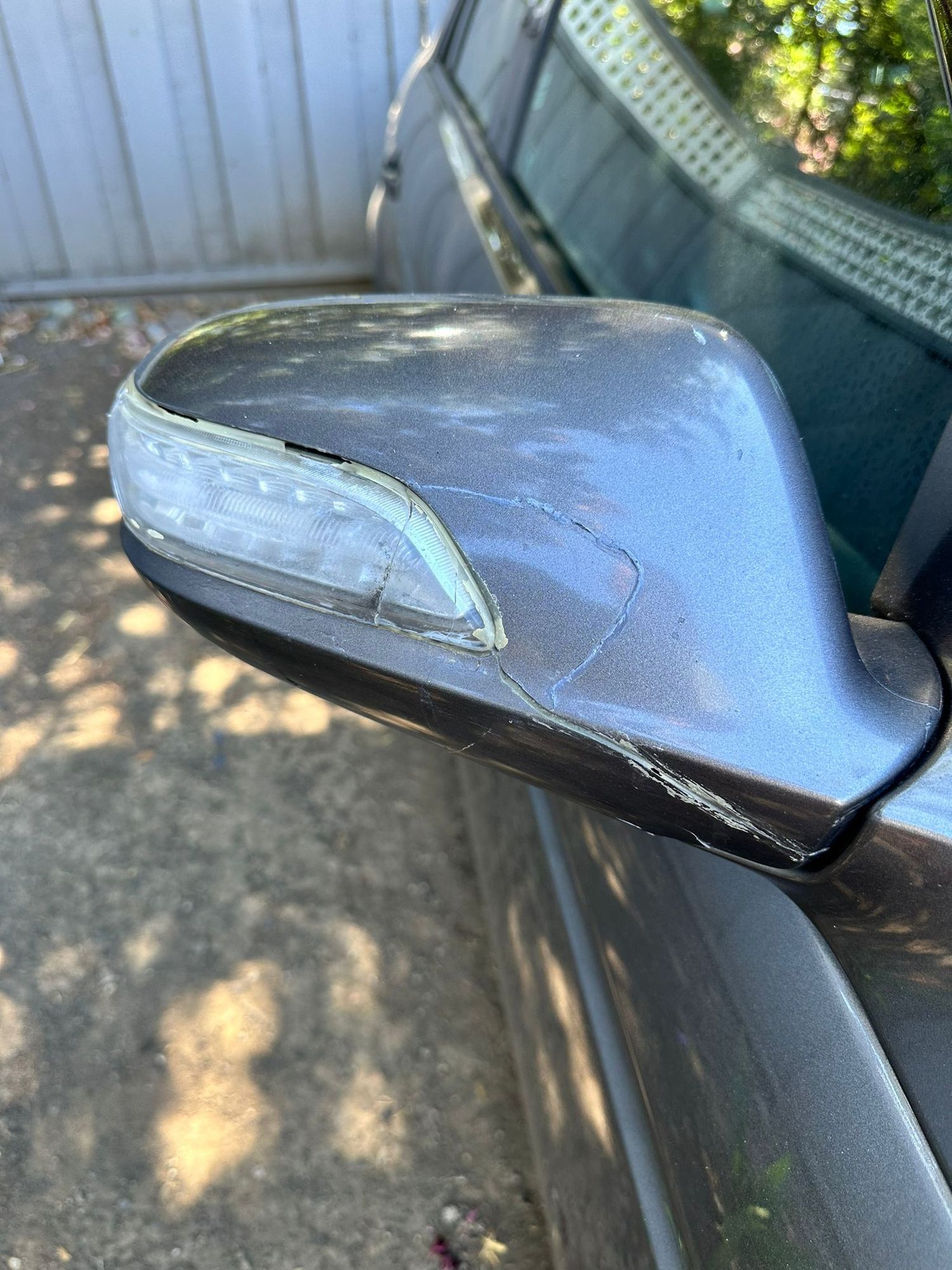

My outside casing for the driver side door mirror is broken. I would really appreciate some help. The mirror works OK, just the casing seems to be broken

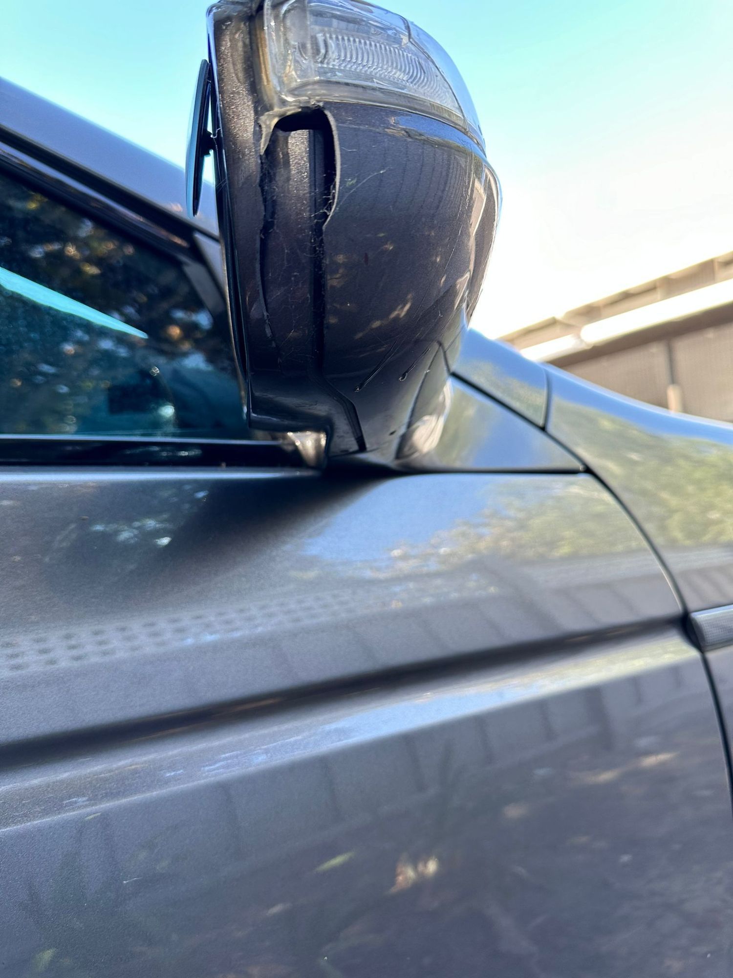

Pics of my broken driver side mirror

From the looks of those pictures, you are going to need one, color coded to your car, of either #4 or 9 housing set and one of #1 or 2 side turn lamp unit.
Mirror - 2008 Acura TL 4 Door TYPE-S KA 5AT (acurapartswarehouse.com)
The diagrams below will give some detail on how to dismantle the mirror.
