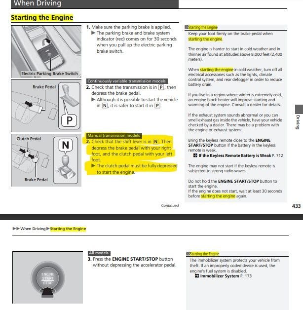

Here is the procedure for the 2024 ITS manual trans.
Both the brake & clutch pedal are depressed, though it specifically states the clutch must be:
