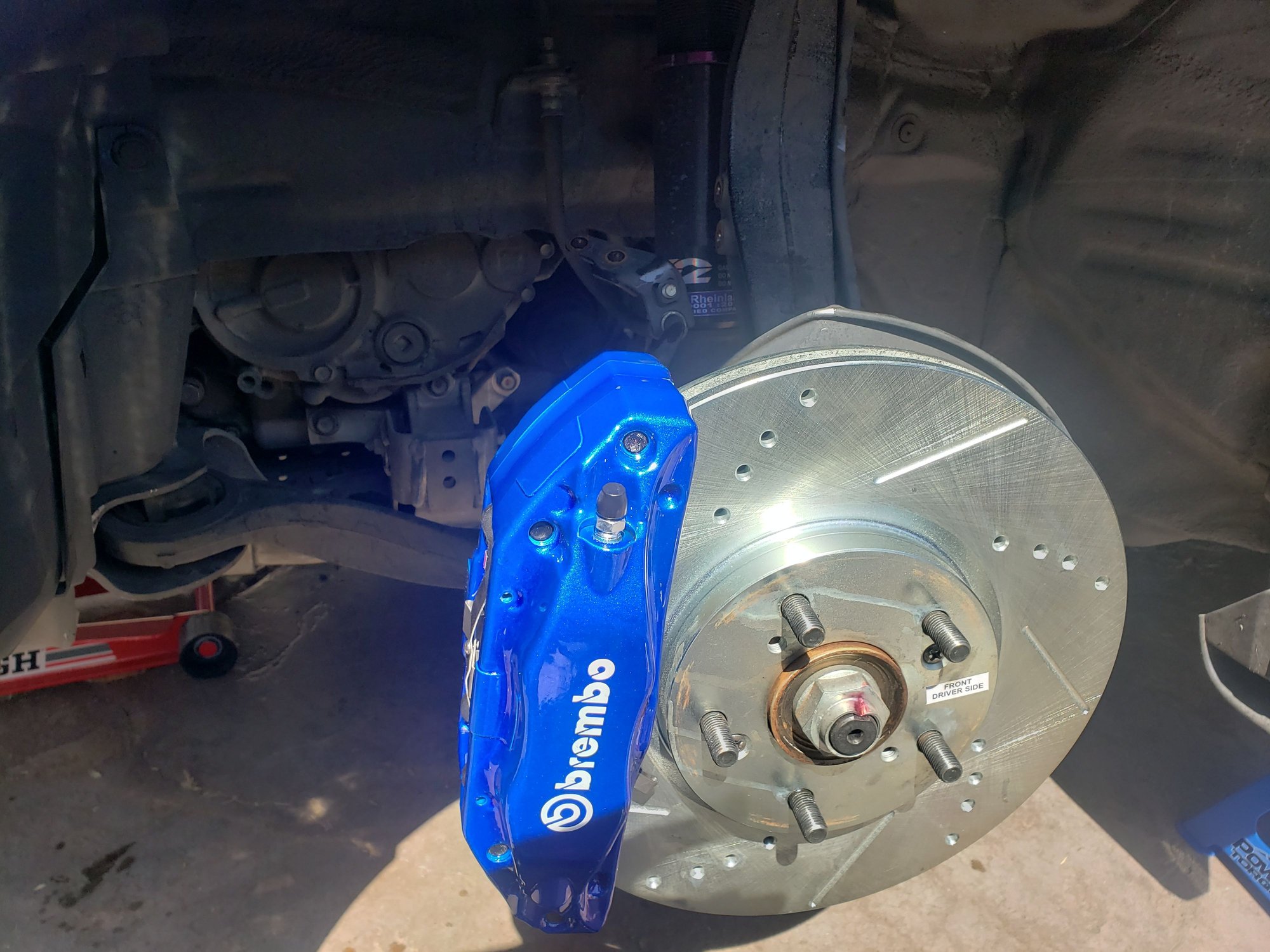

Wondering what's the best BBK out there for TL? Anyone run ECB yellow stuff?
Do any newer Hondas/Acura have same caliper bolt pattern? I was going to see how well a Honda pilot front caliper sized up to the TL.

Get the calipers and front arms off a manual 04 TL or a 2007-2008 TL Type S.

Wilwood makes BBK. There are currently a couple members testing prototype BBKs on here as well.

Do you have a link to the exact one they offer? I feel it's over 1k I might as well just find other compatible rotors and calipers for cheaper no?

It is more than 1k. Some on here found that genesis calipers fit our TL well. There is a guy who can make you the caliper brackets.

https://acurazine.com/forums/3g-tl-p...%24800-985869/
Heres the thread I made about using Hyundai Genesis Coupe 4 pot calipers on Base TL knuckles.
