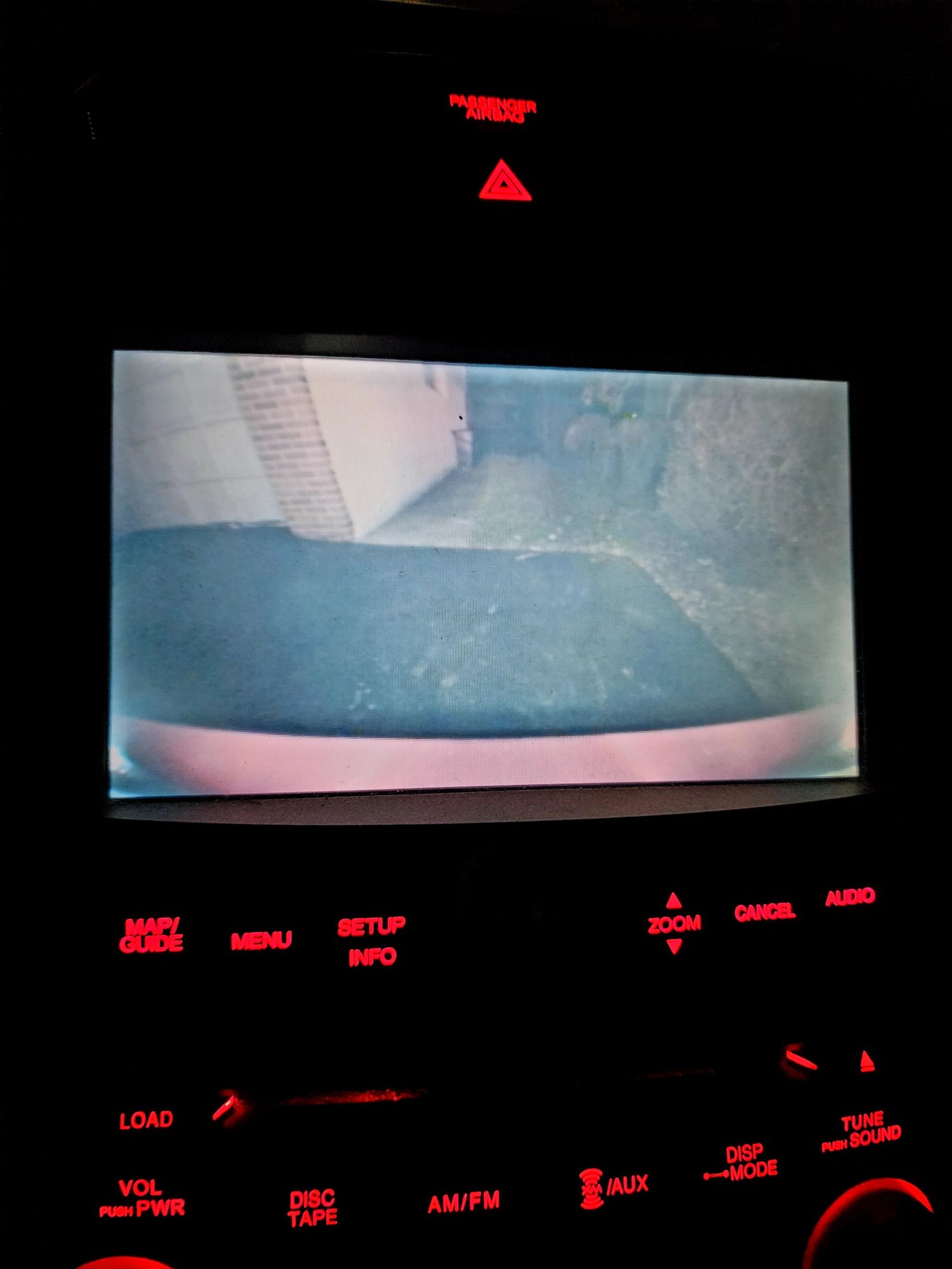

My 2007 TL-S backup camera doesn't have night mode. Is this normal?
It's so hard to see at night, especially when it's raining.

Yeah, I agree it’s not great. I turn off my lights when backing into the garage to get the screen back in bright mode.

One thing you can try is pressing the 'zoom' button upwards on the navi, I believe this raises the brightness of the screen when the back up cam comes on. I may be wrong though.

Turned up screen brightness + bright LEDs did help. Thanks!

This actually works!! Thank you for this tip!
My MRP 5AT has factory license plate & B/U bulbs and seemed not-as-bright as the two that have LEDs. I assumed that is what made the difference at night with the back up cam being "less lit up."
So I had to run out in the cold and dark and try your tip---and it DID get brighter! YAY!
