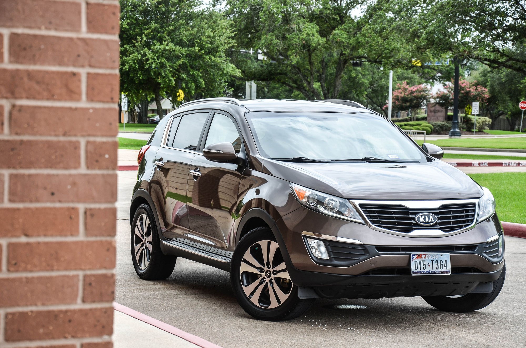

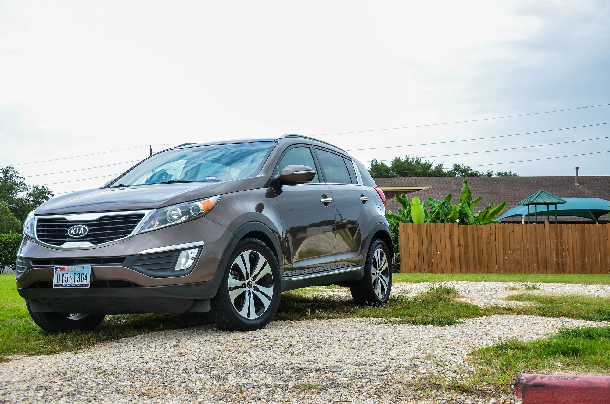

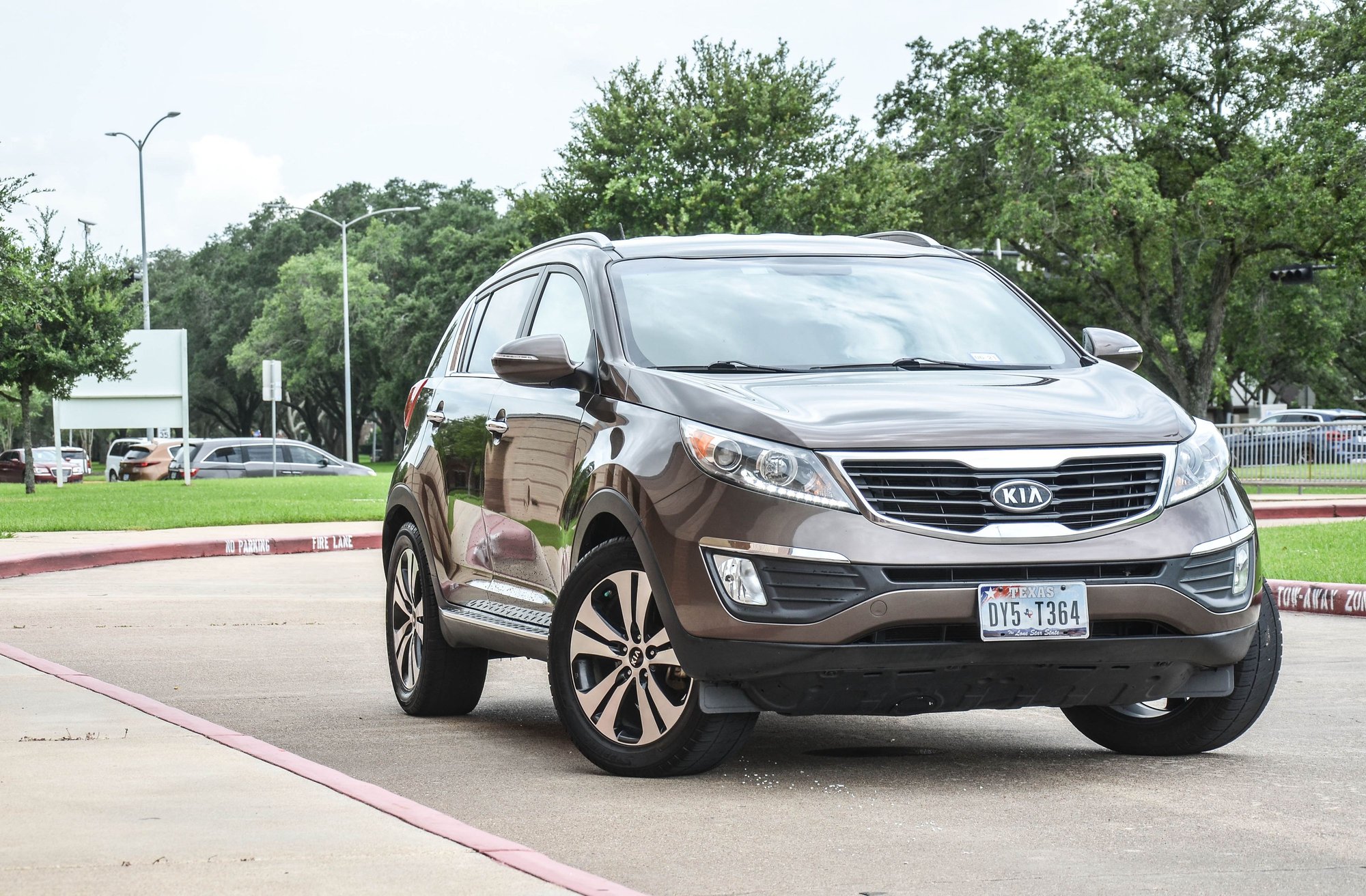

Here's a full paint correction/detail that I did in July of 2020.
Took me about 12-15 hours.
Used Jescar correcting compound then followed up with Jescar's Finishing polish. Then added a layer of FicTec ceramic coating as my LSP (Last step Product) If I really wanted to; I could add a layer of Jescar's power lock plus as a finishing sealant to make it ultra shiny and glossy. (but at that point in time, I was too tired 12-15 hours of work)

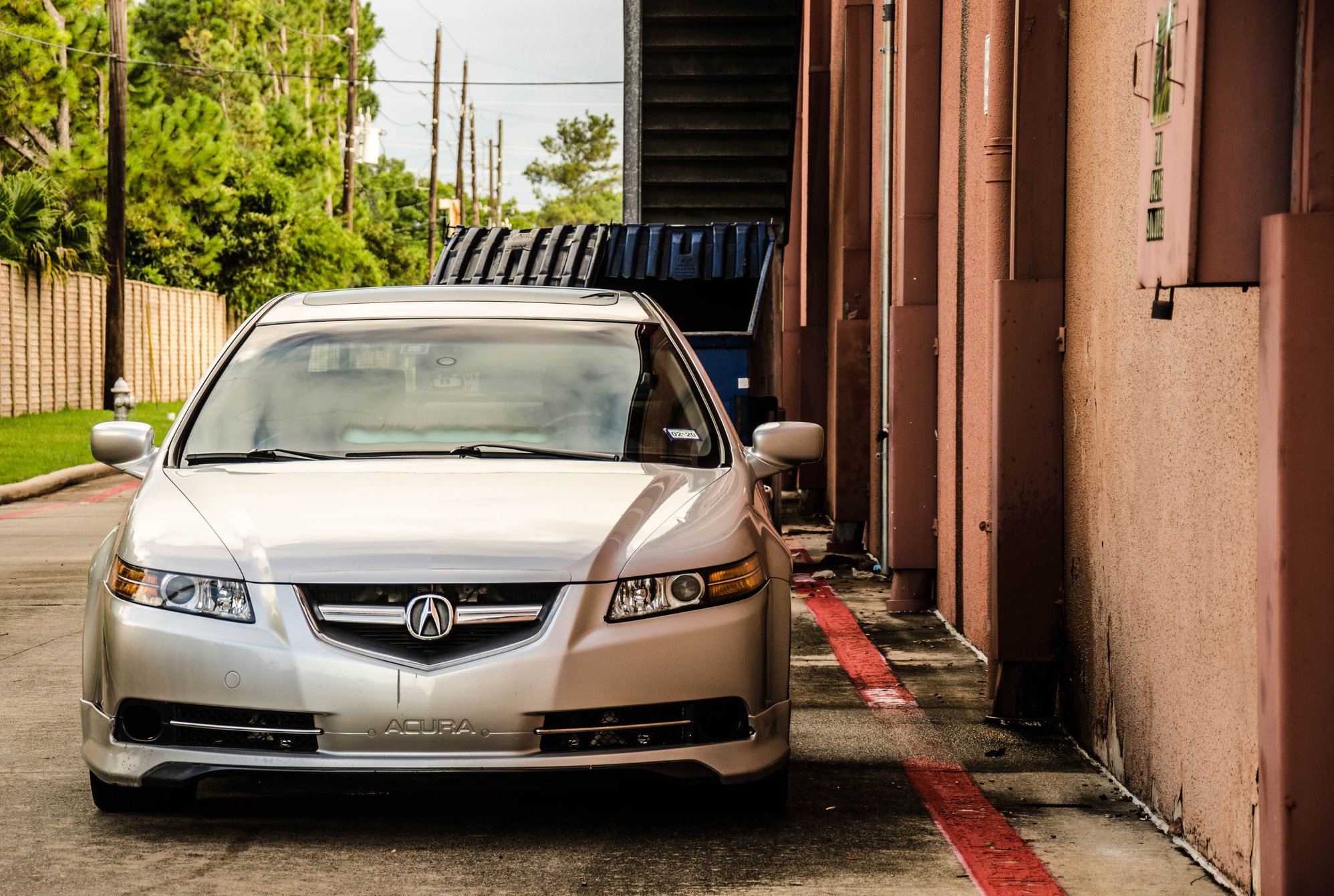

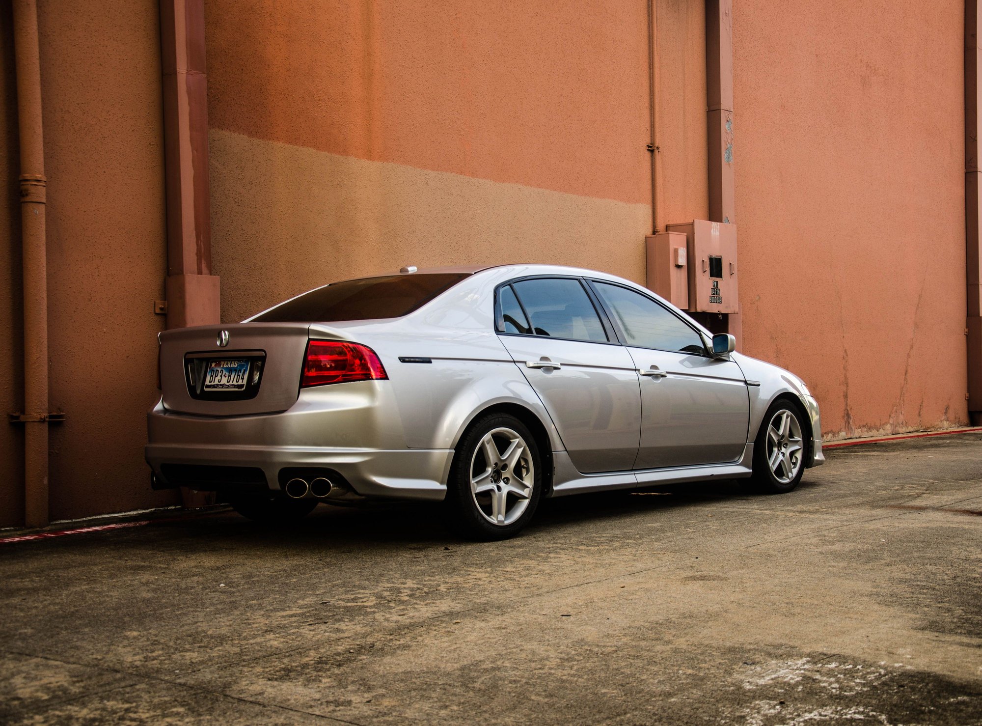

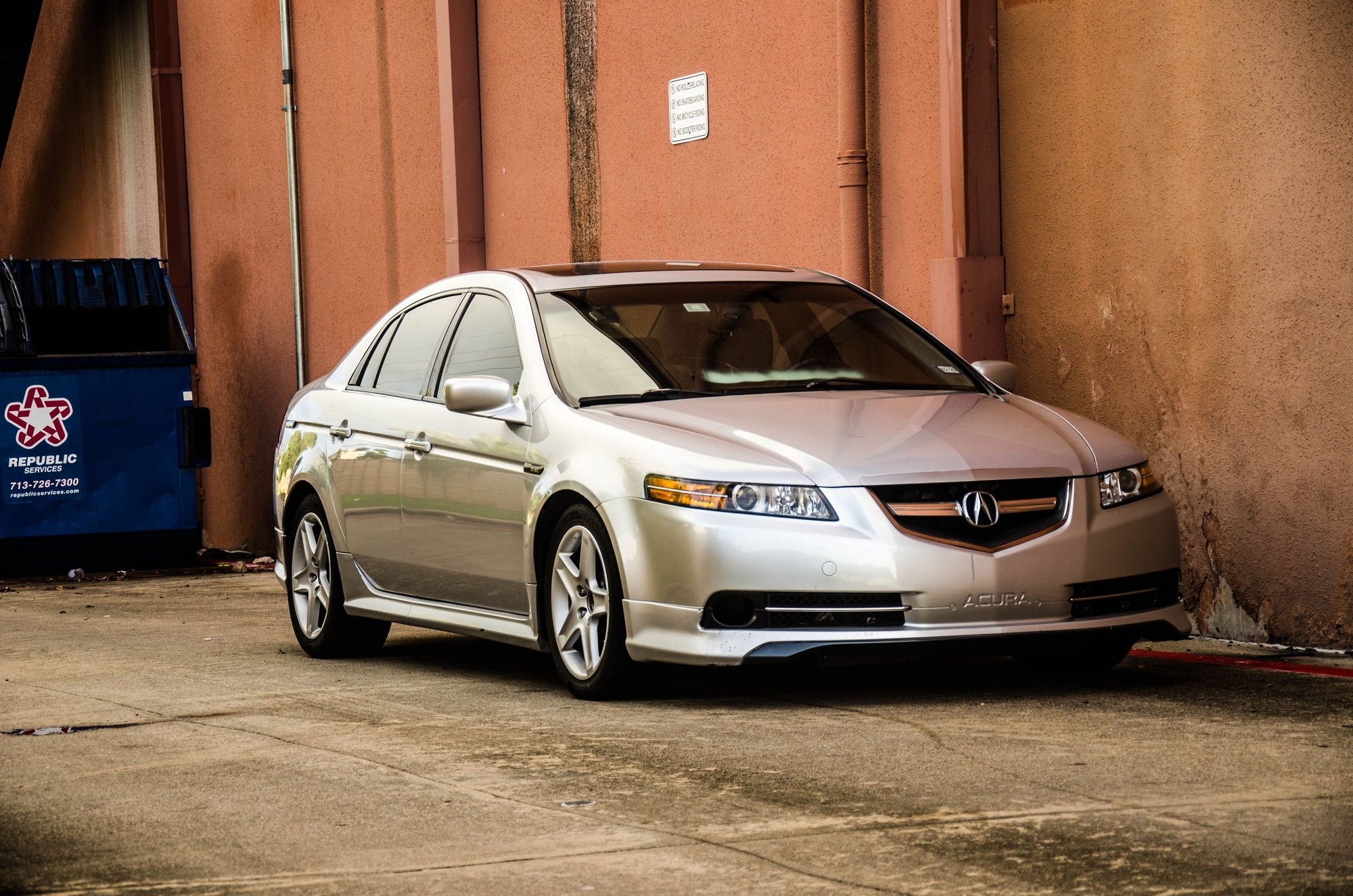

I also did a full correction/detail 12-15 hours on my car as well a couple days after I did the Kia.
the pictures didnt come out as well as the Kia's.
I guess I'll show them anyway (pic whore)
