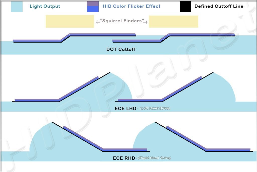

I'm actually referring to the projector, not the ballast.
The projector on the 06+ is different than the 04/05. 06+ provides a sloped cutoff whereas 04/05 provides a sharped cutoff - according to the official headlight thread. I want to keep the sloped cutoff.

Essentially the same but not really. Like he said the cutoff is different.

You know this...
~2006 models are DOT
+ 2006 models are ECE

DOT is like ___|-----
ECE is like ___/---

my eyes must suck cuz I swear my cutoff is #
