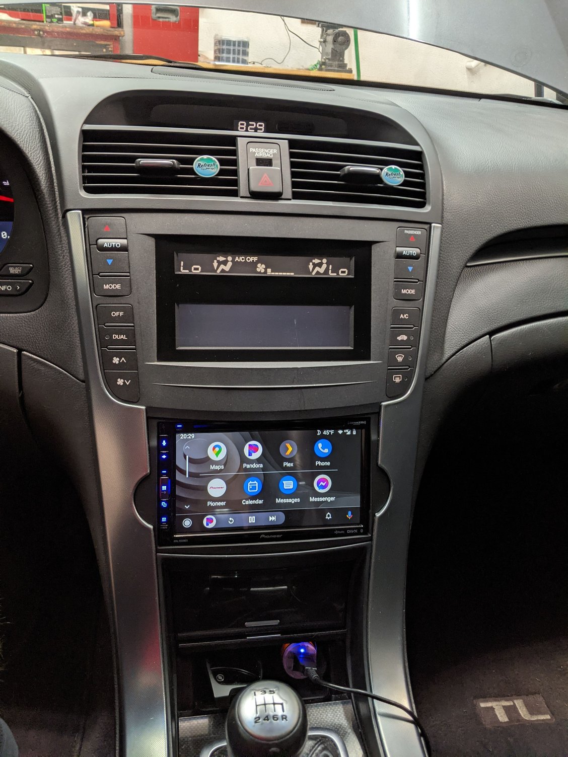

I would definitely recommend an aftermarket touchscreen stereo as opposed to converting from non-navigation to navigation. In my 2006 TL, I had a broken navigation system and handsfree link , prompting me to look at options for repairing or installing aftermarket. I ended up going with a Pioneer double din stereo (and converting to non-navigation, but you wouldn't have to do that) and it's been great so far. Having modern phone integration through Android Auto/Apple Car Play is exponentially better than the factory navigation and handsfree link. And that is comparing to 07-08 Navigation, I used to have an 08 TL with fully functioning navigation. There's just no way around the fact that the Navigation system in these cars is 15ish year old technology.
As people have mentioned, most aftermarket touchscreen stereos have a RCA input for a backup camera. I haven't installed one with mine yet, but plan to as shown in the video shared by Synchro.
In terms of downsides for installing an aftermarket stereo in these cars, it ends up mounted a little lower than one might like. That combined with the semicircles left from the volume and tune knobs make for a somewhat ugly appearance to some. For me, the modern features are worth the compromises. I have included a picture of my setup.
By the way, if you decide to go the aftermarket route, https://mobilemaxcaraudio.com/ made this a very easy install in terms of wiring. I bought their complete install kit and it made the whole process plug and play. They make a custom harness based on the brand of stereo you buy that retains the steering wheel controls and factory amplifier. The information is out there to wire everything up for cheaper, but it saved a lot of time having the plug and play harness.

Yes, the harness included the Axxess module which allowed all the steering wheel audio controls to work. However the Axxess module does not readily allow for use of the handsfree link buttons. It is possible, requiring the handsfree link buttons to be connected into the audio controls circuit. I contacted mobile max about it and they explained it to me, but I decided against it because its easy enough to hit the google assistant button on the radio screen.
I have the USB extension cable coming out of the access cover for the parking brake adjustment. The I have a USB A to USB C cable running to the upper part of the center console where I plug in my phone. So everything is hidden away in the center console.
I have the microphone up by the rearview mirror. Works great, no issues with phone call quality.

My 07 type S had Navigation, but the disc was from 2014 and scratched when I got it. The stock rev camera is pretty lame and the resolution is poor, with no grid lines for reference.
I opted to install an Pioneer navi unit and clarion camera with license frame mount from another car that I already had. Its a lot of wires, but its totally manageable if you can read a wire diagram.
I am actually considering one of the newer 9" remote displays with cell phone mirroring to replace the stock navigation display; which is rendered useless with an aftermarket head unit.

What screen is that?
