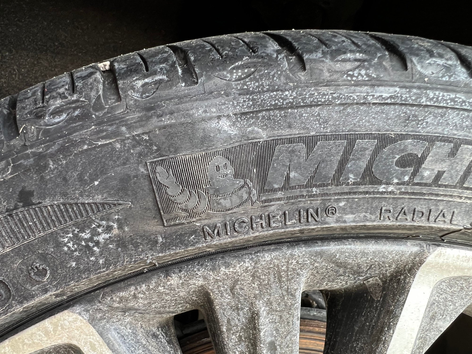

Quick tire review. First picture is a big sidewall bubble in the 26k mile OEM MXM4s on my 2020 SH. It looked much worse in person. This happened about a month ago. I don’t know how it happened. Could have been a pothole, but I don’t recall recently hitting anything that bad. These tires are currently on forever back order, so I could not just replace a pair as would be recommended.
I therefore took the opportunity to replace all four tires. After some research, I chose to buy Continental Control Contact Sport SRS+. This is Discount Tire’s equivalent to the ExtremeContact DWS 06+; they are exactly the same with an exclusive tread pattern for Discount Tire. I’ve now had them on for 1000 miles and have driven them in essentially all four seasons (yay Cleveland) in the last three weeks. They are not as quiet as the MXMs but have superior dry grip to the MXMs even when new. Wet grip is excellent and resistant to hydroplaning in severe rains. So far, they tolerate light-moderate snow as well. Ride quality is minimally firmer than the MXMs and turn-in is superior, so dry handing is significantly better. So far, a solid choice. I paid just under $1300 installed. They are worth the money…it was only painful because I had to replace my wife’s tires the same week…was an expensive week…
