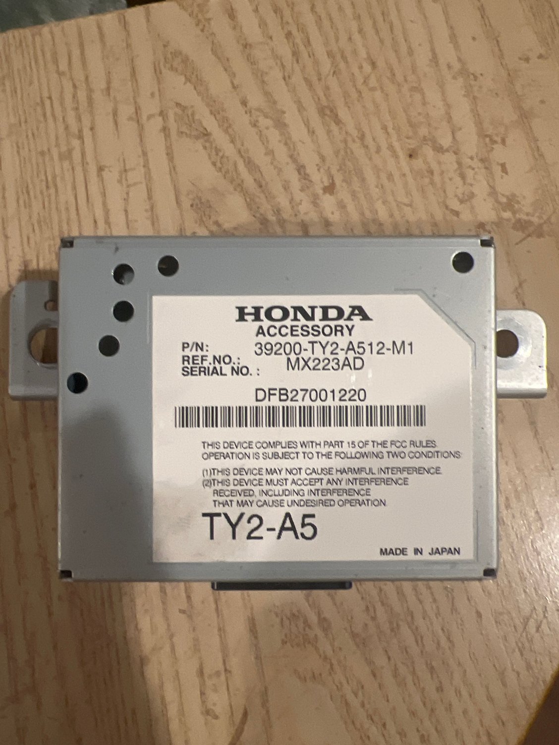

Here is a pic of the ANC module. Part #s will be different, but box size should be the same.
