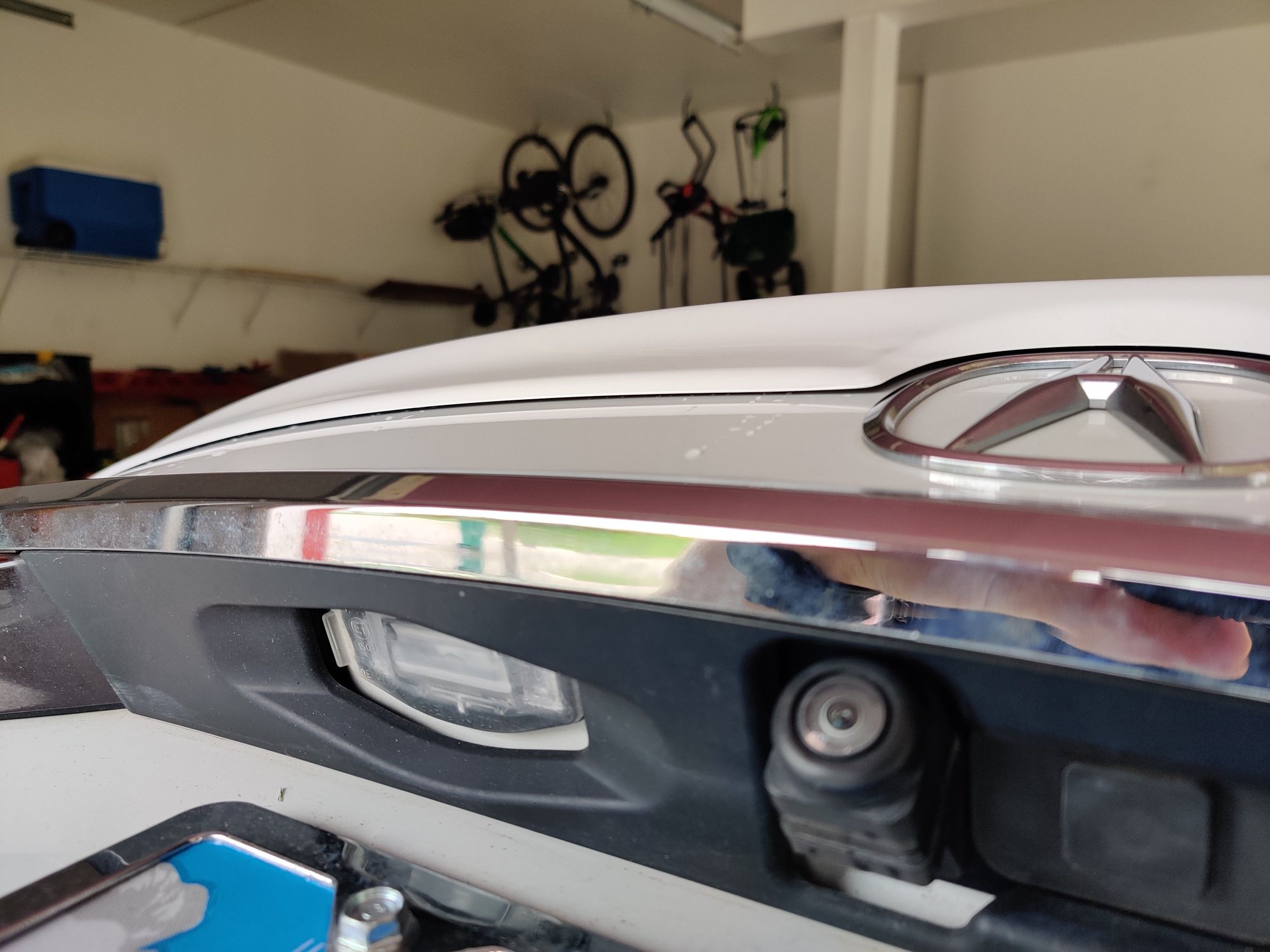

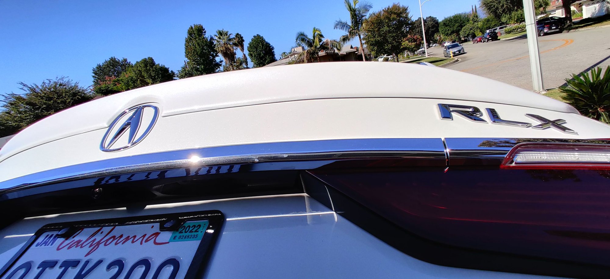

Wow man that look absolutely horrible install. I hope it doesn't fly off on the way to dealer. Hope they'll fit it right for you.

Originally Posted by jdpdata
Wow man that looks absolutely horrible install. I hope it doesn't fly off on the way to the dealer. Hope they'll fix it right for you.
I just called them and will be taking the car in a couple of hours back to them. It looks like the service guy was not much surprised when I explained what the issue was but just said to bring it in.
I was trying to find diagram/install instructions for the spoiler but all links are broken on the forum here - I am now suspecting if he even used screws/clips and drilled holes because the whole thing just feels like a BAD 3m tape mounted spoiler... I am going to try to put some masking 3M tape (blue painter tape) and take local roads w a slower speed limits so it does not fly off... urgh... how would we else get our blood pressure sky high if there were no dealers ...

wow, definitely need to re-install the spoiler. Water and dirt will definitely get into that gap. Where did you have this installed?

Your spoiler is buckled and distorted like that because the paper template that they have in the installation kit was not precisely applied and centered up on the trunk lid before they used the rotabroach drill bit to cut the holes.
The dimensions are all off fir where those holes and their embedded plastic retainers are placed in those four holes so that when they applied and snapped in the spoiler …..it deformed due to dimensional mismatch.
This whole trunk will now have to be replaced!!!!!
I installed one on my own car and took every opportunity to learn every detail required to get it right the first time. It looked and looks great after two years of everyday use.
So sorry but this is a dealership disaster.
Yeah, the dealer service mgr called back to let me know they are ordering a new spoiler to ensure it is installed properly - my hunch tells me the first installer at the dealership jacked up something on the spoiler, or did not prepare correctly 3m tape.
What I am also suspecting is if he drilled the wholes out of proportion, no brand new spoiler will solve that issue - if there is a gap again, trunk replacement will be the next step ... oh well.
Dealer is located in Highland Park, and so far I am pleased with the Service Manager's response and a follow-up call. I do have to say this dealer I serviced both TL and RL for many years there, and we have NEVER experienced any issues - this is now the first problem we ran into they are addressing... makes me wonder if the holes were different... I would not be surprised if they replace trunk and spoiler all together before they call me to pick it up lol

Originally Posted by Triaque
Paul L.
One thing that I did check was alignment - spoiler was super centered and I am not sure if drilled holes would give that up - so from the rear around acura emblem, spoiler was very nicely centered - hope drilled holes are not fuked up? i guess...

Spoiler Woes
Rlx
You can center the emblem and force the spoiler ends guide pins into the trunks plastic retaining grommets and the holes not be in the right spots. I centered mine up with the emblem before pushing down on the spoiler to snap it in place. If they had the holes drilled in the wrong place and forced the center to bond first….then pressed the ends down into the grommet holes…..then pulled the tape off the intermediate lengthens on either side of the emblem…..you’ll get buckling on either side.
Rlx
That makes sense - I guess they will then have issues installing the brand new spoiler too if that is the case with the drilled holes and will end up replacing the whole thing (trunk + spoiler) - because no matter how good they install this, it will peel off / separate from the trunk

Spoiler Woes
RLX015
With any curved surface.
If you have an item that is custom cut, bent, moulded etc., that will be matched to any other left hand/right hand negative/positive surface. There must be an exact match without resistance or and necessary applied force to achieve the match. If there is force required, then there will be deformation. This will cause distortion and gaps and/or spring/torsion forces that cause buckling and detachment.
I had the dealer service manager replace the bottom rear molding on my always covered 2019 Honda Odyssey’s rear door glass. The trim would not stay attached at the terminating ends near the adjacent molding of the rear of the fenders. The molding was not curved correctly to match the glass curvature. Honda is going on the cheap with molding getting them str8 out of China. They couldn’t understand why it kept popping off the retainers on the glass edge till i showed them that it didn’t lay on the glass without gaps before installed just above the installation area. It was causing it to bend and be under constant stress. No retainer for trim is designed for that kind of tension.

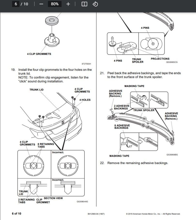

This generation RLX has no leeway for bolts. Bolts are not used. They have a plastic insert female retaining insert. The male counterpart is on the uninstalled spoiler. If there is any dimensional conflict it will deform the flimsy thin plastic these are extruded into shape from. It’s not like the old Honda stuff. You need to have actual hands on knowledge to know. Take a look at one.
Old Sep 23, 2021 | 06:26 PM
  #54
andysinnh's Avatar
Joined: Oct 2014
Posts: 887
Likes: 339
From: Merrimack, NH
Andy
So I see what you're saying (page from install .pdf attached here). It appears as though the mounting points for the spoiler have no access on the underside of the trunk since they're so close to the edges. which means you have to drill the exact size holes in the exact location for this to work - no room for error. The infamous "measure multiple times, drill once - by a competent tech that will take their time". This means that any irregularities in the spoiler itself can't be accounted for - and no way to "dry fit". Frankly, this would really shy me away from attempting this on the wife's '18 RLX SH - because if I mess up she'd never forgive me..... At first I though you could replace the pins with a thin bolt/washer and put a washer/nut on the underside of the trunklid (to emulate the old way of mounting) - but there probably isn't any access from the underside of the trunk to put any bolt in there (I haven't looked, though...). Thanks for sharing the odd design here.....

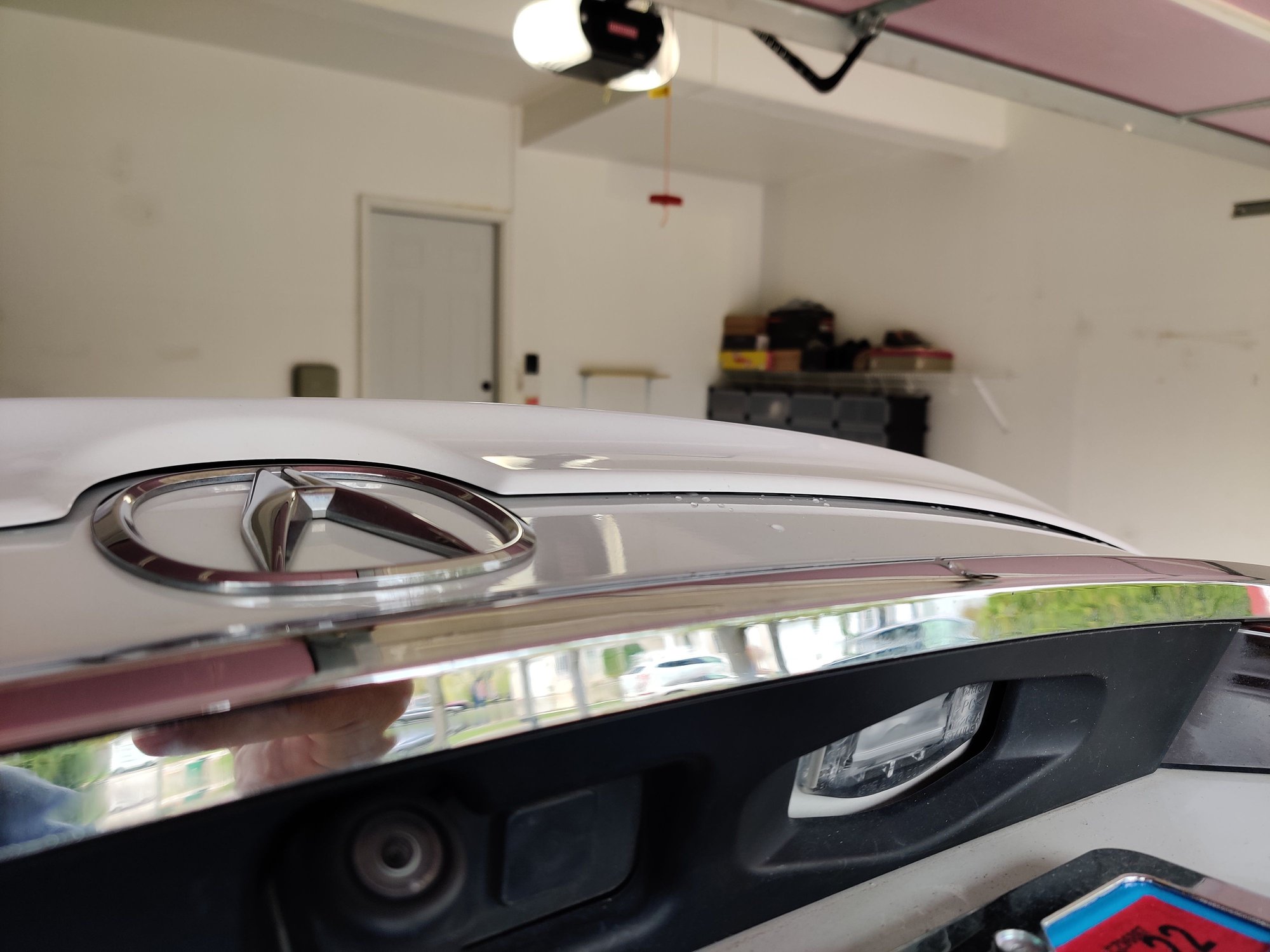

I noticed last night that bottom of the spoiler has peeled off primarily in the right side. While the top is still solid as shown in above pictures, bottom has peeled off, which now points to possible conclusion of - drilled holes ARE wrong/screwed up... By enforcing adhesive on top part, back had no other way but to peel off... What do you think?
I plan to get this in tomorrow and request resolution. Not really sure how will they glue the bottom part without taking the spoiler off, but as it all points too, drill holes are screwed, and can I at this point insist on trunk+spoiler replacement? I just do not have trust or confidence they will be able to fix this...

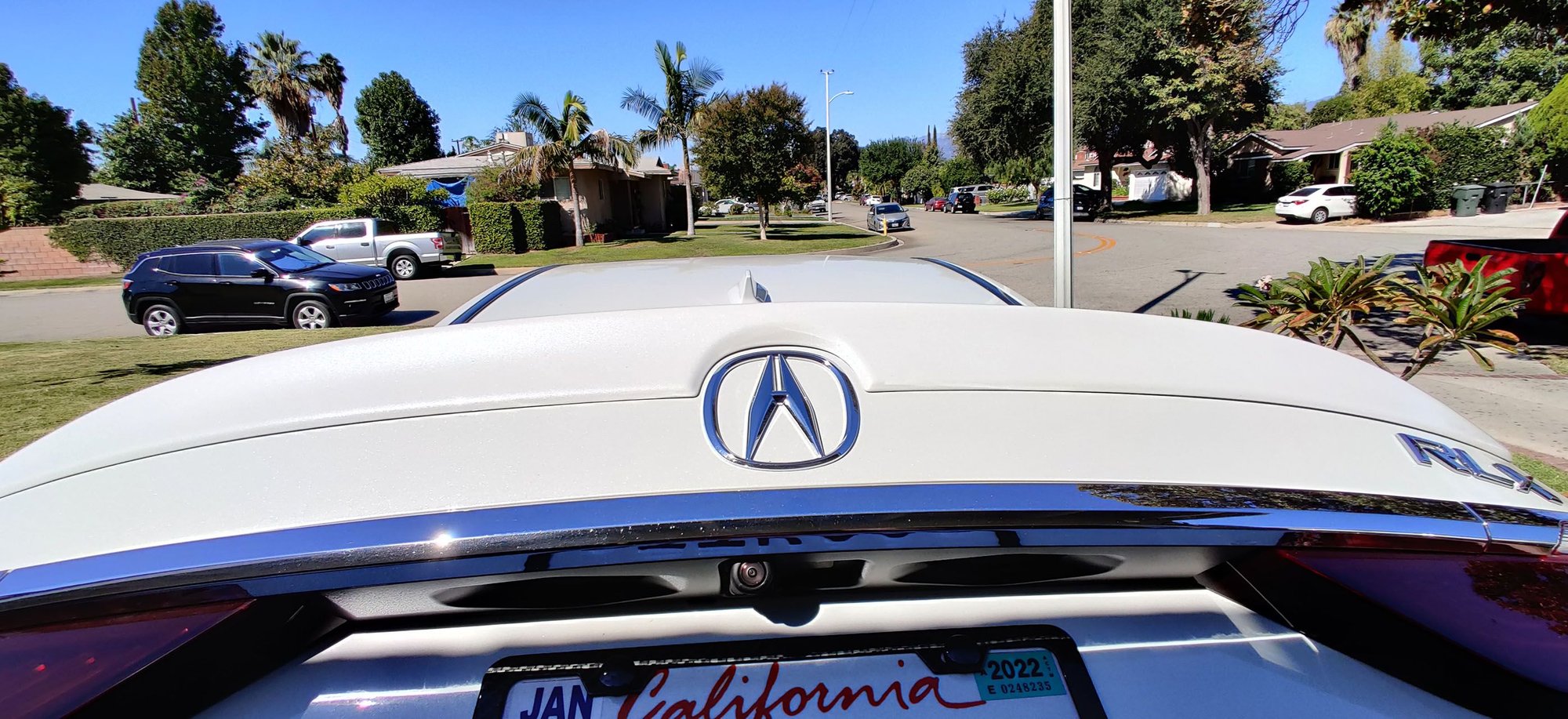

Hey man, here are pics of my spoiler from the bottom. It does have small gap, but nothing like yours. Mine are maybe 1/32" - 1/16" gap and pressing on it it does flex just a tiny bit. No way I could stick my finger lifting it like yours. I say you go demand dealer order you new trunk-lid and spoiler and then go to different dealer to get it installed. They majorly screwed up the drilled holes. You will have leakage problems if left like that. I'd escalate this to Acura HQ if dealer doesn't resolve it to your satisfaction.
Thank you for the pics again!!!
I picked my RLX and now it is really close to what your looks like so seems like they just needed three times to get it right (initial + 2 addtl trips) ☺️ ...
Indeed, mudguards + spoiler really complete the look of this car - love it...

So the day came A LOT SOONER than I thought it will ... Bottom spoiler has peeled off completely again ... In less than two days after "they addressed the problem" ...
I will be sending email to the general manager today with all the details and formal request to make this right: replace my trunk they ruined by drilling holes incorrectly, and spoiler continually peeling off because it was apparently forced into the position that it was not manufactured to be in. Additional reasoning may be that water is getting under the spoiler somewhere and ruining 3m tape... But all in all this so far is simply the proof they ruined the trunk and they will have to make this right before I take additional steps to resolve and address this...

Thanks! I would agree with you... where I see this issue is heading full speed is that drilled holes were definitely screwed up... and while they somehow managed to make it very firm where it sits at the top of the spoiler, that pressure they applied there and whatever tape is now 100% pushing the bottom to peel off both times. The first-time manager said they ran it through the car wash because there were traces of water under the spoiler as it peeled off... While it's not impossible, I am not sure that is the case because each and every time so far when peel-off happened there was water trace under the spoiler... so starting with this: water is getting inside on the edges where the holes were drilled ... I just made a little bit of shadow so my camera can catch the gaps on the sides of the spoiler. These two pics is what you see - not pressed, this is how the spoiler sits... their answer was "spoiler is attached on the clips and once that is installed, that is how it looks... I politely disagreed with them and made the general manager aware of the overall issues with this install... I am still waiting to hear from them on what the resolution is going to be.
At this point, if they do not have anyone to install this per specs how the spoiler should be installed by Acura specification, they can replace the trunk, give me back brand new OEM spoiler I brought pre-install, and issue a refund for the labor I paid the install...
The reason I am now asking for the trunk replacement is that it is obvious they screwed up the trunk by drilling these holes out of the specification, and everything points to that... I cannot leave the space for the option of trunk getting rusted, because where would I find the trunk to replace in a couple of years... ridiculous and frustrating... I do hope and believe that the general manager will agree to make this right the proper way... factually, they screwed up on this install...
PS On the third photo it shows the spot where they damaged the spoiler while prying it wider to put the 3M tape... I did not notice that but after I sent an email to the general manager... once I hear back from them I will ensure to mention that too...who does this!?!?!

I think in general Honda/Acura spoilers and how they were designed all and how it is installed is VERY deceiving... it is not easy to install these, not one bit... sure clips and no bolts - that does not make it easy... and the fitment too, you really have to really know and practice and have the experience to match factory-installed spoiler is my very transparent opinion.
I do want to say this: I cannot envision this car without the spoiler now that is on there... such a good look with the spoiler...
Quick update on my spoiler: The dealer has confirmed they have placed the order for all the parts (trunk lid, spoiler, whatever is needed) and will call me to set up an appointment for an install once all parts are in. Some parts seem to be on back order, so not sure how long will be the wait. Once it is in: I am thinking about a suggestion to the service manager on the dealership - if they do not have anyone who can install this to match those photos of jpdata he shared above, I would rather have the trunk replaced, spoiler part returned to me and refund issued - then I will go to a serious body shop, explain the issues I had and have them install it...
I think it would be CRAZY to let the same person try to install it again after screwing up major time on the first install and going through two spoilers.
Old Nov 7, 2021 | 12:36 PM
  #70
jdpdata's Avatar
Joined: Sep 2017
Posts: 809
Likes: 339
From: Los Angeles, CA
Good the hear they're doing right by you. Definitely don't let the same tech do the installation. Body shop sounds like a better plan. But they may not offer you warranty if it's not installed by Acura dealer. Maybe try another dealership? Good luck.. keep us updated on progress.
Old Nov 8, 2021 | 02:18 PM
  #71
andysinnh's Avatar
Joined: Oct 2014
Posts: 887
Likes: 339
From: Merrimack, NH
I know you're likin' the trunk spoiler - but if it were me I'd get the new trunk lid and say "bye bye" to the spoiler - at least not the drill-holes-thru-the-lid type. I'd be tempted to snip the clips off the one you have, put all new 3M tape on the current one, and stick it on and see how it does. worst thing it'd come off, but wouldn't leave you with any holes.... :-)
Old Jan 13, 2022 | 11:54 PM
  #72
rlx015's Avatar
Joined: Jun 2011
Posts: 992
Likes: 288
Update after dealer addressed the issue:
After all, parts arrived, the dealership has hired a local certified body shop to handle new trunk lid painting, install all including the spoiler as well. It has been about a week already since the install and spoiler is looking exactly the same as the day I picked it up about a week ago... definitely grateful to the dealer for making this initial error into a very positive, and appropriately handled install. I guess this is not a perfect world and mistakes happen, and inevitably frustration started to pile up, but fairly soon General Manager approved and took a
personal interest that this install is taken care of the right way.
