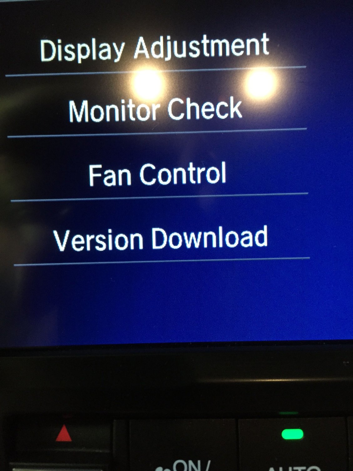

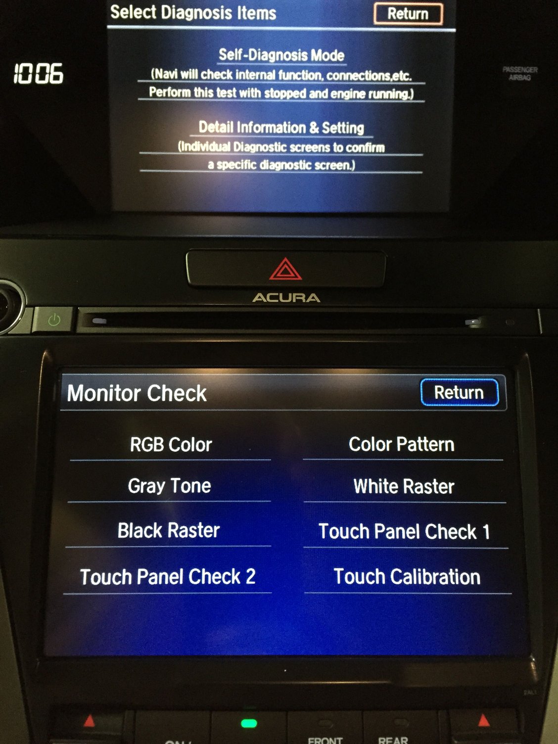

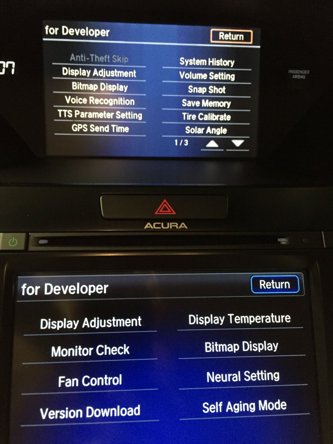

No problem! Just remember that it will also reset all setting.......You should also do this with the car outside of the garage, because it will need to acquire the satellite signal, before it starts working again. The car does not need to be running, just to be in accessory mode.
Hold NAV-BACK-MENU simultaneously, and you will enter the diagnostics menu.
After that hold pressed the "Menu" button until you enter the much more detail diagnostics settings mode.
As you can see both the top and bottom screen changed. You want to go to the bottom touch screen and choose the "Version Download" button.
As soon as you press it, the system will reboot and start "re-installing" the software. Just wait until it finishes. Then enter your radio code, or hold the power button pressed for two seconds when it asks you to (you do this if you don't have the radio code handy, because it authenticates the infotainment system with the vin number of the car).
HTH

Pgeorg - Now that I look at some of those menu items that I have not particularly noticed before, I am intrigued by things like "Neural Setting". Is there any documentation available to us non-dealer-techs that explains all the items in the Diagnostic Menu?
Old Jun 19, 2015 | 12:21 PM
pgeorg's Avatar
Posts: 1,170
Likes: 748
From: NY
I am sorry, not that i know of:-(. The settings on the touchscreen are pretty safe to go through......on the other hand some of the ones in the top screen, not so much....
