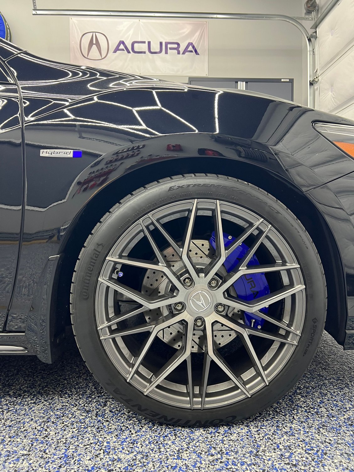

I went with the R1 concepts drilled and slotted carbon geomet series and also R1 "optimum OEp" pads and so far so good. Very [size=13px]noticeable[/size] upgrade in [size=13px]performance[/size] from the stock rotors and pads. I only have about 2k miles on them, so durability is still TBD but [size=13px]I[/size] am happy so far.
