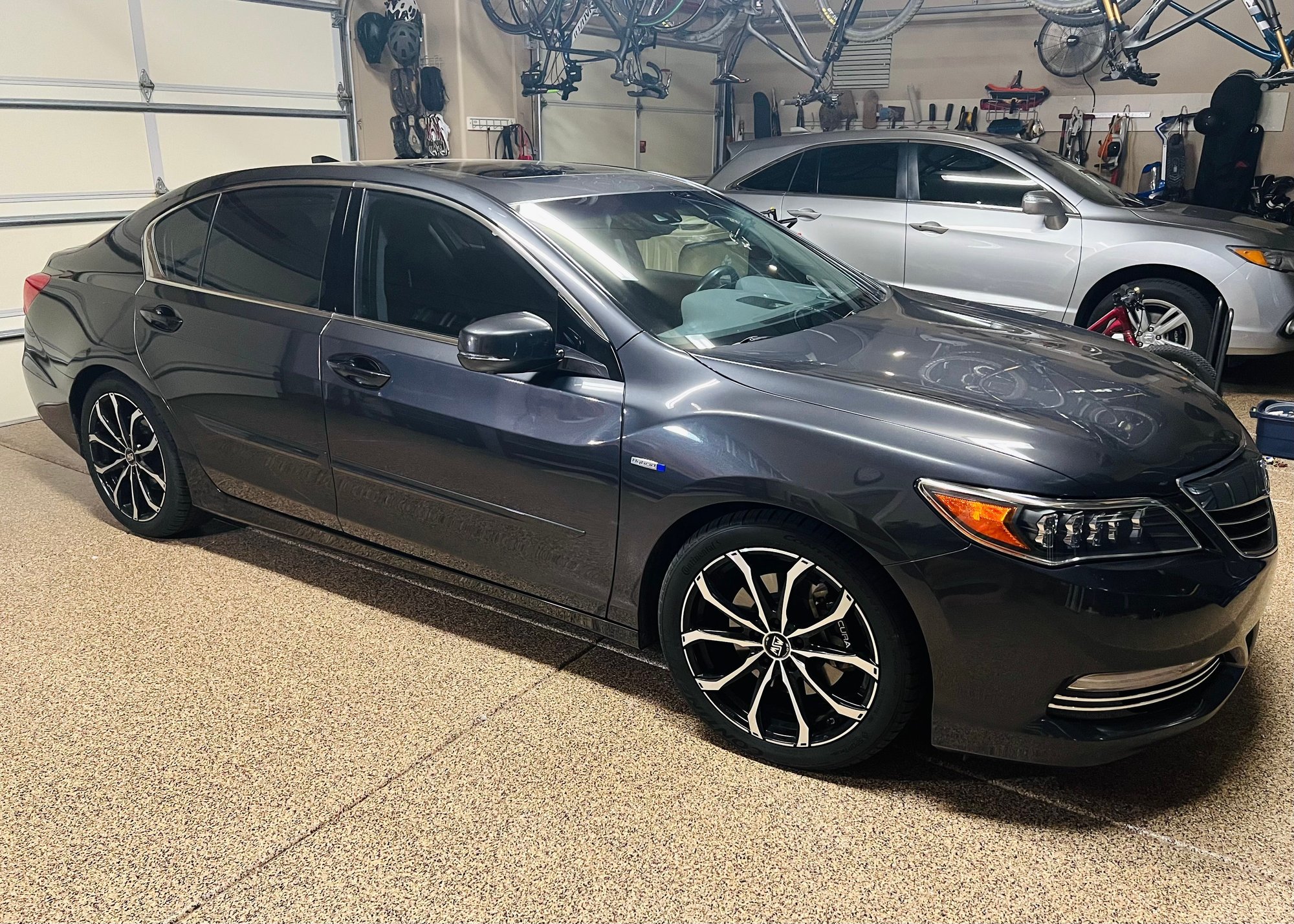

Sounds like you’ve found a good one. Here’s mine, this evening.
This could be my car! Nice rims!

THANKS. Those rims are MSW Type-48 19 X 8, 5X 120.00 45 BKGL: from Discount Tire. Cost was under a grand. After almost 9 years my OEM rims were in good structural shape but a little dinged up and some curb rash. I kept the OEM rims and am going to have them sandblasted, refinished, and repainted (powdercoat) but I was happy with these. Good fit. Would buy again. In my opinion, they are modern and coordinate well >> the bright machined alloy pops the chrome on the window and headlamp surround. I also ordered 4X Acura "A" center round 2.6" diameter emblems, chrome on black, to replace the "MSW" emblem. I should be able to swap them in when I rotate tires next. Will update my other wheel thread ( Which Wheel Do You Like on Gray RLX-SH ? - AcuraZine - Acura Enthusiast Community ) with a new picture if it works out.
