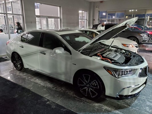

I finally closed on the deal I negotiated on 2021.01.14 and took delivery of my new RLX tonight. My Grom VLine 2 came earlier in the week. Things left to order are Yakima roof racks (Thule doesn't seem to make fit kits for the RLX), hitch receiver, and trailer wiring harness. Can't wait till I get over my 600 mile break-in period. I noticed the 2020 owner's manual no longer refer this to "break-in" period like my 2012 owner's manual. I'm not too terribly happy with automatic transmission, but I think the RLX has many other things that tickle my fancy and I can overlook the lack of a clutch and manual shifter. =) I am also not too happy the dealer couldn't update my navigation database and software.
Anyone in the Midwest/Great Lakes area have any thoughts on winter tire/wheel sets, or overkill for our winters? I've never run them before, but considering them now.

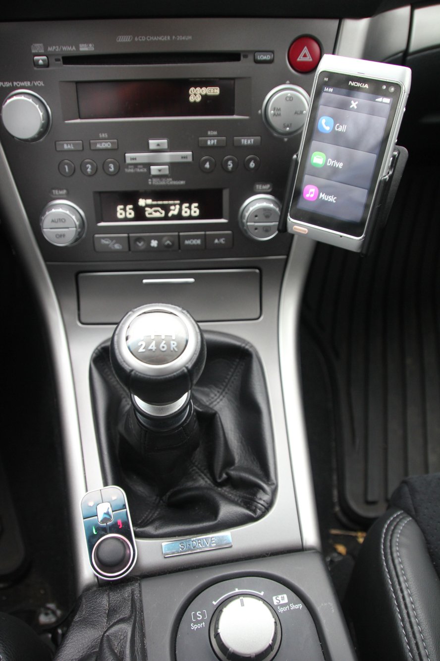

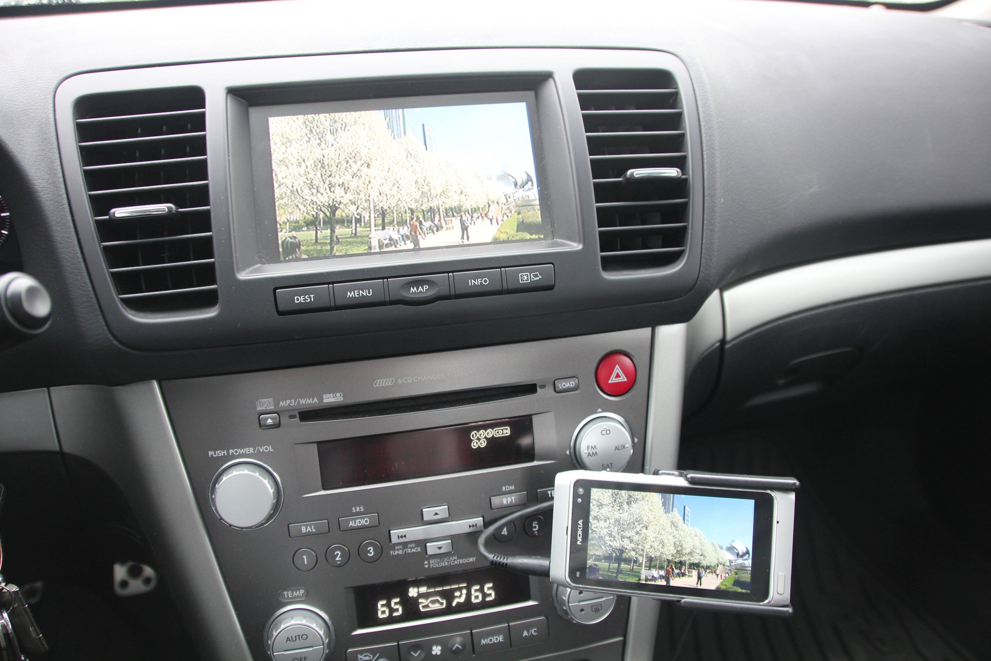

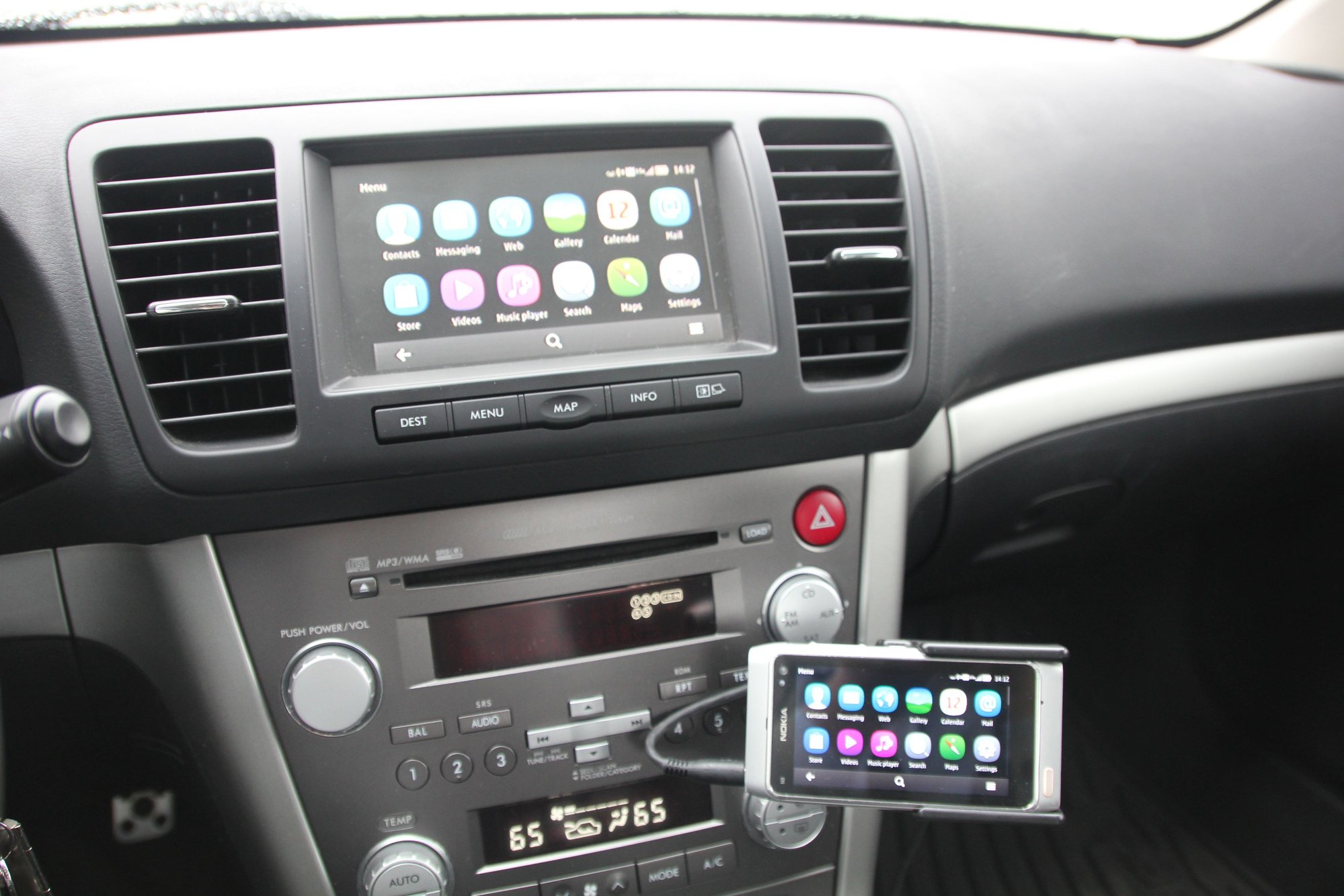

Speaking of Grom and SpecB, I started reminiscing Nokia Symbian's Android Auto before Android was even born that I added to my SpecB. I never got around to adding Grom to my TL because I had a wireless charger and mount combo on the base of the A pillar setup that I really liked. It wasn't blocking my view of the road, easy to glance to, not too close to my face where focus adjustment between road and screen is less, and easily reachable with my left hand quickly from the steering wheel. I am thinking about mounting my phone there for the RLX as well, so I may need to run a long USB wire from glove box to the driver side A pillar for the Android Auto. And possibly run a shorter USB wire to the center console and get a AMPS mount similar to my SpecB so I have both options, which requires me to plug/unplug the other end in the glove box. Where did you mount your phone, and where did run your USB wire from Grom to? I also bought the C-VTOYUSB cable, but now that I have taken delivery of the RLX and inspected the interior for planning things out in my head, I don't think I will be leaving my phone in the center console armrest box as imagined anymore.

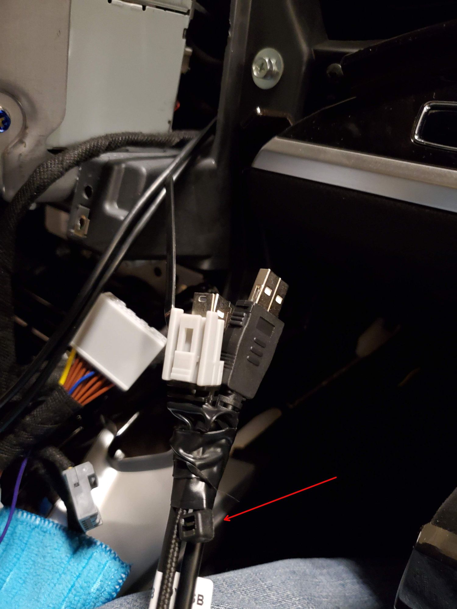

You do not have to remove emergency light button. In fact, it's very hard to remove if you have big hands. I barely fit my hands behind the radio to route wires, and I have very small hands and skinny fingers. Leave yourself plenty of time to route GROM cable harness, like I said, you don't have much room to work with. I ended up removing the kick panel below the glovebox making things a bit easier for me. All the panels are very easy to remove in the RLX, most of the time I only used my fingers, no pry tools needed. I highly recommend getting C-VTOYUSB Retention Cable from GROM, it's like $12 or something. With this cable you can use the existing USB plug in center console making the entire install very OEM like and I never have to open glovebox to plug in my phone. When I get into car, I plug-in phone to USB port in center console and leave it in there during the drive. I hate mounting phones to dash, it looks too cluttered for my OCD side. Good luck with install!
Forgot to mention, you can use wireless CarPlay if you use an iPhone. Wireless Android Auto is supposedly supported with Android 11. I have received Android 11 update on my Samsung Note 20 Ultra, but GROM still haven't updated their firmware to support Wireless Android Auto yet...c'on GROM!! With wireless you don't even need to plug anything in. Just start the car, GROM should detect your phone and launch Android Auto/CarPlay automatically. Still need to figure out a way to wirelessly charge my phone for long distance driving.

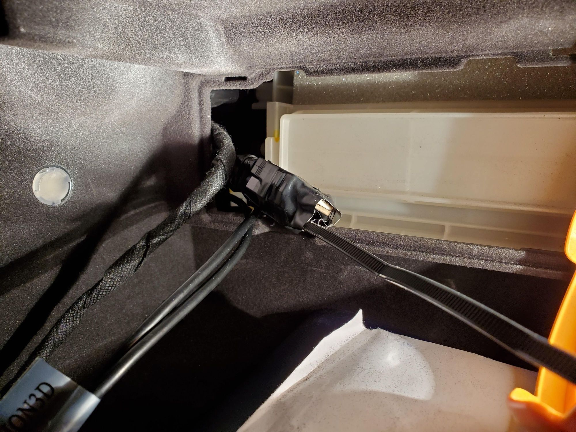

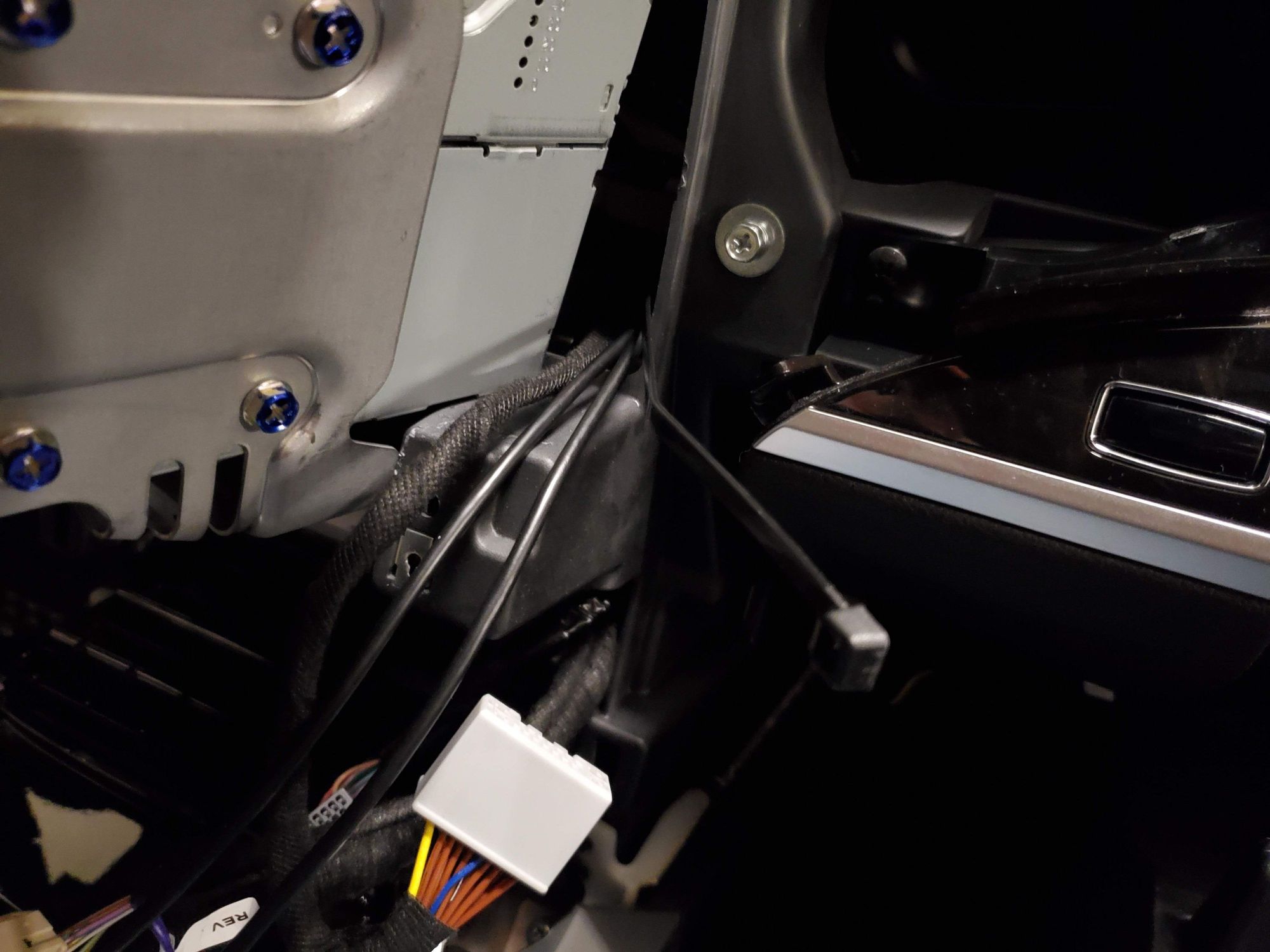

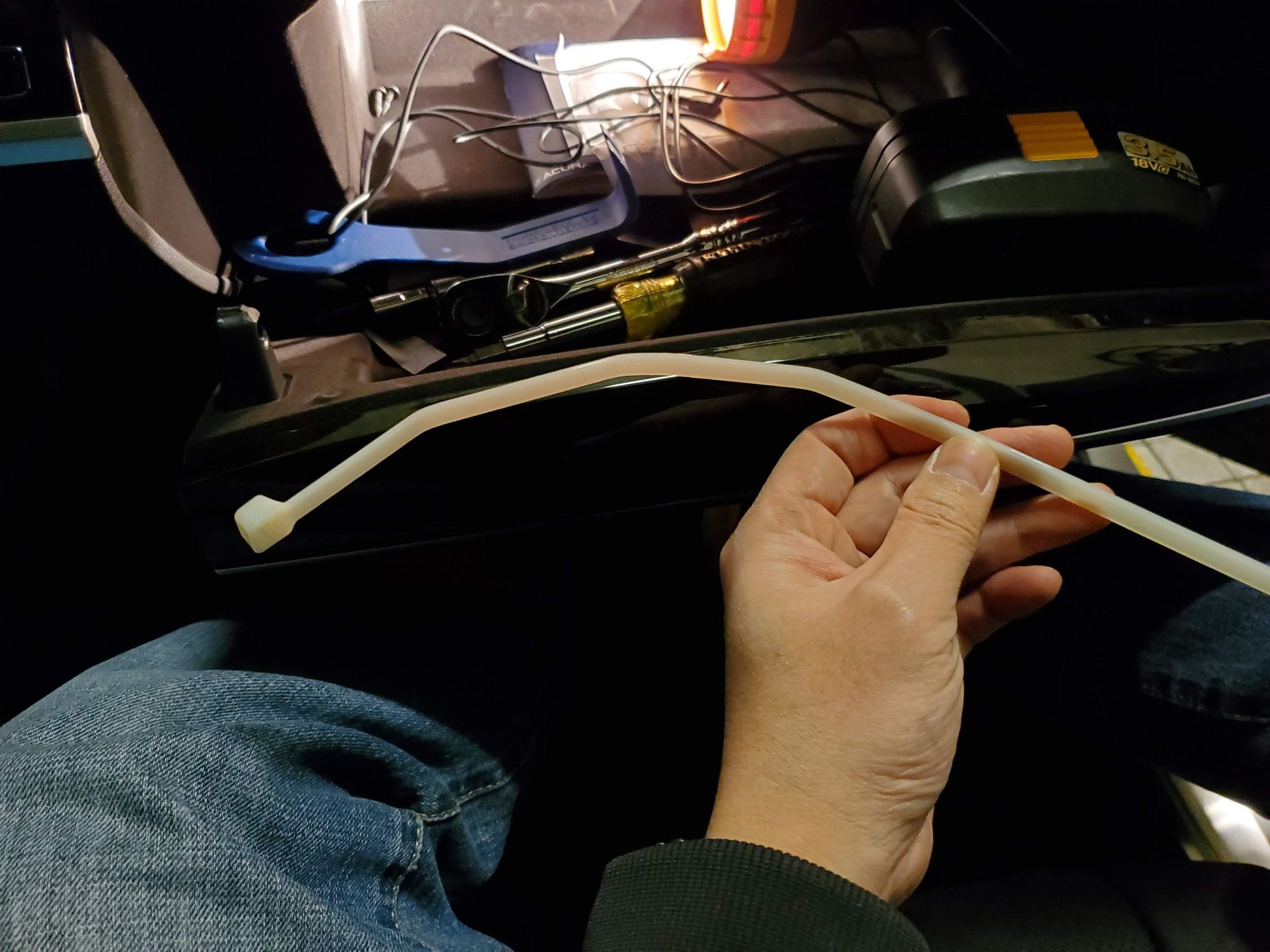

Thanks for letting me know about the emergency lights plug. Having pulled quite a few radio head units from many cars and ran wires in the past, I plan to use my track motorcycle fairing fasteners to aid in running wires. LOL
And yes, I purchased the C-VTOYUSB cable along with my Grom. Verified it's in the package I received earlier this week. I think I'm going to install it today because next weekend is Super Bowl.

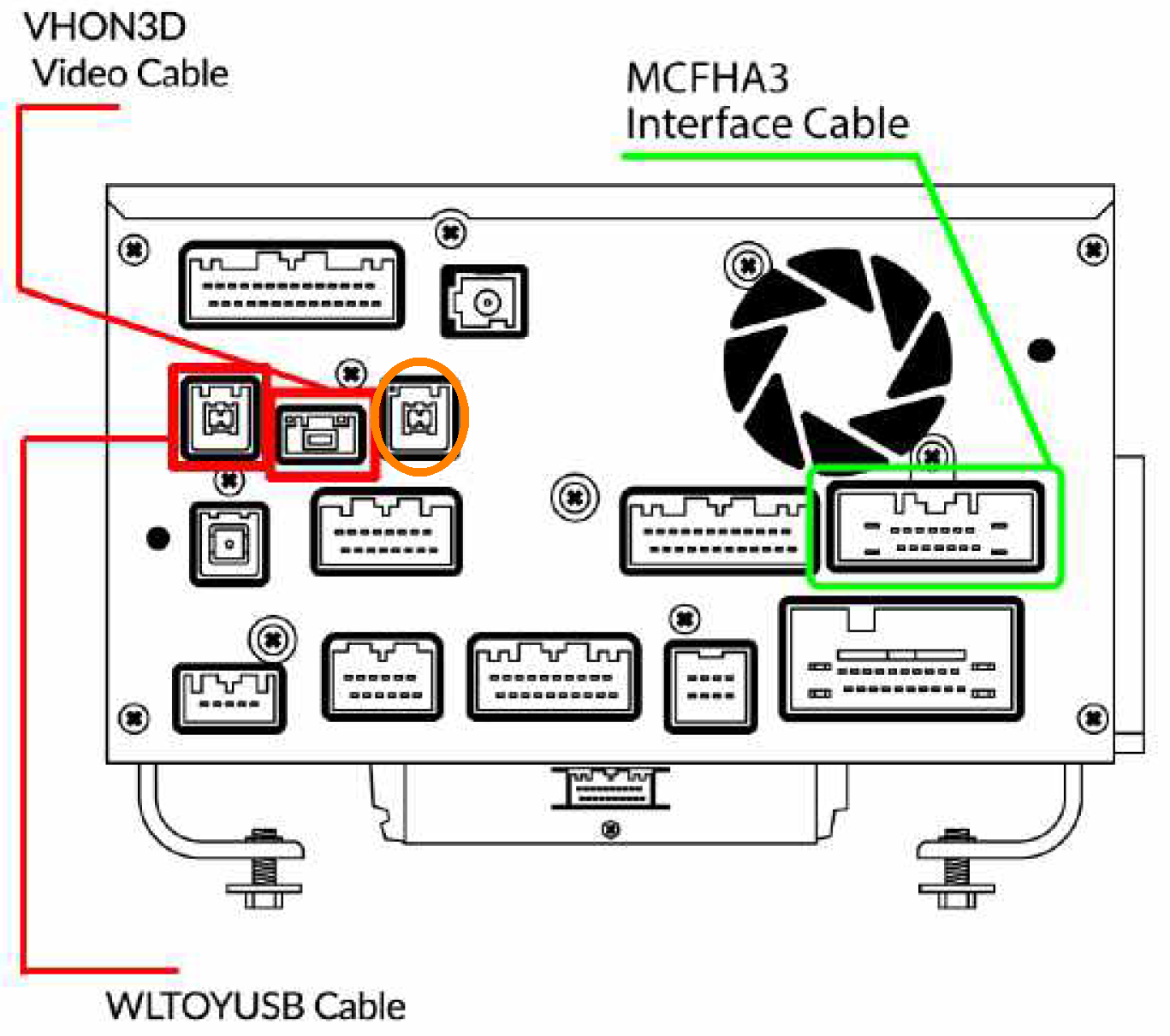

So yeah, after spending my Sunday afternoon and evening meticulously installing Grom, I ended up looking up how to remove the A pillar and realized I actually had to unplug the wire for the emergency lights switch. It is not long enough to pull out the radio unit. But once unplugged, it afforded me only an extra inch at best. The factory harness is super short. Until you unplug all the connectors that need to be y-split in, it's difficult with thick hands. I took pictures, but I'll post them later. For now, I have an issue I have to deal with Grom.
After installation and Grom Initialization, screen was able to display factory content: "The navigation system lost power and is acquiring its location from GPS satellites. This usually takes less than 10 minutes. Bla bla bla." I drove outside and waited a little over 5 minutes, and I hear factory beep and the display turns black. Clicking on factory Nav, Phone, Info, etc buttons all produces beeps (indicating I entered that mode), but the screen remains black. The screen has no problem displaying Grom content (after holding down Menu for 3 seconds). Reverse function triggers, but also shows blank screen. Funny thing is that it actually displayed factory content only initially when the radio unit had its power cut and restored. I've even updated the VLine software from V20VL3.29.0.0 to V20VL3.33.0.0, and still same behavior.
If I can't even see my factory content when I exit out of Grom content mode, then I don't think I want to keep this. But seeing how others can, I am assuming this problem can be fixed. Messaged Grom already. Pictures to come.

Sounds like a bad video connection between radio and VL2. I would try re-seating the cable at both ends. Maybe just a loose connection.

Sorry to hear you're having issues with your GROM installation. Definite sounds like a connection issue, either bad cable or poor connection somewhere. I'd double check all the connections are secured. I guess I'm lucky, as I have installed two GROM Vline2 units now (in my Lexus GS 350 and now RLX) and have not experienced any major issues. In fact, my GROM unit in the RLX is working so flawlessly, I'm amazed. I was expecting some issues like a few BSOD and screen flickering like I did on my GS. You're in good hands with GROM, their tech support is very responsive and will send you out a new cable if that's the issue. Be aware that GROM has not fully tested VL2 on our newer 2020 RLX SH, at least that's what they told me when I contacted them. These cars are very rare and they're having trouble finding any volunteers with newer RLX to test when they moved to their new Texas facility. I believe they only tested on 2016 RLX, but the infotainment system are very similiar between the two cars. But I'm a testament that it does work. Only minor glitch I experience so far is sometimes "OK, Google" detection doesn't work. This is a Google issue, nothing to do with GROM. Temporary work around is to uninstall updates for "Google" app, after which "OK, Google" works flawlessly. Google has updated that app several times now, I've been testing it, voice detection is still a hit or miss.

James, thanks for the suggestion. I have already reseated connectors once already. Strange thing is that the video from the radio/nav is passed through successfully when the message was a warning that it needs to resync with GPS for time and location. That video pass-through works every time. I was in the garage and restarted my car 3 or 4 times, because I didn't realize the instruction manual had a initialization step. Then I drove to a first location thinking I had a clear view of the sky, but after 15 minutes, the radio/nav still displayed the warning about needing to get a GPS fix. Drove back home to get a coat, then drove to a farther location with less tall buildings within 100 yards of me. Video pass through was still successful, until the radio/nav successfully got its GPS fix. That's when it beeped twice, and then the video pass-through stopped working.
Based on the symptoms, I don't think it is likely to be a physical connection, but rather possible that the initial warning display from the radio/nav is being sent at a different refresh rate than when it is operating normally, and for some reason my Grom unit couldn't handle it. If it was a physical connection between the radio/nav out to the Grom in-portion of the Y-split, then I shouldn't be seeing the factory warning message clearly to begin with. But that's just my opinion. Or another possible explanation is that the initial warning display from the radio/nav is sent out through one set of wires, and the regular display from the radio/nav is sent out another set of wires, and one of those wires are bent like in your case? I hope not. LOL But I'd be interested to hear your thoughts on the symptoms and remediation attempts I've already tried.

So you didn't do the first initialization step? That's very important step that most people miss. That could explain some of your issues if you skipped that step. I believe you can reflash the firmware to set everything back to factory default, GROM can show you how to do this. I never had to do any of that GPS fix. Mine just worked. Did you disconnect the battery during installation? I did not. Maybe lost of power cause some weird sync issues. Or you could have a bad display cable. We're all guessing. You'll have to contact GROM support to see what's going on.

I did not disconnect the battery. However, I just assumed one of the pins in the MCFHA3 connector supplied the power. However, because my short nails and fat thumb couldn't disconnect the VHON3D connector, I disconnected the adjacent connector (highlighted in dark orange below) to give me more thumb space. Maybe that was the power connector?
Sorry I wasn't clear, as I missed something in my description. After realizing I had missed the initialization step, I performed it. That was the only way I can get the Grom output to show up on my screen. Otherwise, holding down Menu button over 3 seconds result in nothing.
Only after I successfully initialized Grom did I then drive outdoors to get my GPS fix to get rid of the factory message that Grom successfully passed the video from radio/nav to my screen: "The navigation system lost power and is acquiring its location from the GPS satellites. This usually takes less than 10 minutes. Bla bla bla." So I went outdoors for my first attempt to get my GPS time and location. I was able to get the time (RLX LCD clock) updated to correct time and timezone about 3 minutes of parking, but it still wouldn't get a location fix. The message remained for 15 minutes.
Then I went home to get a coat. This is also when I decided to update the Grom software. Firmware was already latest. Rebooted. Also tried resetting it (after new upgrade). Then I drove out to another location to re-attempt to clear the factory message about the factory navigation system needing to get its GPS fix. Only then when it was successful, the factory display stopped being passed through Grom.
Let me see about how I can reflash the Grom, if that is separate from resetting.

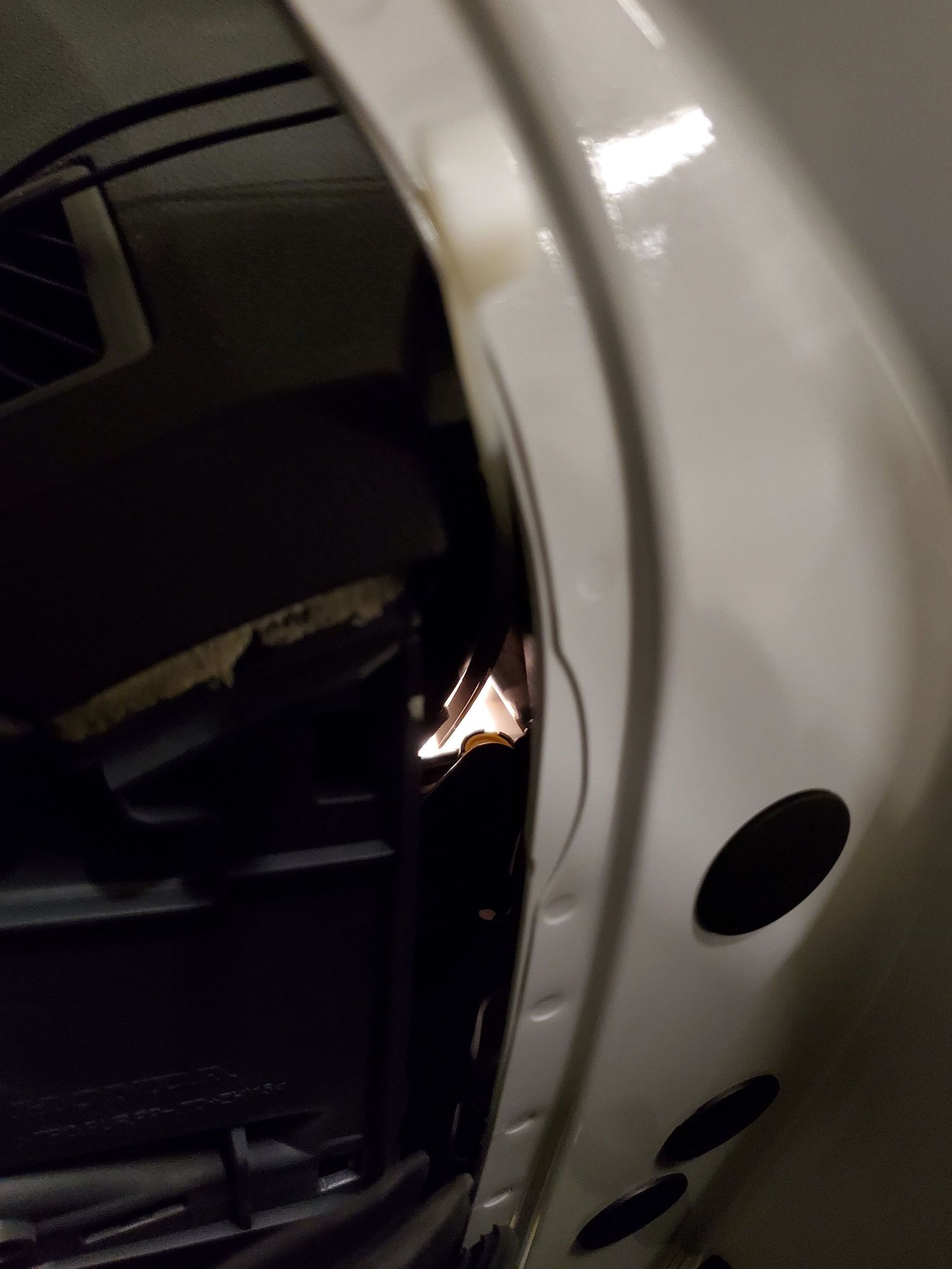

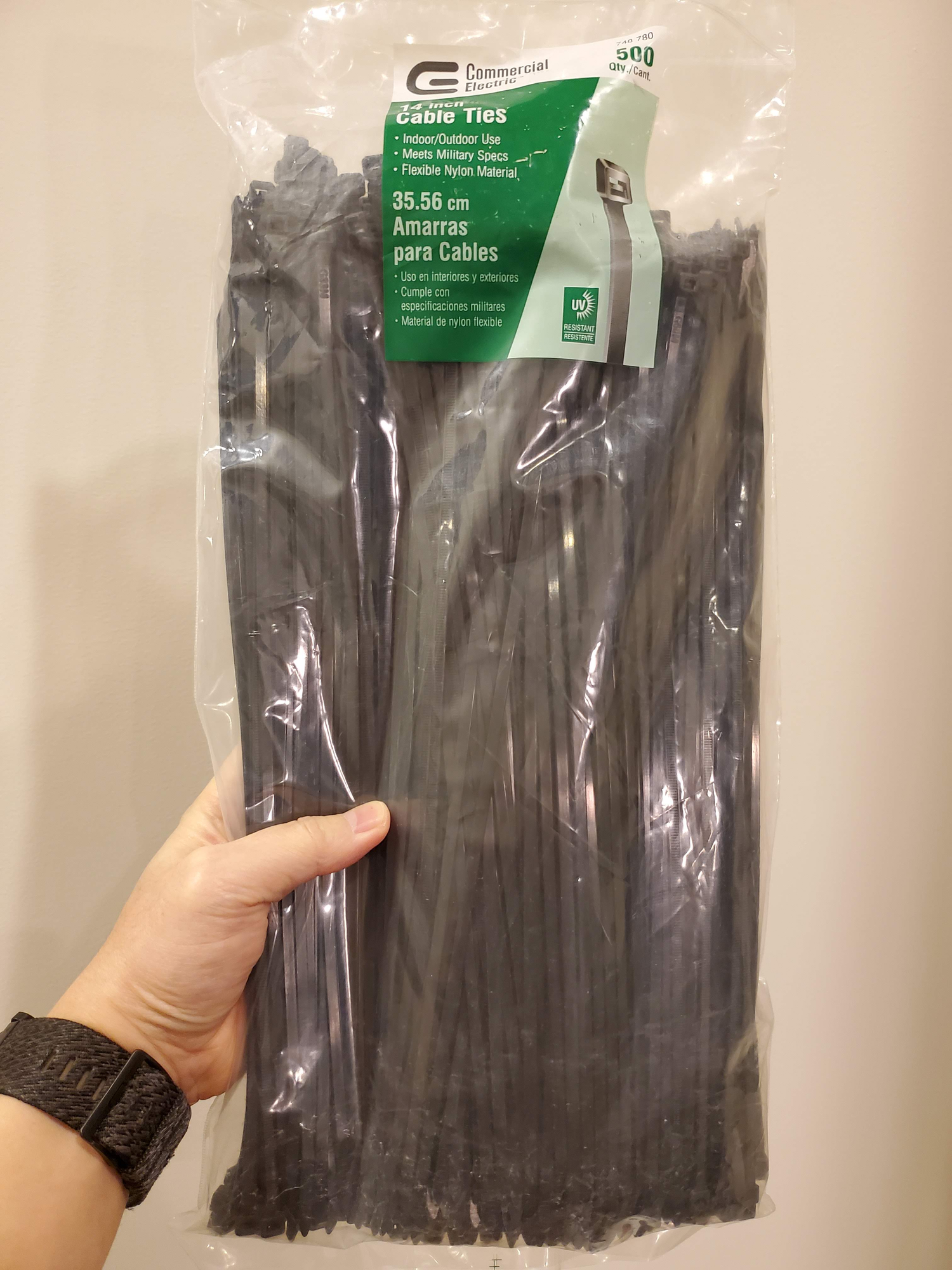

Actually, routing wires wasn't an issue for me. It was other stupid things, and I documented the lessons learned in the other thread. Here is what I did to run wires. By the way, 14" zip ties were barely long enough. I had to get a different type, as well as put two 14" zip ties together to make it work.

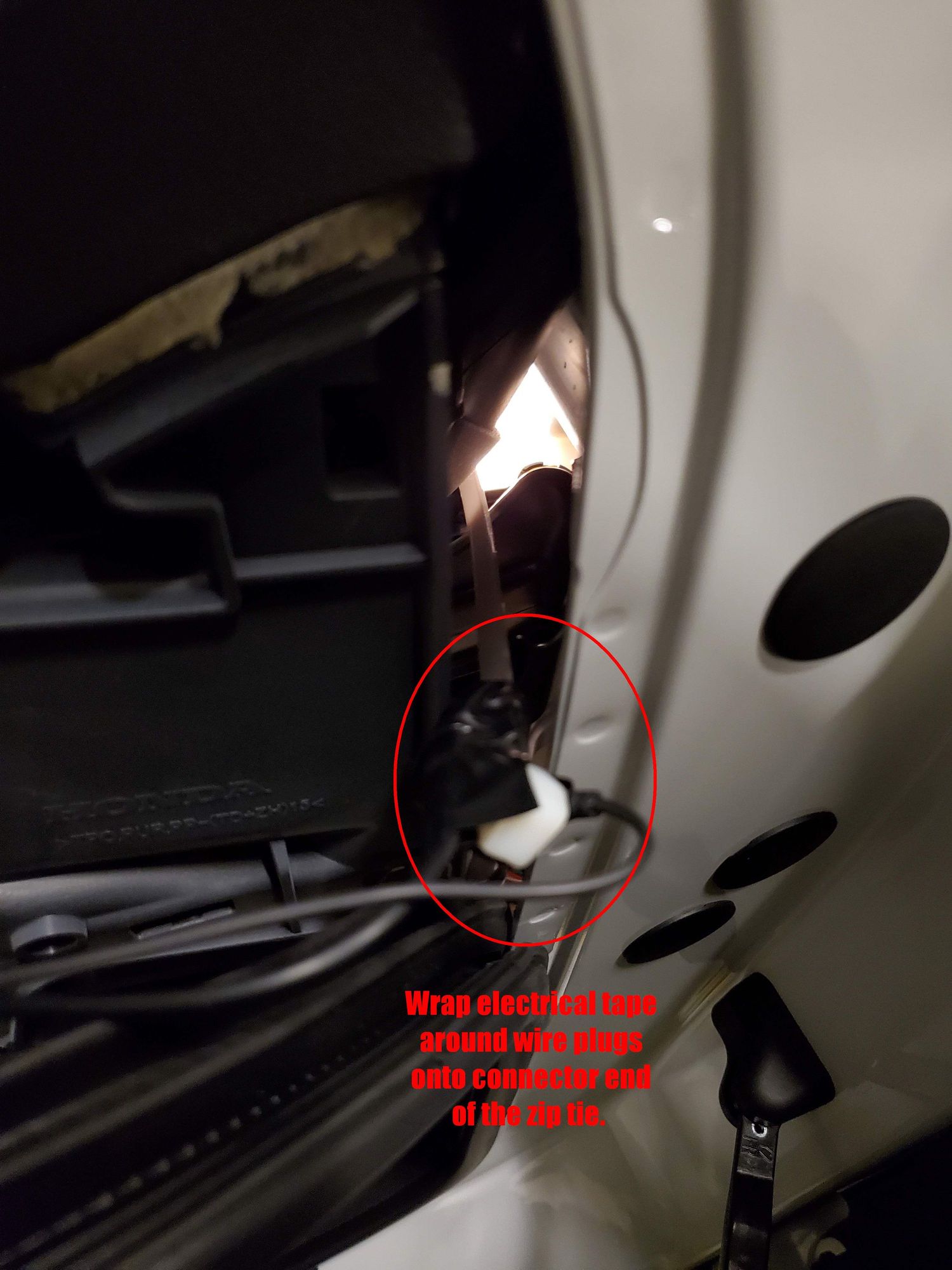

For the base of the A-pillar into the glove box:
Shine a flashlight from the glove box to see your biggest openings are.
Use electrical tape to wrap your plugs into the connector part of the zip tie.
Snake the other end of the zip tie towards the light, and watch from the glove box until the zip tie appears. Gently pull.
When pulling, don't yank harder if you hit a snag. Jiggle wiggle and gently tug. Finally home free.

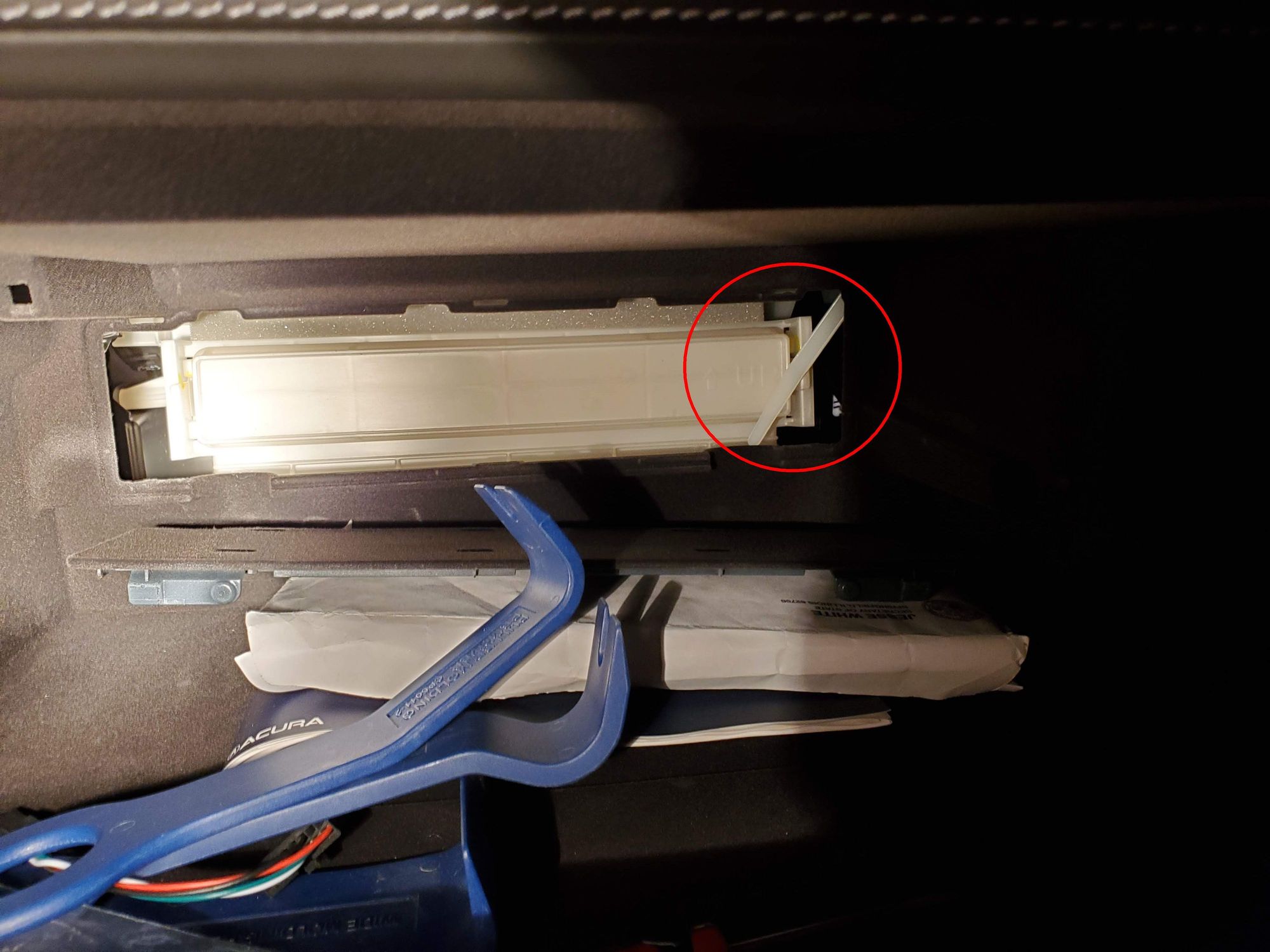

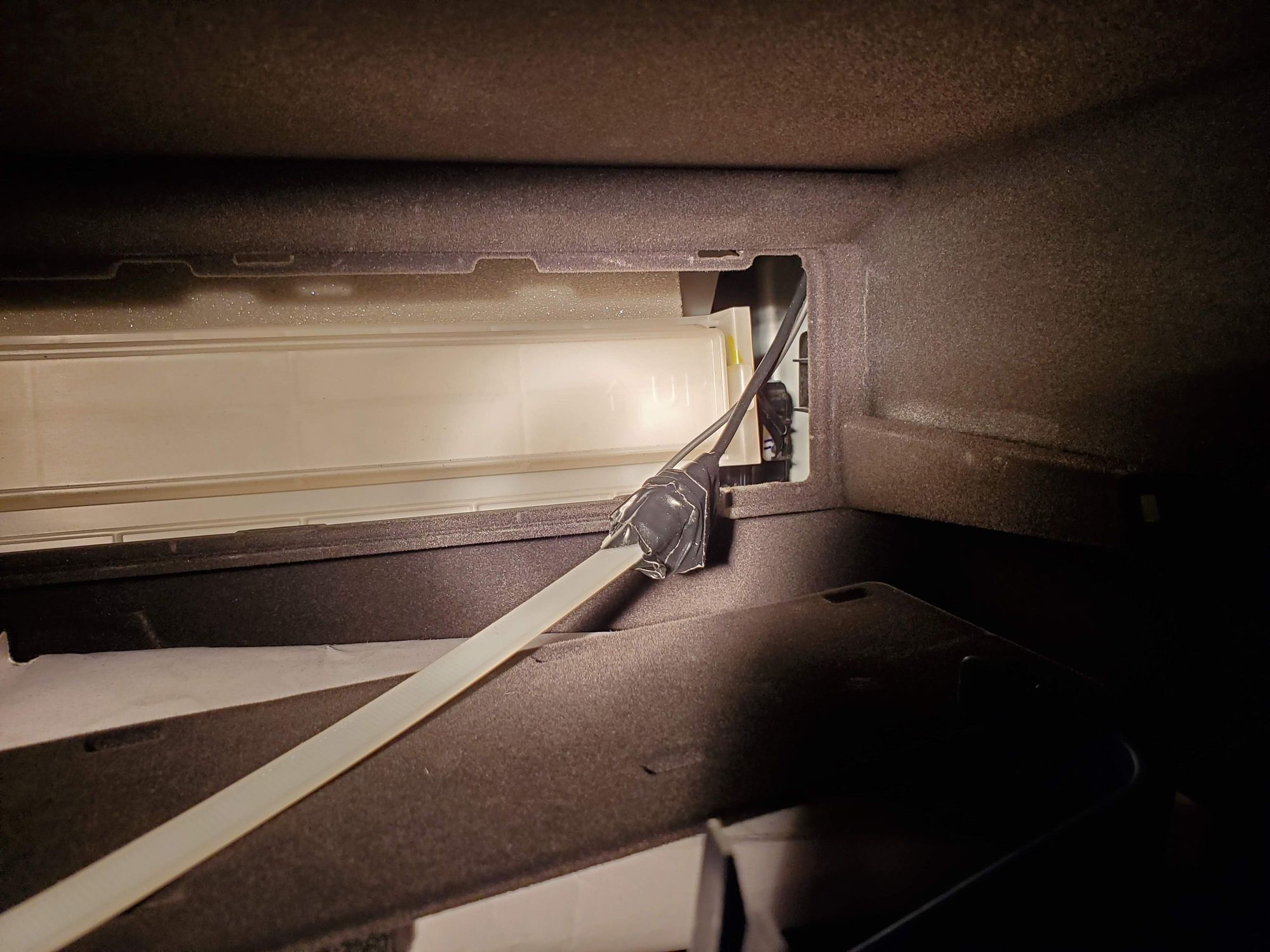

For the center console to the glove box:
Here is where zip ties are awesome. With flash light shining through the opening and looking through other end, you can figure out the general curvature needed. Bend zip tie to approximate curvature and length.
Thread the zip tie through the glove box into center console.
Wrap electrical tape onto the zip tie connector end, ensuring a tight wrap at the neck. This prevents decoupling the zip tie from the wires you want to run.
Wrap electrical tape around the plug of the wires you are running, and taper it down to the zip tie such that it looks like a funnel. This helps with snagging prevention when pulling through tight spaces.
Gently pull. Home free.
Hope this helps you for future projects, or anyone else considering what we're doing. =)

Looks like you're a pro at fishing wires. I didn't have any of those longer zip-ties available at time of install. I mostly used a flexible grabber tool to fish the cables thru and grabbed it on other end with my small hands and fingers. I ran out of electrical tape, had to use painter's tape. What a PITA to remove all the tape afterwards. Now that the GROM VL2 unit is installed, I'd never want to remove it. Thankfully, my unit is working flawlessly no need to open dash back up. I would probably include the GROM unit if I ever sell this car.

Thanks for the compliment, although I doubt I'm a pro at fishing wires. I'm sure those Crutchfield and Best Buy technicians can run circles around me with one hand and blindfolded. =P

My Grom saga continues. Took out the radio head unit again, and the video cable is firmly locked in place. Unplugged it and reseated. Same result. Then I unplugged the 12V battery. This time, the Grom refused to pass the warning message to the display. I know it is displaying that warning message about lost power because the LCD clock went to 19:00, and pressing any of the mode buttons did not result in a beep. I've sent all pictures and videos to Grom support. Bad video cable? Bad HDMI connector on the VLine module? Bad VLine module? I guess we'll have to see what Grom says.

Thanks. Truth be told, my tenacity is quickly running out. Grom tech support may be responsive, but their responses leave lots to be desired. I don't fault them though, because I assume most customers need assistance on the most basic stuff, and I'd like to think I am somewhat skilled and covered all my bases. Just a sampling of responses I got after Google sharing my pictures and videos to Grom when they asked me to recheck the video connector because they suspected the video cable was "knocked loose":
  • "Did you tag the reverse wire during the install?" [2 of the pictures I sent clearly show the positap, and I have demonstrated the reverse triggering on at least 2 videos, as the display flickers and changes to a different black.]
  • "if the factory screen is not working and the Vline interface is, it's always a connector as the factory screen passes through the Vline." [But did not offer to send me a new video cable, unless he meant the video port on my radio/nav unit.]
Kinda reminds me of the silly back and forth Ira had to go through with their technical support regarding "your car doesn't have cameras."
I am close to calling it quits and returning the thing. Either I go with NavTool, or I just use Android Auto on my phone while mounted on the windshield. My reason for choosing Grom over NavTool is because NavTool's main harness has several RCA plugs for aftermarket cameras. Our RLX doesn't need that, but NavTool makes that harness universal, so they are included. That means more space needed, and more chance of rattling inside the dash. (Have I mentioned I hate rattles?)

I asked about reflash yesterday, and whoever replied didn't answer me nor acknowledge the question. They did mention a reset is not necessary. I'd like for them to send me replacement wires and/or unit before I go the RMA route, because then I'd have to pay for return shipping, and I only have 30 days. Silly me for ordering the device before taking delivery of the RLX. That's a week eaten out of the 30 days.
As for whether I am 100% sure my connections are good... It's only the video connection. And... What else can I possibly check to ensure the connection is good besides verifying that the plug is already inserted all the way in and clicked and locked, and on top of that unplugging and replugging in? I am not going to the extend of taking out Grom's Y-video cable and testing the custom molex pins like what James did. I mean, I can, but I don't want to. Where does that leave me? Asking for another cable? What if the custom molex plug side isn't the problem, but the DP plug itself? Or what if the VLine module itself is bad where the DP connector is not properly soldered onto the board? I mean, they sent James a module without the microphone connector soldered onto the board. They provided bad cables claiming it was bent. Those alone scream quality assurance problems to me. I don't want to give them a bad review just yet, but I'd also like to see meaningful troubleshooting with progress. All of the questions they asked were already answered in all the videos and pictures I sent them previously. I feel like they're just asking me canned questions without even reviewing the pictures and videos I sent.
And last evening when I was rechecking the video cable connection and reseating it, I did test it without putting the vents and controller panel back on.
