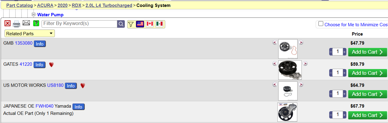

To give you an idea of parts cost the selection below is what rockauto offers in lieu of of OEM.
Example of OEM cost from an Acura parts online vendor. The red is the online price before shipping/handling/taxes. The other price shown is an example of dealer msrp.
The net would be his labor charge plus taxes / shop supplies, depending on what actual component he chooses & installs.

I haven't changed a water pump on the newer K series (K20C / K24W) but on the older K motors it's super easy. Just pop off the belt & tensioner and drain the coolant. Aisin water pump from Rock Auto is like $60 or $70. Doesn't take more than a couple hours.
If it's just as easy on the newer K series, that price seems high to me. Although I guess with $200/hr shop labor that's about right.
Edit: "Japanese OE" Yamada part for 3G RDX is $68 on rockauto
