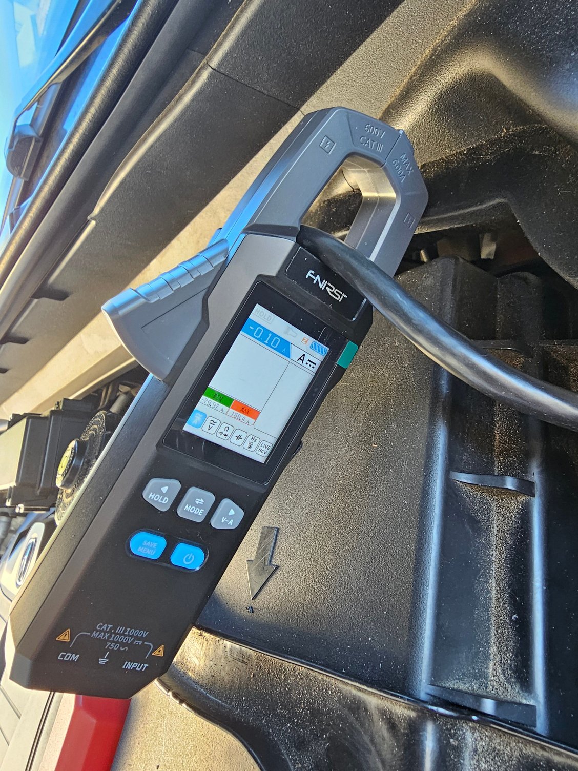

**My testing:**
- Consistent draw of **3.6–3.8 amps**
- Verified with both a DC amp clamp and a multimeter in series
- Pulling **Fuse #37 (Audio, 15A)** drops the draw to **1.8 amps**
- Next step: disconnecting the trunk amplifier power harness to see if it drops further

Quick update on my parasitic drain testing:
I didn’t end up pulling the 40A fuse (#17 in the engine bay) for the trunk amp. Instead, I disconnected the amp’s power harness directly, and that brought the draw down further to about 0.80A.

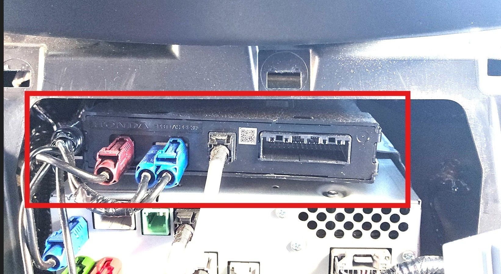

Update on my parasitic drain diagnosis for anyone familiar with the TCU (Telematics Control Unit) on the RDX. I might need some tips for those who have done a replacement.
I put all the audio fuses back in and reconnected the trunk amp, then unplugged the TCU harness to see what would happen. The car starts fine and the infotainment system still works—HD Radio, XM, Android Auto, and Nav are all functional. The only thing missing is hands‑free calling; Bluetooth connects, but the other party can’t hear me. Acuralink also shows no subscription info, and the app has been giving me “remote command failed,” which I hadn’t paid much attention to before.
Most important part: with the TCU unplugged, the parasitic draw dropped to 0.10A, which is a massive improvement.
I’m considering picking up a used TCU to confirm the diagnosis without spending too much. For now I can live without it, but it does mean no phone calls while driving.

Update: Resolved the parasitic drain after replacement of the Telematics Control Unit (TCU). I had purchased and installed a used unit from eBay that was pulled from a donor 2020 Acura RDX. I have referenced this article https://static.nhtsa.gov/odi/tsbs/20...04242-0002.pdf and confirmed I have the latest or slightly newer software versions -- until the last section where it stated that I have to go back to a dealership to reprogram the replacement TCU to the Keyless Access (Immobilizer) system via HDS tool.
It does makes sense as I noticed that even if I was able to resolve by parasitic drain I am failing to remote start my vehicle and perform locate. I am however, seeing the status of my vehicle, lock and unlock doors, lights, and honk are all working.
