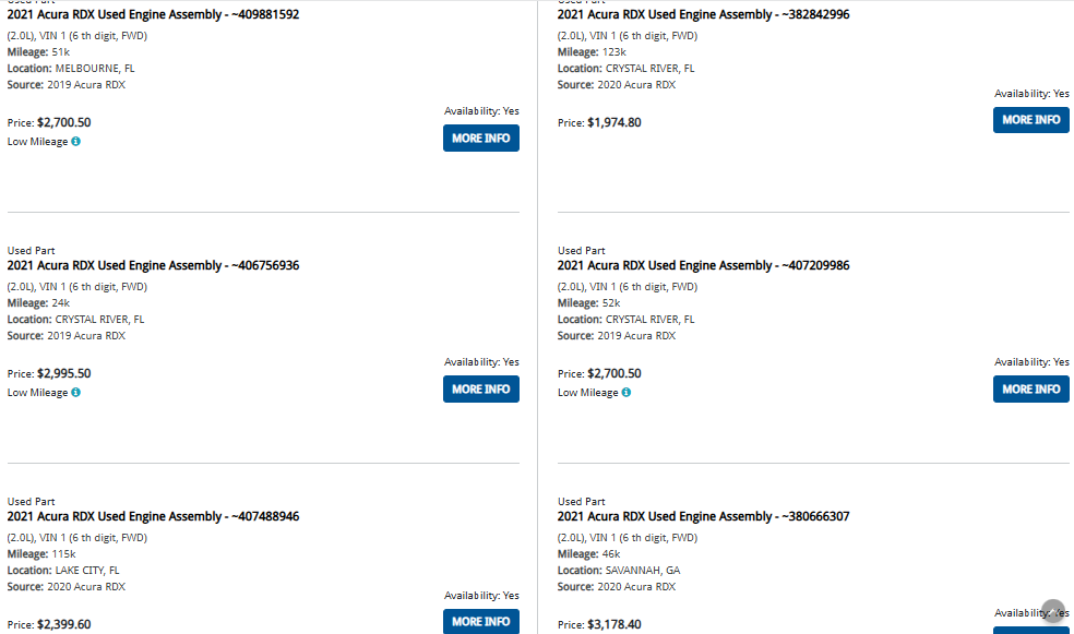

Originally Posted by Bobbo_6812
2021 RDX, 127k miles. Dealer just quoted me 9800 to fix this problem! Seems like a disgusting money grab to me, anybody have any insight here?
If that is for an OEM rebuild of your current motor, than that is how the stealership operates.
If you look at the various mileage offerings on LKQonline.com below for a salvage engine, perhaps.
However, you don't mention if your location is in a major urban area or BFE, which can factor into the overall quote to source an engine.
If you can find an independent Acura / Honda specialty shop, in your area, repair price could be significantly lower?
