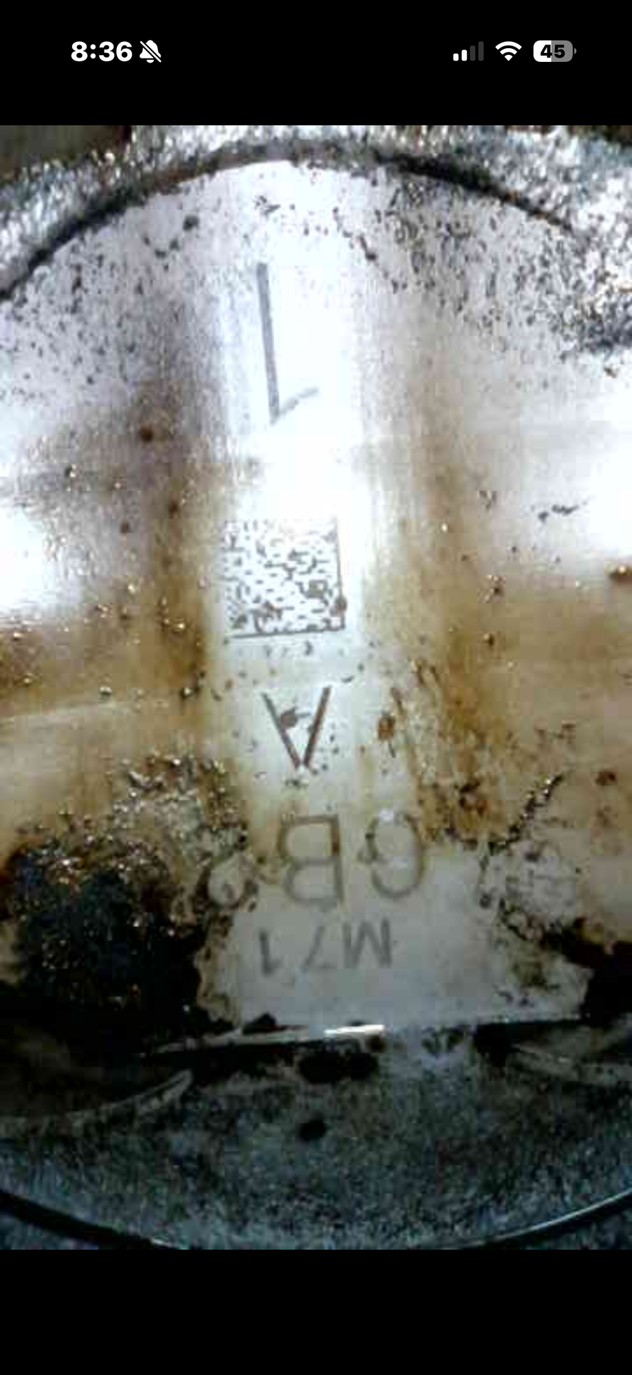

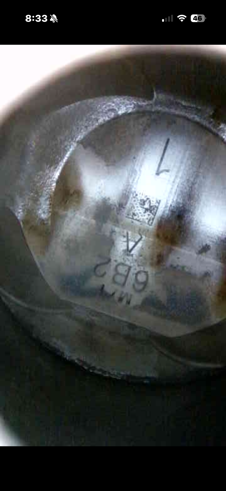

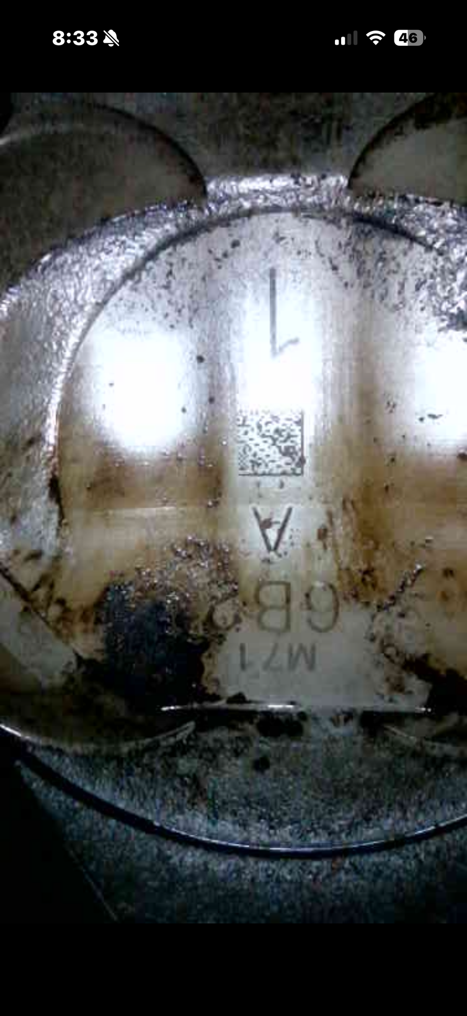

today I decided to scope the cylinders with a camera, here are the photos. First pic is cylinder one for comparison, second and third pic is cylinder 2.
Can anyone help me diagnose something from the photos? I notice more sediment in cylinder 2, perhaps fuel injector is failing?

Did you change the spark plugs 8,000 miles ago as routine maintenance, or did the problem already exist, and you changed the plugs in an attempt to eliminate the issue?.
Assuming there was no misfire after changing the plugs, how long after the change did the problem begin? If shortly after the change it may be a manufacturing defect in the plug.
Your next step would be to swap the coils between cylinder #1 and #2, which will only take 2 minutes. Check if the misfire moves to cylinder #1 or remains on cylinder #2.
Perform the same swap between the two spark plugs.
I'm not sure how difficult it would be to swap injectors, but that would be the next step.
You may see signs of injector problems by checking the fuel trim values.

My own 2020 has 80,700 miles, and I get a zero misfire count on every cylinder. I still have the original plugs.
This is the second time you have noticed problems with cylinder #2. How high is the misfire count? Are the other cylinders all showing zero counts like my own, or are they just showing lower counts than cylinder #2.
It seems like you ruled out plugs and coils by performing the swaps. So that would leave the injector swap as the next test.
Modern gasoline has detergent additives included, so any cleaner you may have added, is unlikely to have dislodged anything.
Your fuel trim at - 3.6 is acceptable, and I wouldn't even look into it if it wasn't for the misfire. If anything, it does indicates the engine is detecting a slightly rich mixture. That could be caused by a leaky injector, or even a dirty air filter (which should affect all cylinders) .
Is the fuel trim better or worse at higher RPMs? How about the misfires?
I believe in the rule, "if something stops working, check the last thing you touched". Since the misfire started after adding the additive, I would wait until your tank is nearly empty before refilling with good gas, and then reevaluating the problem.

Would a coolant leak cause a misfire like this?
I have no idea what the pistons on our engines should look like at 100,000 miles but those look awfully clean. Almost like they were steam cleaned or something.

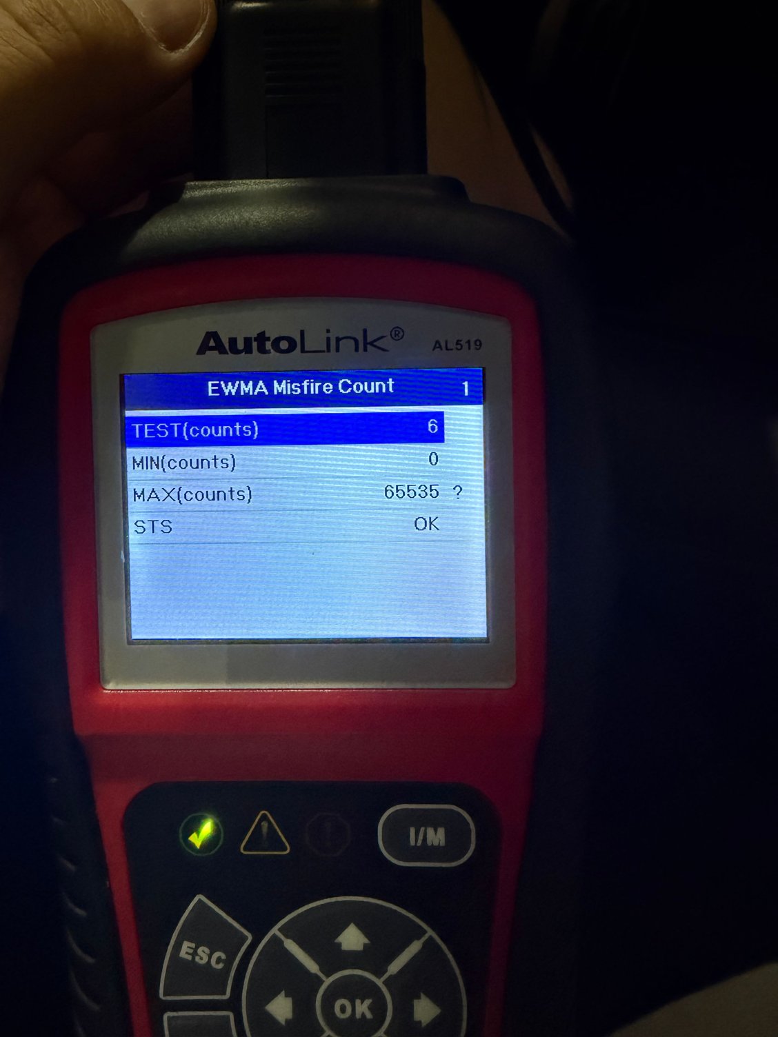

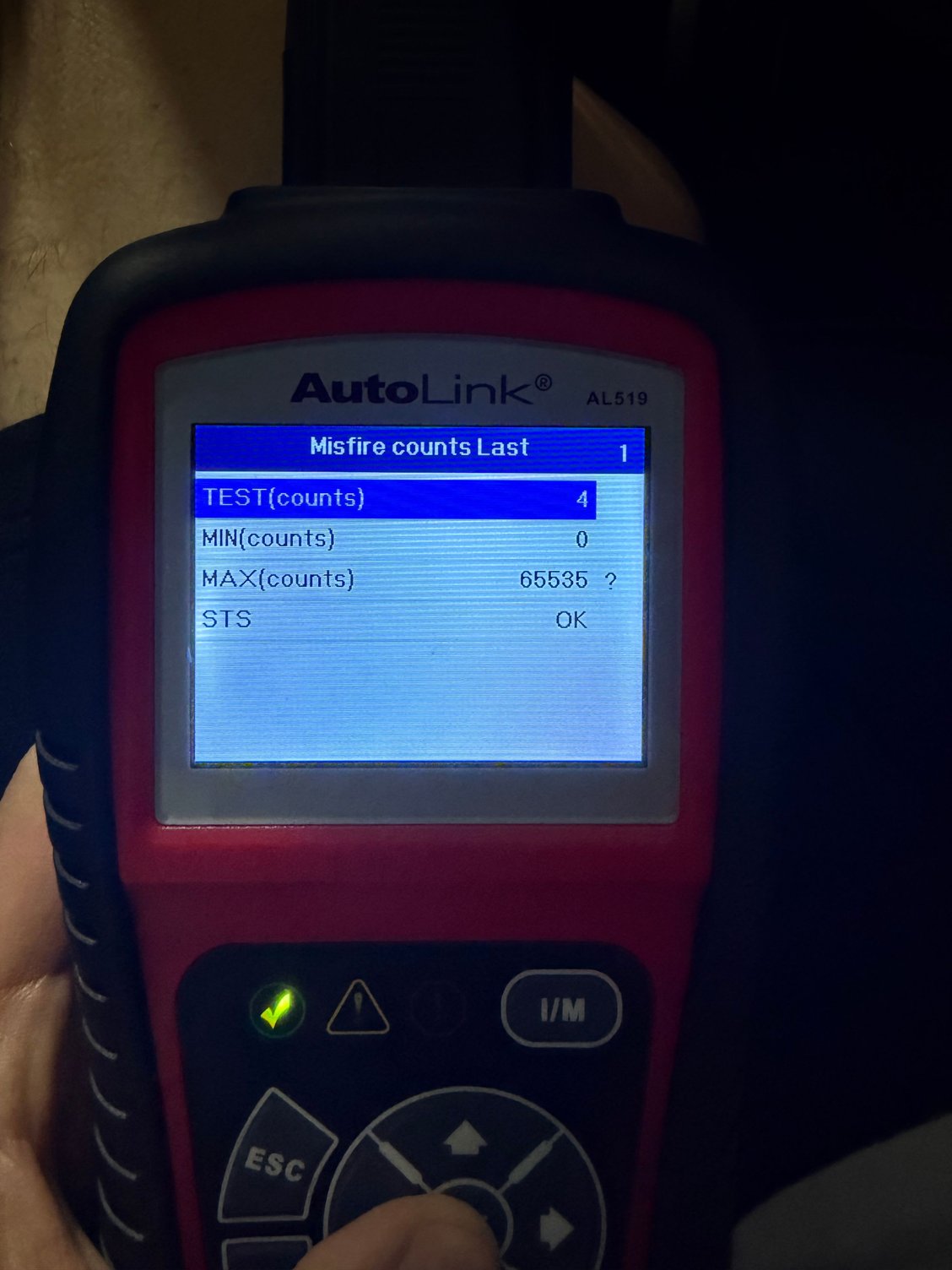

here I what I mean. This photo is from cylinder two, all other cylinders have zero test and zero MIN counts. This was after resetting ecu and going around the block which triggered hesitation again.

Good point, that was also my first thought after I looked at my first pic which is cylinder 1. However there is no abnormal data coming from cylinder 1, I figure if it was leaking coolant there would be some misfire data in that cylinder.

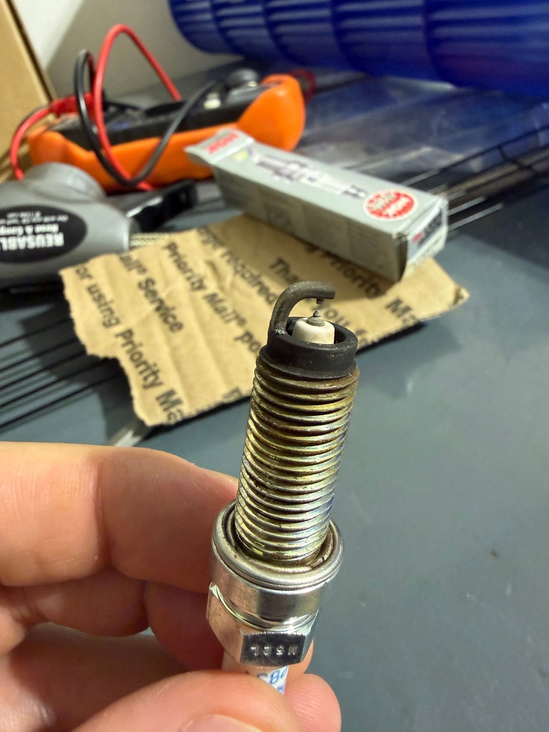

Here is a pic of my cylinder 1 plug, does not appear to be whitish like it would be if coolant leaking. Plugs on all cylinders look the same as this pic.

I’ve restart the ECU 3 times since this has started, each time the data from the OBD increases only for cylinder 2.
