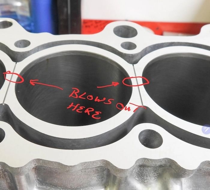

Here ya go:

So the head gasket material is faulty, or there is something else?
Old Aug 23, 2025 | 06:58 PM
attofarad's Avatar
Joined: May 2022
Posts: 220
Likes: 65
From: SF Bay Area
Looks to be the block design.

If that is the case, how do they fix it? Just put same replacement head gasket part number and hope for the best? In another 70k have same problem…

I wish there was a clearer picture of what exactly causes the issue since it would help Honda/ Acura in getting a fix out sooner. Although, I'm not sure how costly it would be for them to create a fix
The issue seems to be the design of block and also gasket. The block has a tinny passage for coolant between cylinder walls, this seems to be the weakest point for gaskets to fail. The part number for gasket was updated, but we dont have any official word from Honda if the updated part supposed to remediate the issues.
There is not much you can do to mitigate it. Premium fuel may help as it will reduce the knock which may weaken the gasket. Driving car with less turbo boost to avoid higher temperatures in the block. Using thicker oil has pros and cons, thicker oil will cool slightly less, but if your viscosity drops due to fuel dilution, more friction can make it run hot. I chose thicker oil to combat fuel dilution. Also change coolant every 50k miles or 5 years and also more frequent oil changes

I don’t think it is prevalent but is happening here and there.
Maybe not in some cases, but I am sure excessive turbo boost, abuse does not help either
Old Oct 13, 2025 | 05:12 PM
NBP04TL4ME's Avatar
Stay Out Of the Left Lane
Posts: 9,695
Likes: 1,396
100% agreed. 3.5L V6 > 2.0L Turbo.

How much PSI in the intake manifold do you get on a 3rd gen RDX?
Old Oct 14, 2025 | 12:37 PM
russianDude's Avatar
Joined: Jun 2001
Posts: 6,922
Likes: 848
good question, but generally turbos have higher PSIs and run hotter. If poorly designed, head gasket/block is more vulnerable.
Old Oct 14, 2025 | 01:01 PM
Tomtwtwtw's Avatar
Joined: Feb 2014
Posts: 1,685
Likes: 293
Peak is supposed to be 20.5 psi in stock form, and I usually see around that number whenever I have my monitor hooked up. I'm sure a lot of the quick reflashes are closer to mid-20s, but I haven't played around with that yet on my 3rd gen.
Old Oct 15, 2025 | 12:55 PM
EasyLoveRDX's Avatar
Joined: Dec 2020
Posts: 685
Likes: 172
From: Lowell MA
Interesting. I'd agree with the speculation that boost pressure (and resulting heat) probably has something to do with it.
Even with mods and a tune, I max out at ~18 psi on my first-gen RDX. Stock is I think 13 psi. Less boost with slightly more displacement.
I wonder if an aftermarket intercooler could help the 3rd gen RDX.
