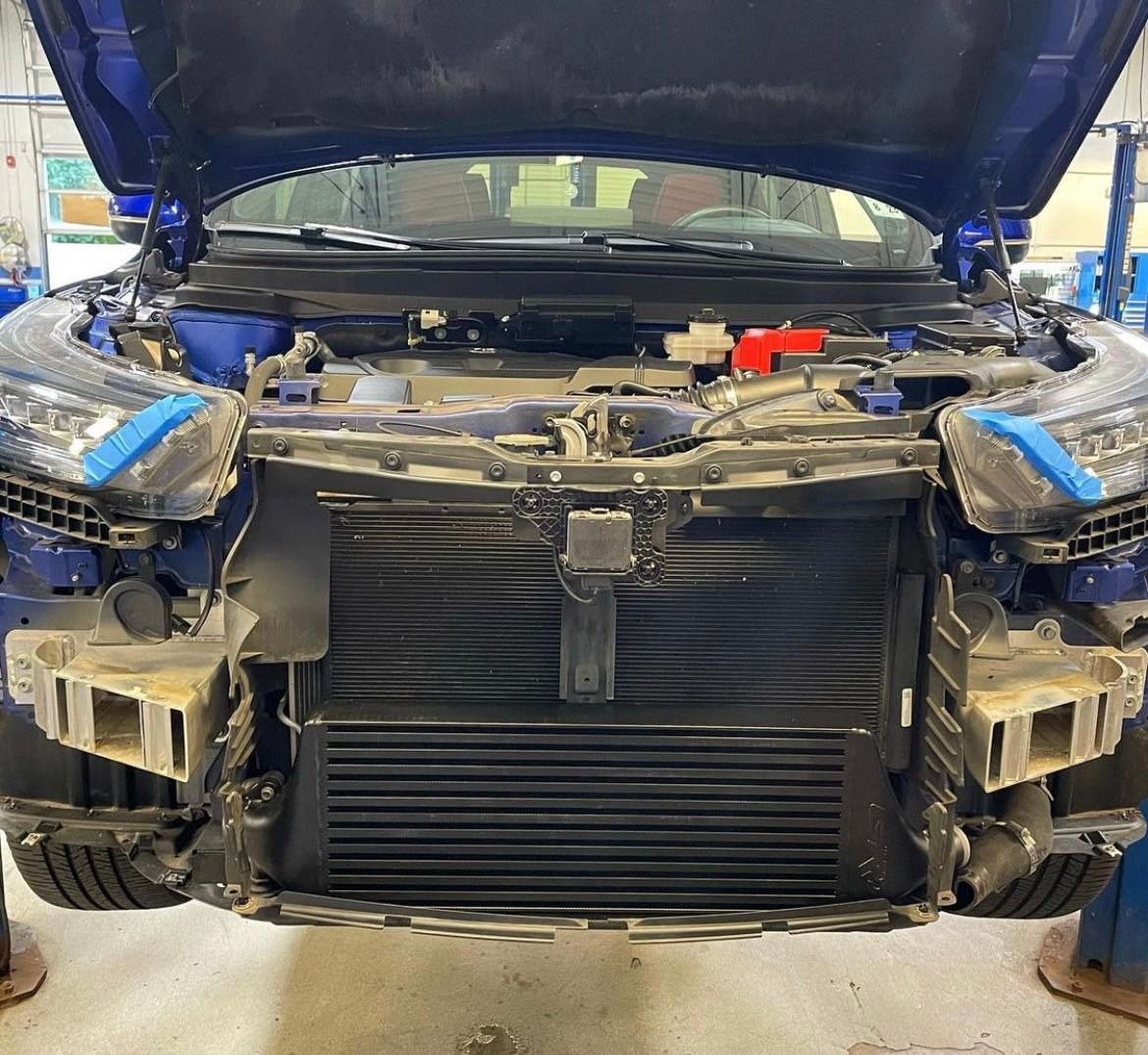

Finally installed the GRP Inter-cooler (black) and the Turbo Kit. Some points i thought i'd mention to help others out.
When installing the GRP inter-cooler make sure you stretch out the one end of the flex hose so it will fit over the GRP pipe. I ended up soaking one end on boiling hot water and stretching it out over the end of a hairdryer. Also as mentioned so much easier to install when removing the crash bar.
When installing the Turbo kit note; you dont use the heat shield and the support mount bolt under the turbo. Also you will need to cut about 1/4" off the two bolts for the titanium air inlet when mounting or just add washers/buy shorter bolts, if not they will bottom out and not allow you to thighten the mount. All in all it took me a total of 9 straight hours to remove and install both the inter-cooler and Turbo, with Zero instructions. I just the odd glance at a youtube video done by "just a Honda Accord" and the support information from Type X and WunderWagen. Also a quick facetime with GRP Tech Zack Leach. But very happy with the results i am still running it with the Phearable Stage 3 Tune but hopefully will get it on the dyno next week and see if anymore tweaks can be done.

So the intercooler fits in front of the crush bar?
nope-it’s behind it

Any modification to the crash bar required?
no you unbolt crash bar, install intercooler and reinstall the bar
