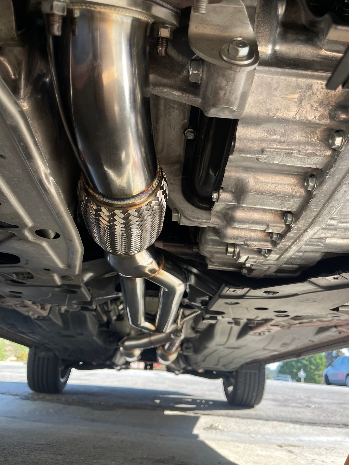

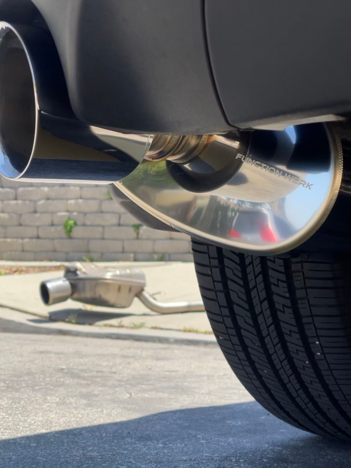

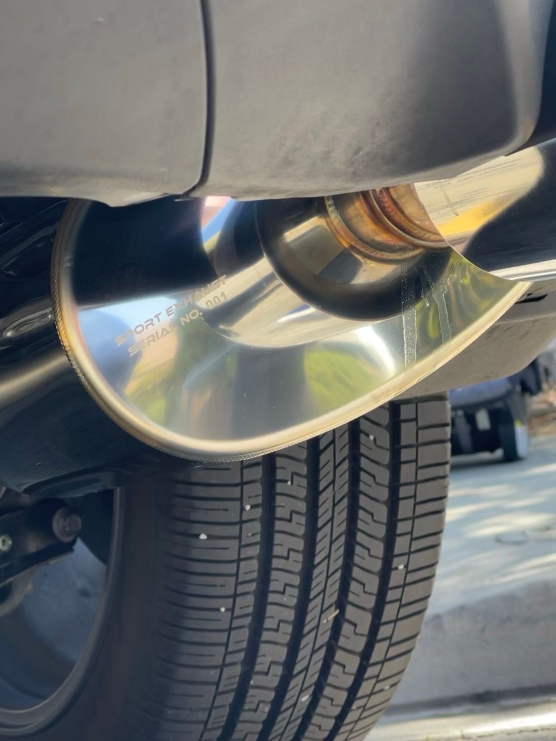

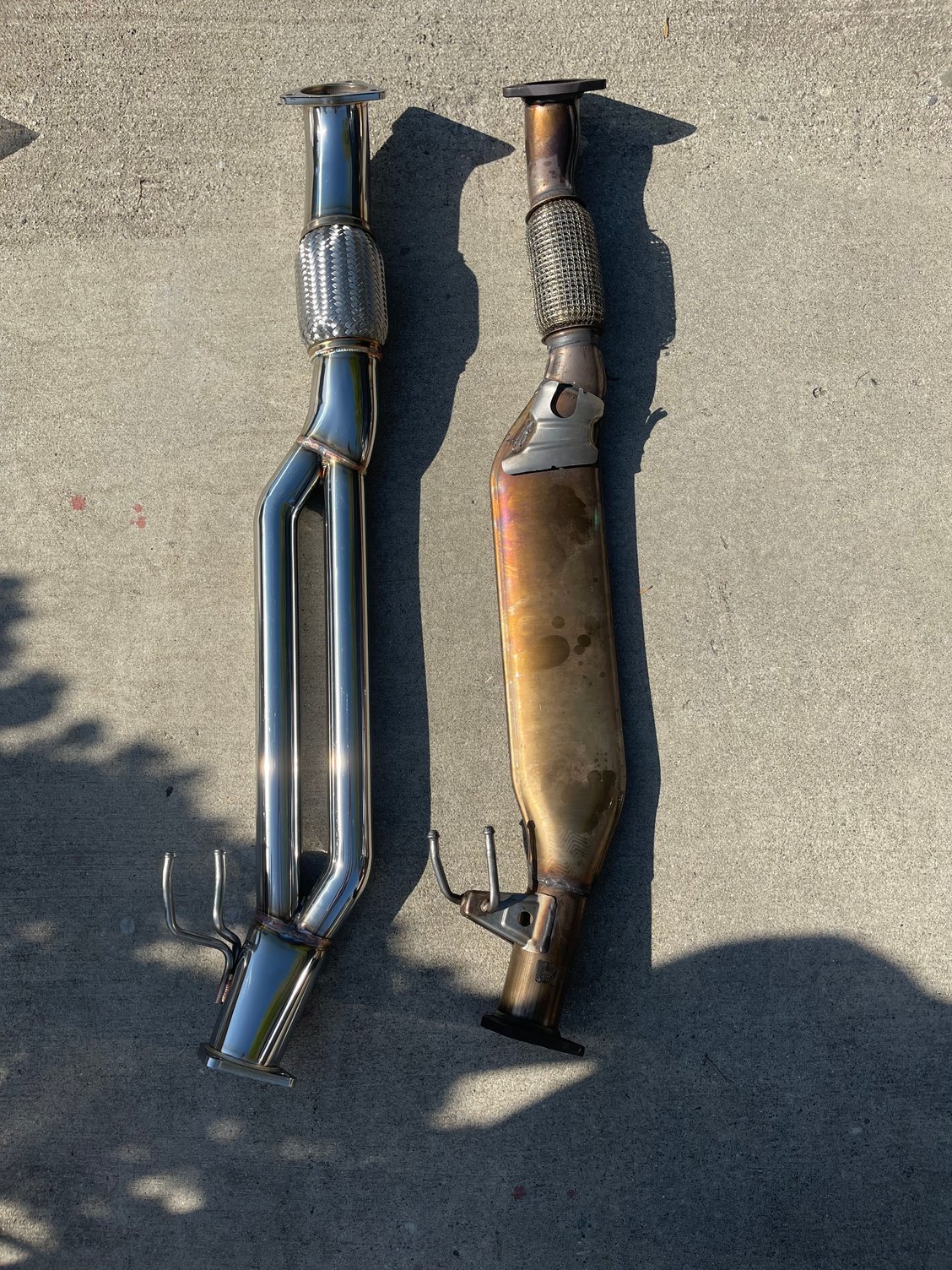

Functionwerk Front pipe + Exhaust
Hello everyone,
Functionwerk recently released their front pipe and full exhaust for the RDX. Anyone who is interested let them know i sent you. IG: Subzero_cv2
Right away noticeable differences were
- Better exhaust flow
- Increased off the line performance
- Super more responsive throttle
- No choke out feeling on top end
Here’s a clip from 0-60

Does this delete the cats?

No, the cat is built into the downpipe which bolts to the turbo and precedes this pipe in the exhaust. This just replaces the factory flat/pancake "B pipe" with a larger and better flowing 3"->dual 2"->3" pipe. The two smaller pipes are for clearance since the RDX runs this under the subframe where all other modern turbo Honda cars run it over the subframe.

I’d be curious to see what would happen if you cut the function werk pipe and the catback and just make it dual exhaust all the way from the front pipe back rather than it splitting, then joining to one then splitting agin. Or put in an X pipe?

Haha i know right would be dope, the tone to the
Function werk exhaust changed after it broke in recently last month love it can deny how good it sounds.
